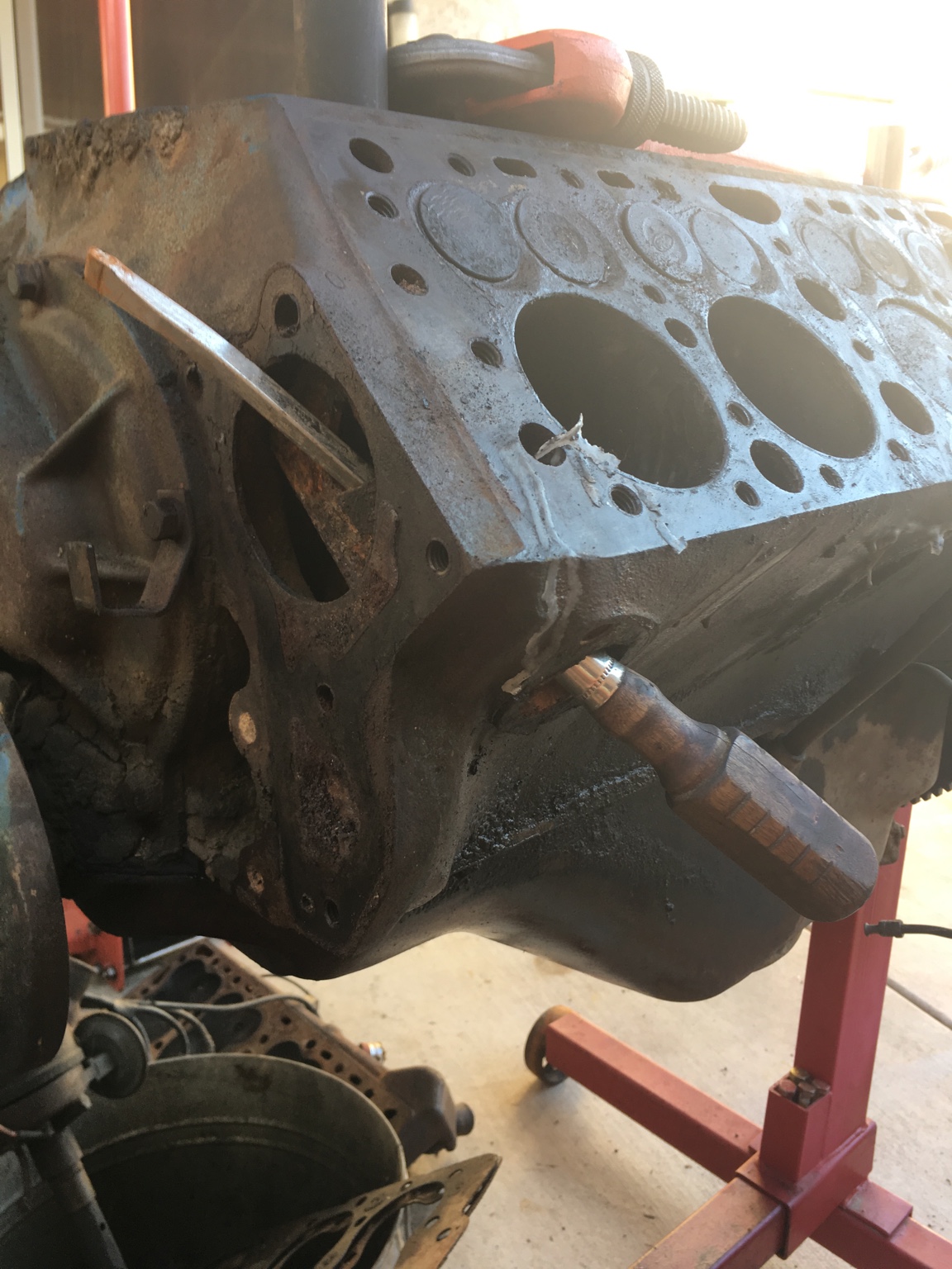

    Stick a screwdriver up into the exhaust port right below it and see if it appears in that little window.

    Here's the answer to the screwdriver test. Cue the price is right loser horn.
