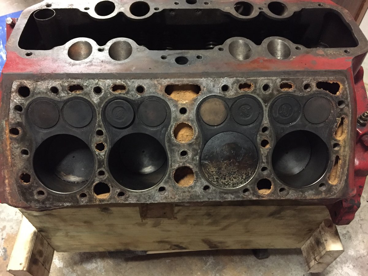

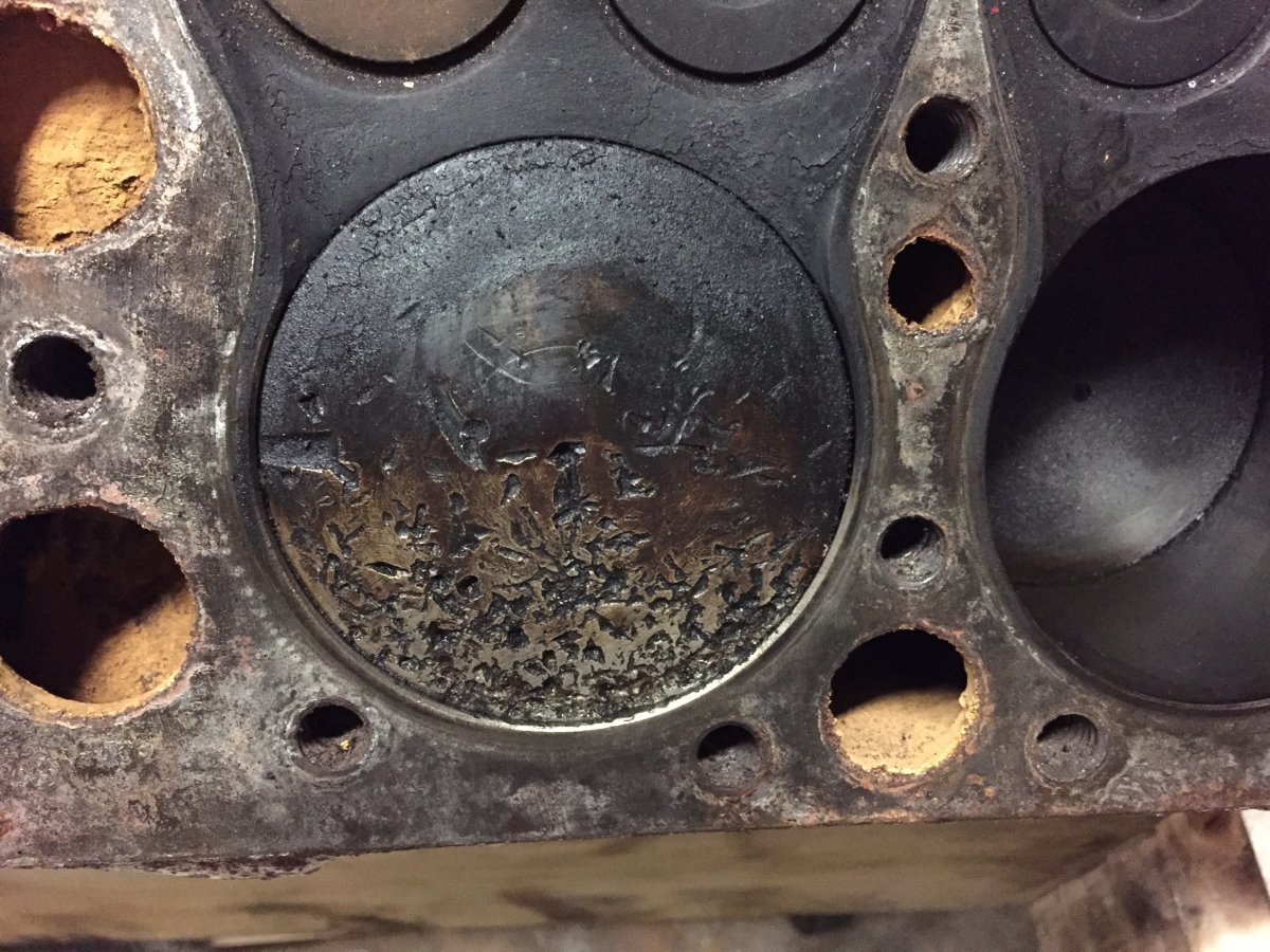

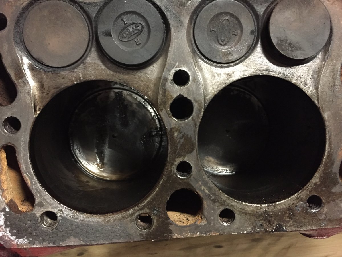

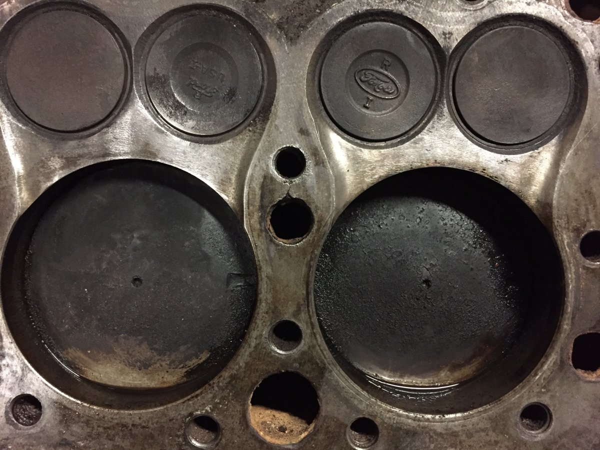

    I recently came across what I hope will turn out to be a good deal on a bunch of Flathead stuff including a complete 8ba motor (alleged to have been running but heads and intake were off) and a spare 8ba short block that is locked up. A quick visual on the “running” engine shows a pretty clean lifter valley area, adjustable lifters, and smooth rotation. Seller claimed it was recently rebuilt (the heads and intake were freshly machined). There is, however, one badly pitted piston with associated scoring on that cylinder wall. What causes this type of damage? Doesn’t seem like corosion to me but what do I know? Curious if anyone can help diagnose the cause.
    I measure the cylinder bores to be about 3.243”, which I think means that the block has been already bored .06 over. How much more can these blocks handle? Any help would be greatly appreciated as always.

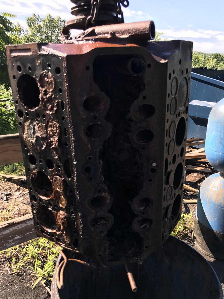

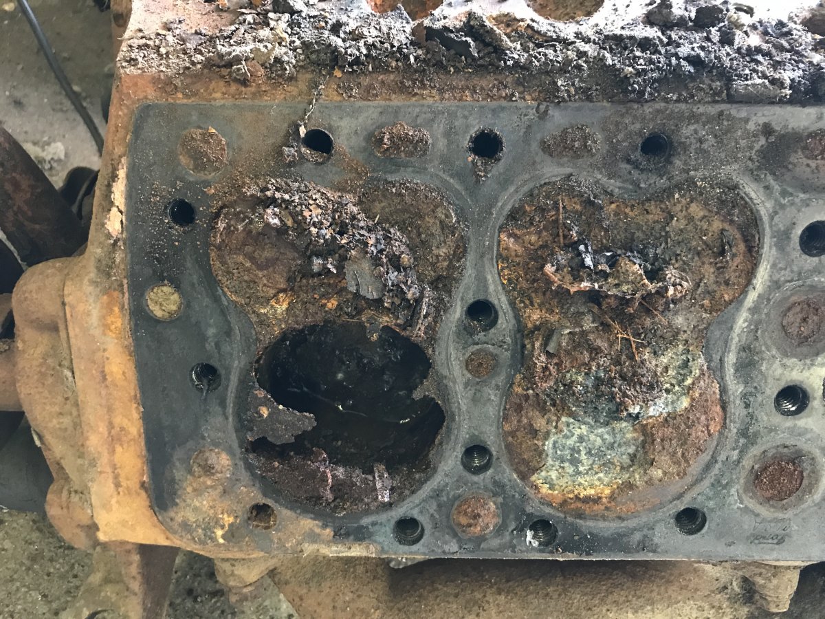

    I believe they can be bored to .090 over. They walls will be pretty thin at that point. The worst case would be to sleeve the bad cyclinder. How long ago was the motor work performed? Adjustable lifters and clean valley make one believe it’s been apart and work performed.
    The pict looks like a valvetrain or spring or something came apart in cylinder. Rest of block looks okay. Machine work wouldn’t be Terrible If rest of block checks out okay.

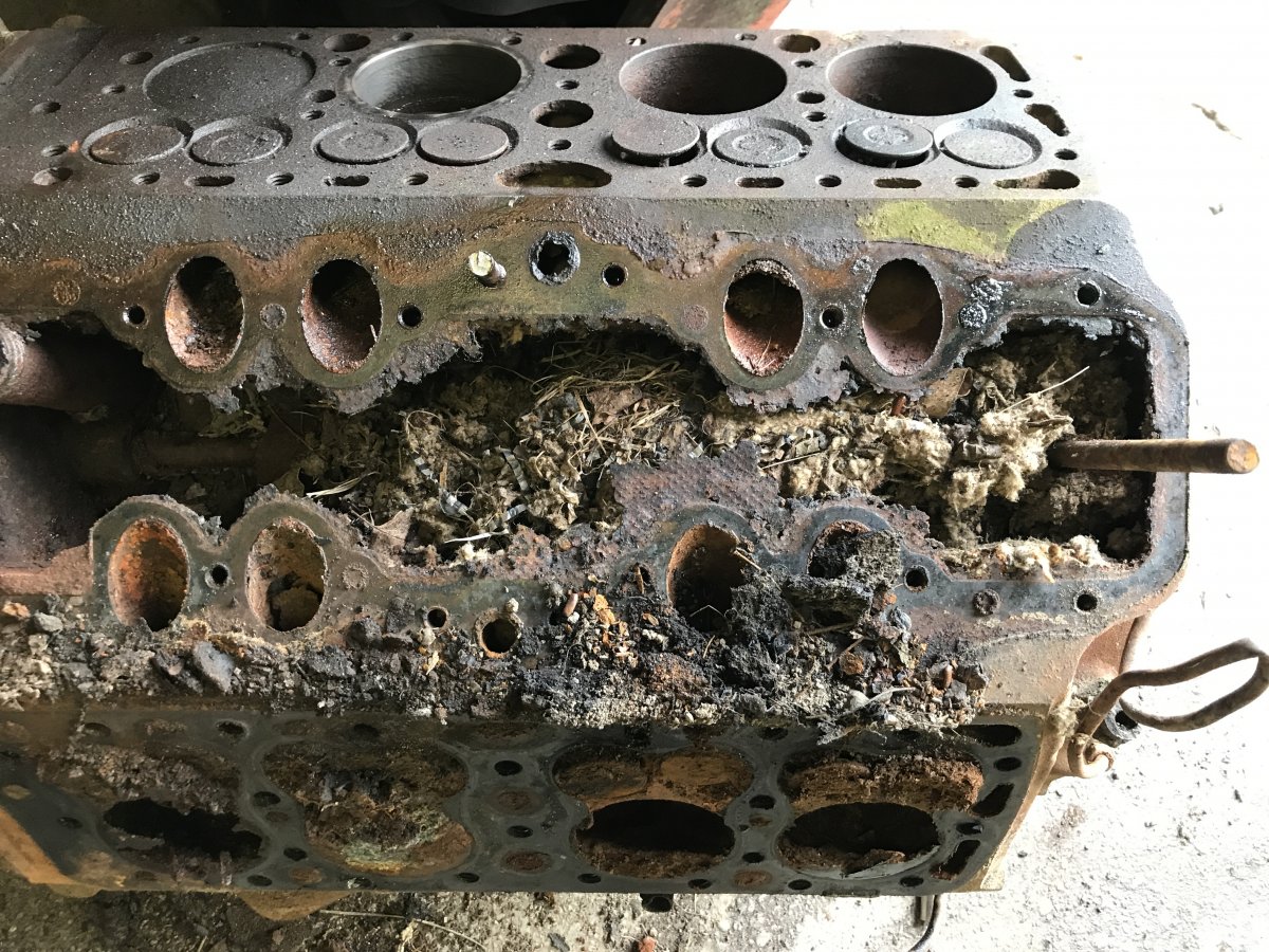

    By the way, I’ve had worse lol
    0543C32A-0E8B-4DCA-A503-E4244EA00D06.jpeg D0FE2B0D-83DB-4D61-933D-1B1C432236E9.jpeg CBCBFD40-D66A-4091-ADB5-F349144DF12E.jpeg 4050FFEE-72DB-4671-8734-A8C12FD187B2.jpeg

  4. Atwater Mike
    Joined: May 31, 2002
    Posts: 8,068
    Atwater Mike

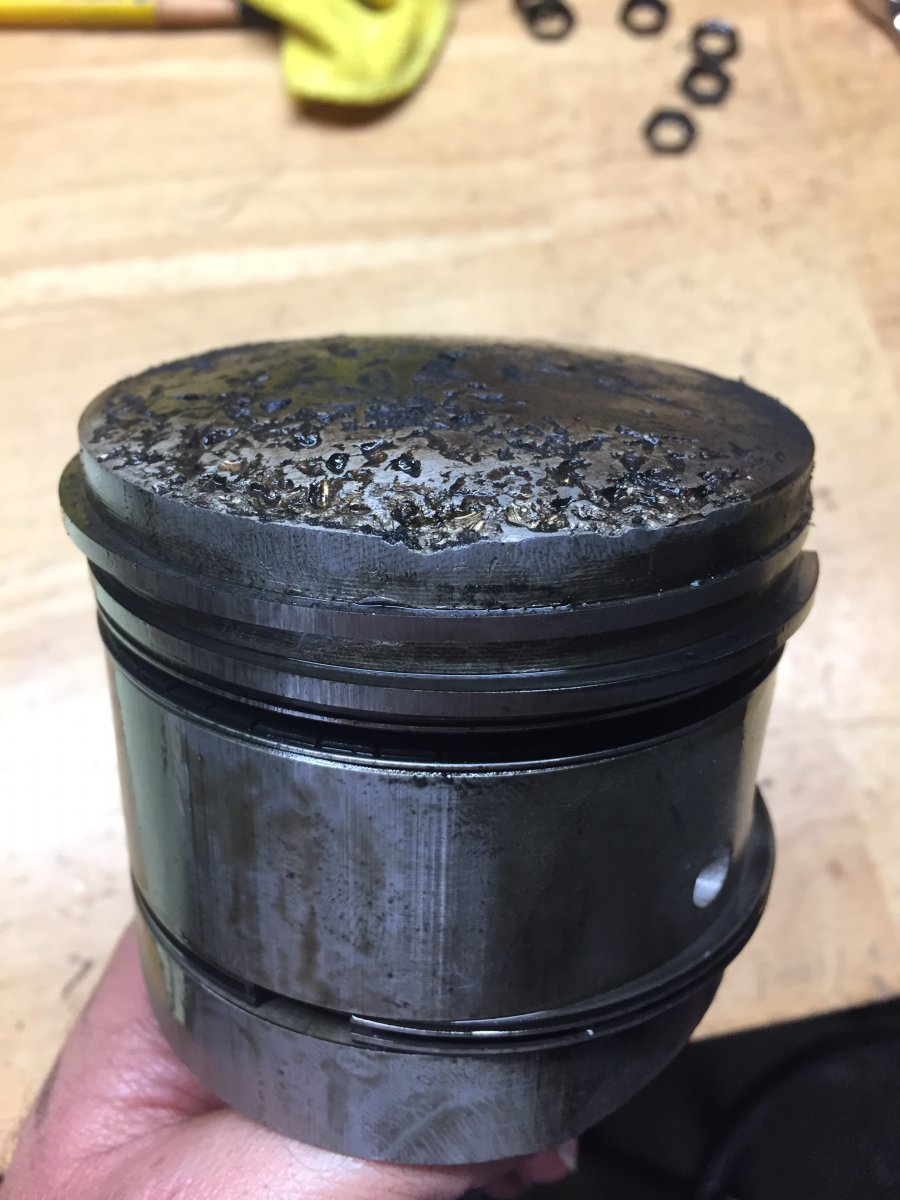

    Looks more like a broken ring and upper land...Smartest fix may be to replace that piston (dependent on the other 7) and sleeve that cylinder.
    Other variables will be pertinent.

    My seller didn’t know how long ago the work had been done, since he didn’t have it done. But it has been sitting for a year or so. We’ll see how the rest looks when I can get into it more.

    Vanness, early cobra engine?

    Now that’s good stuff...until I met his family... that will make you jump.

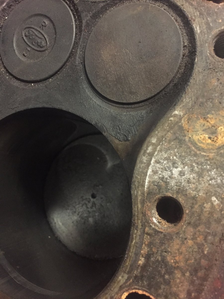

    Looks like your block has been relieved around the valves (compare it to the picture of the cobra motor). There is a lot of steel there, I'm not saying you shouldn't sleeve that bad hole but I took my 8BA to .125 over to fit some Ross pistons.

    There is usually no problem going to a .125 overbore on these engines - that is what I normally do. The block has been relieved and I can't really tell, but may have been ported as well. Given these things, it might be a very good block/engine to use . . . might even have a 4.0" stroke Merc crank in it.
    You should take a ruler and measure the stroke. If it ends up being a stroker - it is worth more $$$ to folks that like performance. The piston is like that because either a ring broke or some piece of crap got into the cylinder. It really doesn't matter if you are planning on rebuilding it anyway.
    I'd take a wire brush and some lacquer thinner and clean the block as good as you can around the valves and through the transfer area toward the bores - looking to see if there are any cracks. Also, I'd pull the oil pan and see if there are any cracks on the pan rails. Lastly - it might have a performance cam in it - as usually folks who 'relieve' a block have also put other performance parts/modifications into the engine.

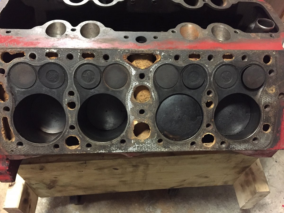

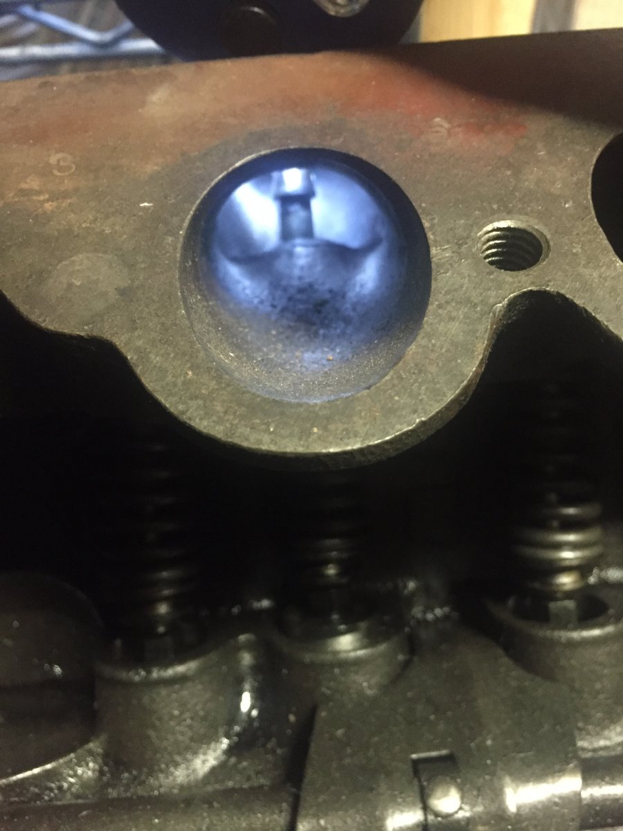

    So it’s a stock 3.75” stroke crank unfortunately (I kind of got my hopes up :rolleyes:). It is definitely relieved though, as you guys thought. I took a closer pic that shows it well. I also tried to shoot a pic down an intake runner to see if anyone could tell if it’s ported. What do you think?

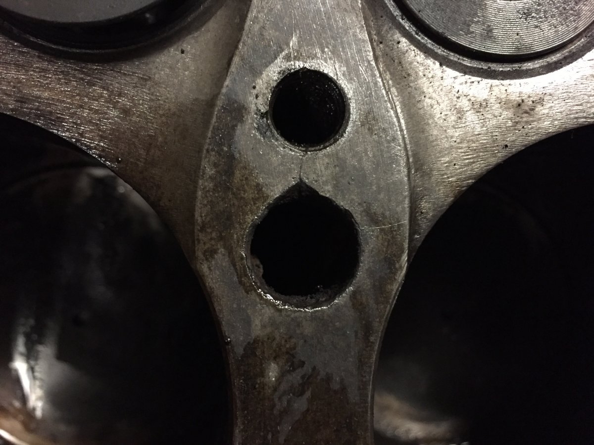

    I cleaned up part of one side of the block and there were no cracks visible in the critical areas, but there were a pair of common ones in between the water passage and where a head stud goes. I understand that those are not an issue. Clearly, I’ll need to clean the rest and have the block magnafluxed but this seems like a good start.

    Looks like someone has been in there cleaning up those runners. That is a pretty cool block your playing with. The relief job looks good and you said it had adjustable lifters. Hot rod flathead. You're a lot farther along than I was when I bought mine. Keep posting, I enjoy this stuff.

    That motor has had something in the cylinder when it was running. @Atwater Mike probably guessed it as close as any of us, he's been playing cars and motorcycles as long or longer than any of the rest of us. If I am not mistaken it'll go an eighth (.125) I believe or you can sleeve it, neither will be cheap, you just have to decide how much cool is worth to ya.

    What you need to do is have the block cleaned, magged (if it passes that), then pressure tested . . . if it passes that, then sonic tested (if you're planning a large overbore). If you're going to not do a big overbore, then you need to have the bores accurately measured to see if they are round, not worn, not tapered, etc. This determines whether or not it really should be bored. I have YET to find one that didn't need to be bored - just sayin (folks ran the crap out of them back in the day). Do the best analysis work possible on the front end - then you can make good decisions based on accurate facts.
    I'm sure it will need a valve job - they all do. You want to find a machine shop that really knows flatheads, has the correct flathead specific guide bore mandrels and truly understands the nuances of the flathead valve train. This is the area where I see the most heinous crimes! If you need any info, just PM me.
    Those cracks are of no worry - we say that Ford has a "standard part number" for them - pretty much always see them. If you do the job right - then you'll have great results . . . if you're into cutting corners and slapping it back together . . . well, yah get what yah get! LOL

    Knead, that is true, but I understand that the factory relief looks much different. I think they are straight on the sides. I’m sure others with more experience and knowledge will chime in.

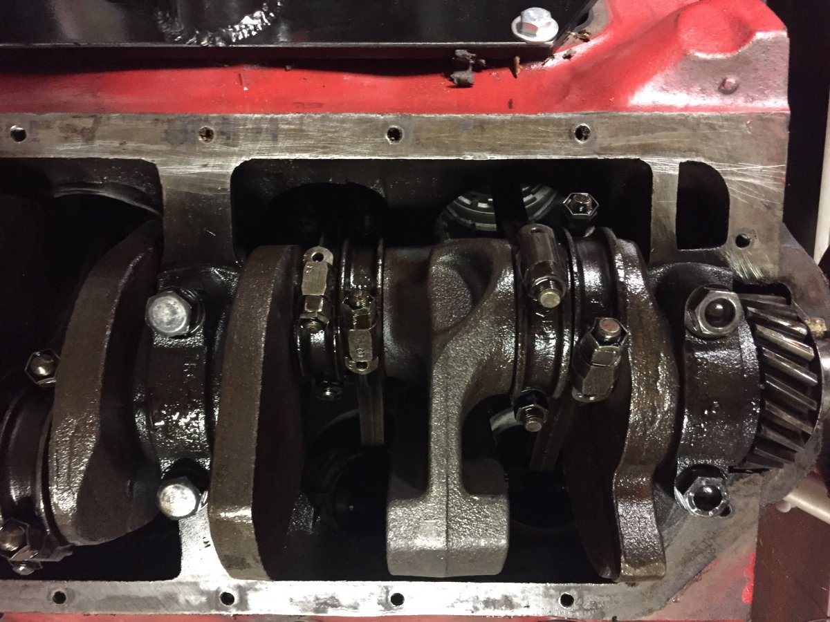

    I finally got into the engine a bit more. Got the crank and pistons out. The pan rail looked good with no cracks.

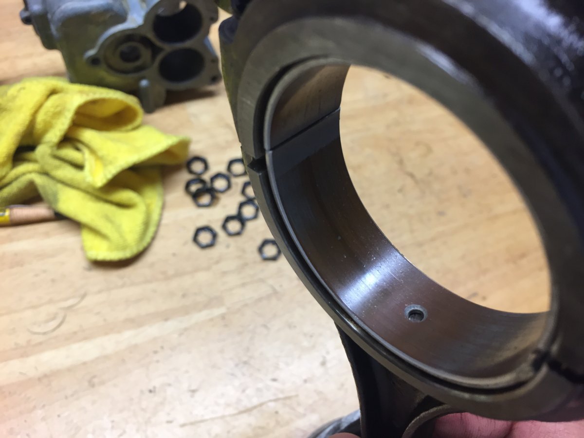

    The rod bearings were down to the copper and the journals will need to be turned I think.
    That one wrecked piston seemed intact, so it doesn’t look like a ring broke. Like many have said, something must have gotten in there. The previous owner had drained the oil and taken off the pan so I couldn’t find any evidence of broken metal bits in the engine.

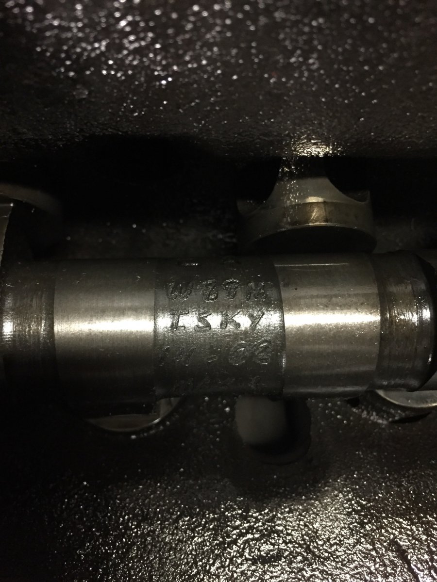

    Once the crank was out I could see the cam. Looks like an Isky Max-1. Seems like a decent cam and looks to be in good shape. Hopefully I can reuse it.

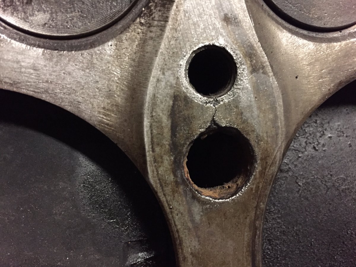

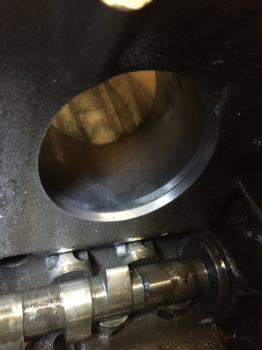

    Take a look at the bottom of this cylinder. Is this evidence of a previous sleeve? Or is this some sort of crack? I really hope it’s no big deal since the block is looking good the more I get into it.

    I also was checking on the crankshaft and testing for the “ring” as discussed in Vern Tardel’s book. The crank rings great when the counterweight closest to the flywheel is struck. Not so much on the one closest to the front pulley. It gets progressively less ringy in the ones in between. I know this test is not 100% accurate, but I’m worried I may be looking for a new crank.
