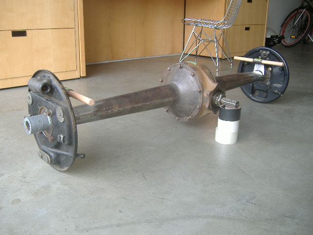

  6. Model A banjo does not have a pinion support bearing in the rear of the banjo housing as do the V8 style banjos (32/48). The pinion can ride up the ring gear and snap off under load, where as with a V8 banjo the end of the pinion is fixed and cannot do this. Also I really don't know of any kit or used parts that interchange to convert an A banjo to open drive as the pinion/driveshaft is one solid piece where as on the V8 banjo the pinion and driveshaft are seperate and attached via a coupling sleeve with a pin.
    I have included a photo of a V8 pinion with the bearing on the rear and the splined end on the front where it joins up to the driveshaft via the coupling sleeve. Model A has either of these.

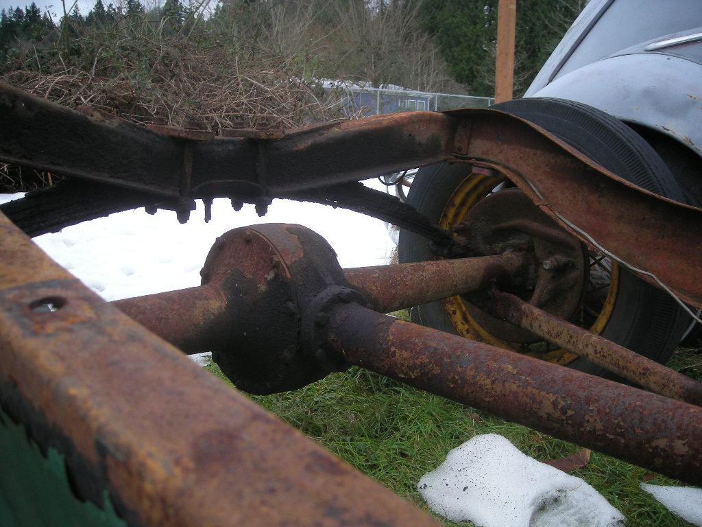

  15. Model A and some 32's have a ROUND flange on both the diff and torque tube where the two meet. V8 or 33/48 banjo's have what is referred to as a scalloped bolt flange, very easy to tell. Compare the flange between the photos of an early 32 and a V8. There are also other subtle diffrences in the banjo housing itslef and axle housings.
    Also Model A was the last of to use the top mounted spring. Any POST Model A banjo will have the spring hung behind the diff not on top of the diff. If yours has been converted the spring perches or rear crossmember will probably have been modified in some way that is visible.
    If it is a Model A diff and does have juice brakes there will probably be windows/holes cut into the backing plates to clear the spring perches as juice brake backing plates interfere with stock Model A spring perches.
