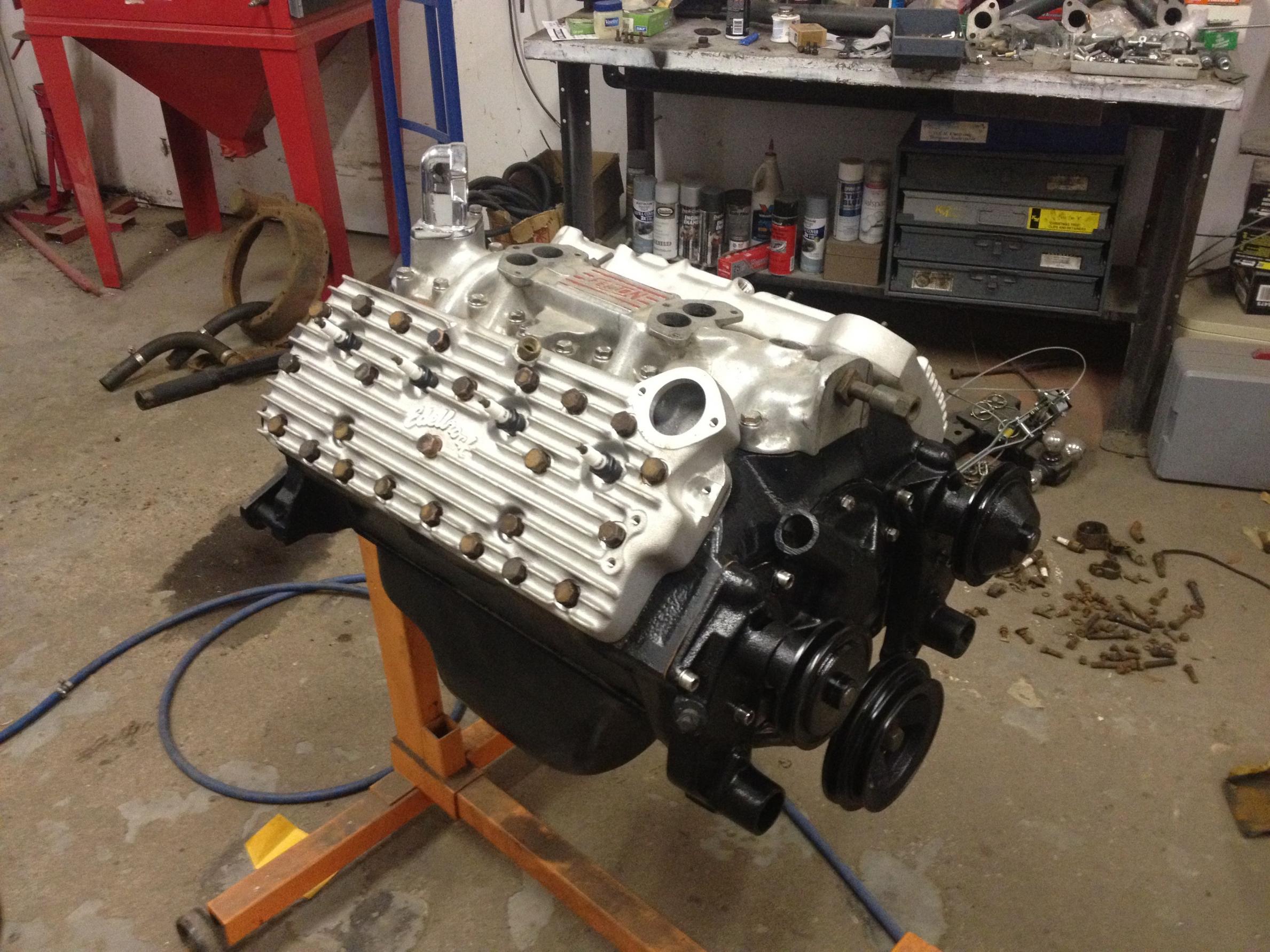

  9. devotion
    Joined: Apr 15, 2009
    Posts: 193
    devotion
    from idaho
    Well, either way I'm in this block the same money as the second one ( that I am getting my money back for) so its all good. I also have decided in the long run this will be better so that if a rebuild is needed down the road there is plenty of meat left on I for another bore for myself or someone else. This guy has been building motors since the 60s, including the one he has sitting in his 38 ford at the shop...his high school car. I've decided to go 60 over and a larger crank. Any draw back to going to a 4 1/4 inch crank with stock rods?

    Any updates? I got a 49 flathead also, I've rebuilt lots of other engines but never a flatty, just started taken it apart, and have to get all 8 stuck pistons out. Oh what fun this is going to be!

    Don't give up on it. A good machine shop can pin most cracks and save the block. An exception to this would be cracks caused by freezing. Find an experienced machinist that has done many, many of these flatheads. Do not have the block welded, as the chance of failure is much higher - then your block is probably junk. You might be lucky enough to find a crack free block. I just found 3 merc blocks in a barn. all 3 were crack-free. one last point: figure $3000 to rebuild it - even if you assemble it. Best of luck...jack

    Round 3 or 4. I've lost count. As of tomorrow I am picking up a complete, rebuilt stock, 47 flathead. Wish me luck! This is after numerous other engines have found their way into my garage... Can't seem to shake the idea of the flathead. I think it's some sort of illness.
