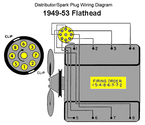

    I recently purchased a 53 mercury flathead. the heads have EAC on them. I am trying to figure out the firing order, from what I found it should be 1-5-4-8-6-3-7-2. the only prob is that when I pulled the head on the passenger side and spun the crank by hand the 1st cyl I set to the top. Then I turned it and the #3 cyl came up next then the #4 came up 3rd and the #2 cyl came up last. That doesn't match the supposed firing order. I do not know how the other side comes up.
    Now the spark plug wires were in the order of 1-6-4-8-5-3-7-2. I don't think that was right because it wasn't starting up.
    I drew a pic for a reference. I numbered the cylinders inside the cylinder and then I numbered to the left the order they come up when I spin the crank.
    If any one could help me and tell me the engines firing order I would appreciate it.

    I know nothing of flatheads but every modern engine had no.1 as the closest cyl to the front of the block. In your drawing it would be the one on the right. Maybe a good time to get a manual.
  3. eaglebeak
    Joined: Sep 17, 2007
    Posts: 1,271
    eaglebeak
    Were you turning it in the right direction?
    #1 cylinder is on the passenger side front.
    #2 is right behind #1.
    #3 is the third on the passenger side.
    #4 ....passenger side.

    I was just gonna post that pic, but my prob is that the cylinders dont seem to be in that order? the rotor was spinning clockwise when I spun the crank clockwise
  7. eaglebeak
    Posts: 1,271
    eaglebeak
    When did this engine last run? Was it in a car? Was it used for some industrial application? Can you crank it backwards and see what happens?
    I think you will have to set everything according to that drawing.

    As stated, the firing order is 15486372. Starting with 1 at top, as you turn the crank, 3 will be at top next, but it will be on the intake stroke ( 5 will also be up on power stroke on other bank), 4 will be up next and it will be on power, then 2 will be up but it will be on intake and so on down the line. All is normal with your engine.

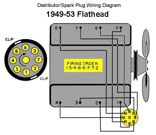

    Installed some flashy new ignition leads on the 8BA today. Clear red ignition leads, screw on terminals...etc. Couldn't get it to fire. Checked the firing order a dozen times and everything was cool. Scratching my head I decided to do a quick search and came up with this thread which pointed out to me that the cylinders are not numbered as I thought. Printed out that pic above and presto she fired right up...in gear and took off like a hotrod straight into the steel bin and wooden bench! :eek:

    1 and 2 are not on same crank pin 1 and 5 are on same crank pin.
    2 and 6 are on same crank pin
    3 and 7 are on same crank pin
    4 and 8 are on same crank pin
    This is the correct spark plug wiring diagram
    Tig.
