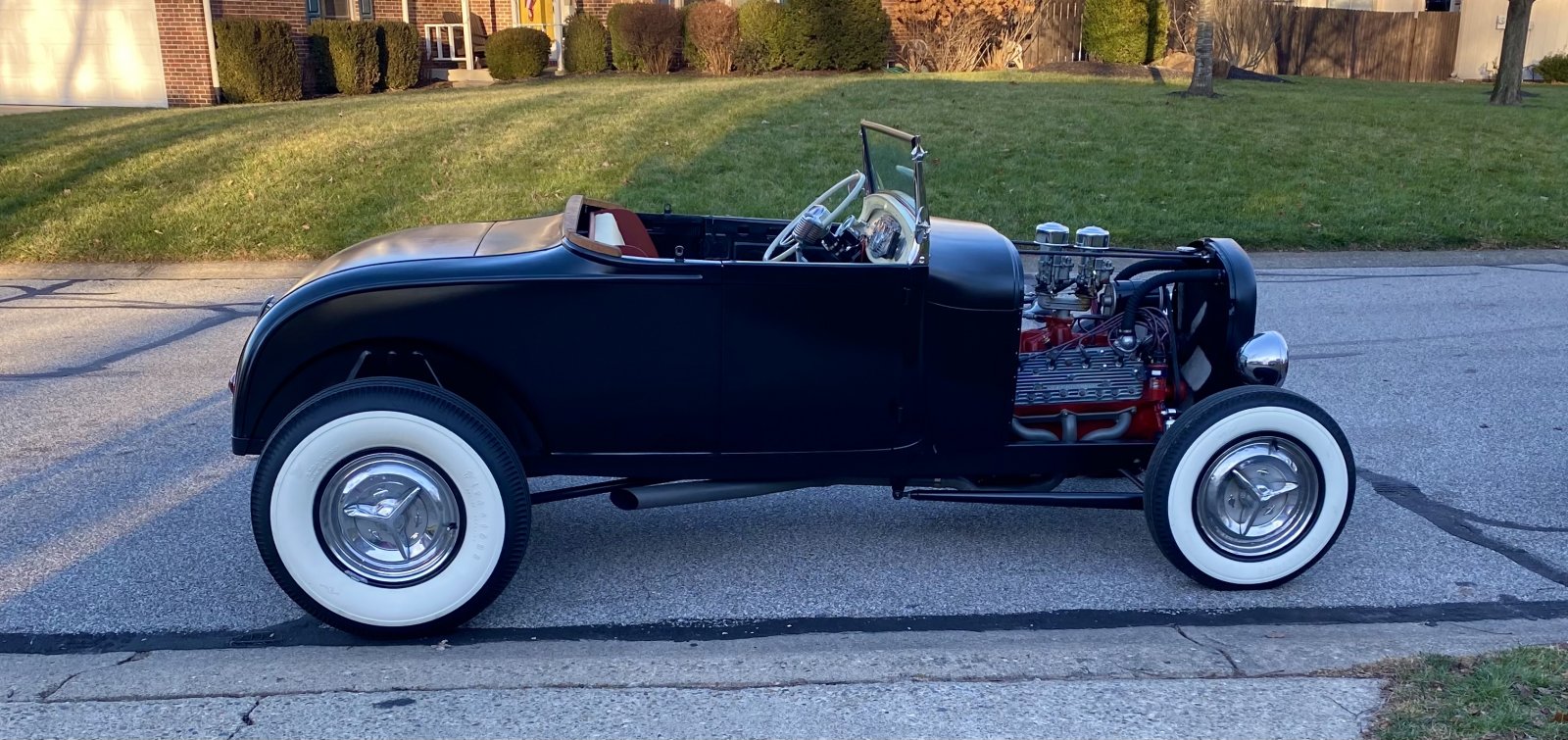

    I used a unknown running flathead in my latest build and have about 1200 uneventful miles on the car. This motor is tight , starts east idles perfect and runs fantastic. Hardly leaks a few drops of oil over a week or two sit. And doesn’t get much above 100 degrees when warm. Maybe the custom radiator? IDK but it’s just been perfect. Anyway reason for this post is because I’ve wanted to drive one of my Hot Rods from Indiana to Las Vegas for Viva. I asked a close friend to go and he already bought the VIP ticket for himself so now it’s On. The weakest link I’d imagine is the motor due to I don’t know anything about it while the rest of the car is new. Newly built and everything looked at or rebuilt. So I did a compression check and all cylinders are between 90-95. Now my big question is. This thing gonna make a 3600 mile round trip? A lot of this trip would be hours and hours of driving at 2800 RPM’s. Driveline is top load 3 speed 40’ Banjo. Im just afraid of breaking down and some hillbilly turn me into a lampshade. Any positive and negative inputs appreciated.
