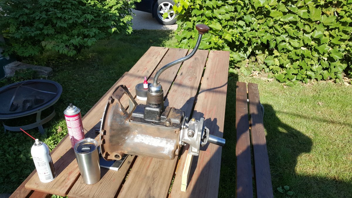

    Here's my tranny all ready for paint. Well actually I still have to go thru the shift tower to put in all the new detent stuff and leather washer I got from @Mac VP but the main trans is all back together. The tailhousing is a modified 36 Chevy one that'll let me run a slip jointed torque tube kinda early sprint car style. Shifts nicely now. Should be awesome after I get the shifter all serviced. Can't say enough good about the parts and service Van Pelts offers us, not to mention their fantastic website and catalog.
    Just need to figure out if I need to modify the throw out setup. 20180914_095053.jpg 20180914_093831.jpg
