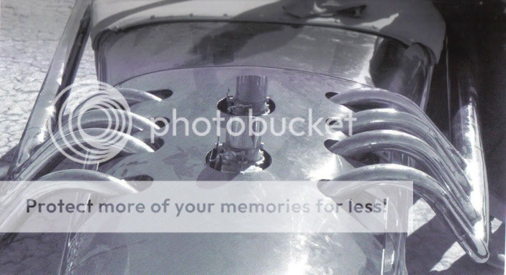

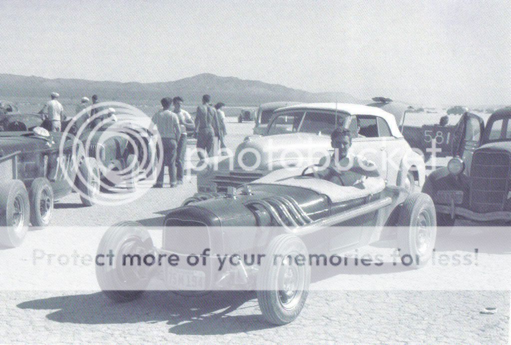

    Anyhow , amongst these pictures (Stated in the mag as being of a Flat Cad rod) were these ;
    Now to the best of my (Admittedly limited) knowledge all Flat Cad motors had 6 exhaust ports not the 8 that are indicated by these pictures . Also to the best of my knowledge the only major difference between the Cad and LaSalle motors was the displacement (346ci and 322ci respectively) .
    So what's going on with the car in the pictures ? Did the LaSalle motor have 8 ports and that is what is under the hood of this car ? Is it a Cad motor with un-siamesed (If you follow) exhausts ? Or is it something different altogether (Such as a modified Ford V8) ?

    HaHa! That pic has been posted several times, and discussed.
    All caddy and Lasalles had 6 exhaust ports, as they are the same block, with different bores.
    That engine simply has a 'faux' exhaust, or is split at the center exhaust port.

    True, but look at the pic. The exhaust are not evenly spaced, the center two are closer together. I think it's safe to guess that either one of the center exhausts are fake, or both center exhausts run out of the center port on the top of the engine.

    Ratty, it's always possible that it isn't even a Caddy, but I've seen that pic several times. Every time, it was claimed that it had a flatcad, with a Burrell 2x2 intake.

    I imagine that he was trying to help the engine breathe better, by splitting or "Y-ing" the center exhaust pipe, as 38FLATTIE said. I don't know if that would actually accomplish much though, considering that the center exhaust is still restricted by its narrowest passage. Cool roadster...I always love seeing the Cad-powered rods with the pipes exiting up high.

    My bet would be on whoever made the headers "Y-ing" the center siamesed port into two pipes. I've seen the same thing done several times on hot rodded Olds 303 and 324 engines.

    the neat little hotrod is owned or was owned by Don Berg..it was sporting a 34 cadillac engine

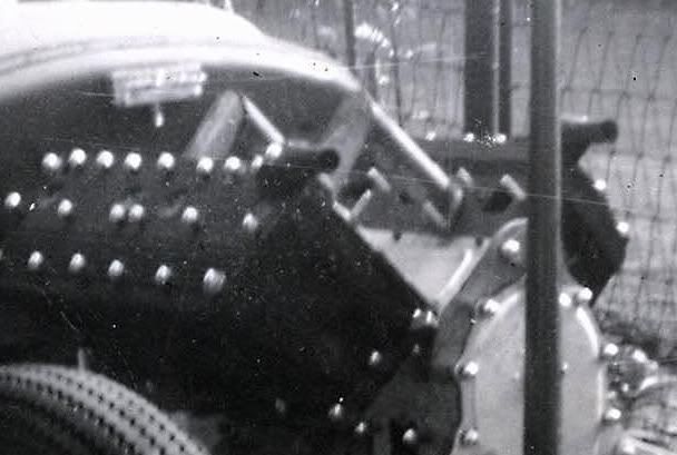

  17. I have pics of the Bob Wright roadster under construction, but don't have permission to post them. The engine has 8 exhaust port, the heads do have HC cast into them and the intake is custom made.

  19. I was given the ok to post the construction shots
    It definitely has 8 exhaust ports [​IMG]

    Wow Jimmy , thanks for sharing those pictures , loving the front cover too !
