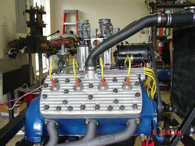

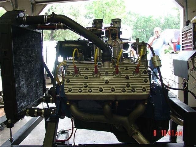

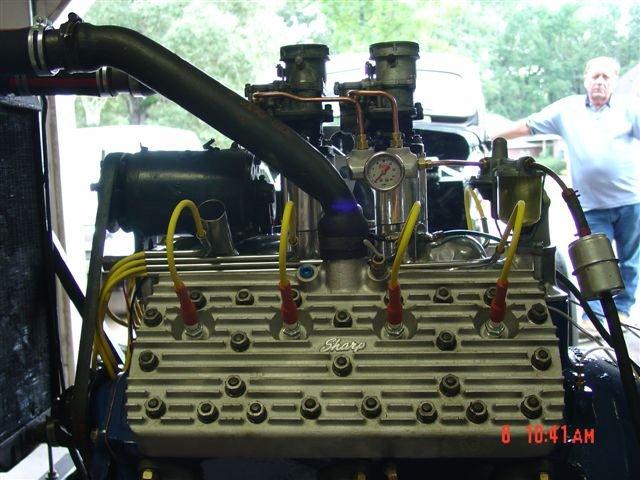

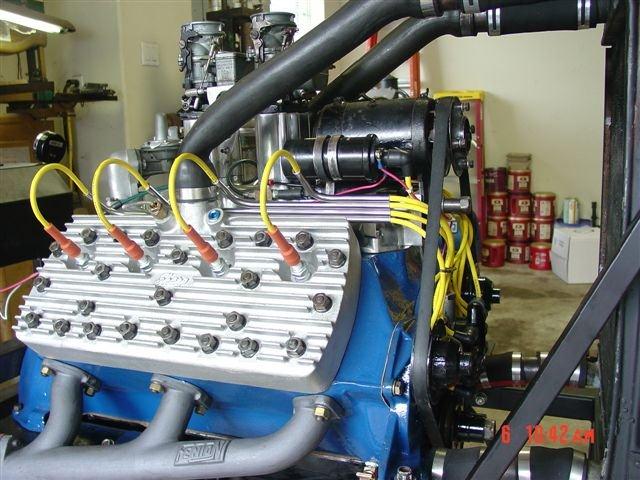

  13. Gene Boul
    Joined: Feb 9, 2006
    Posts: 805
    Gene Boul
    Here's a couple of pics of what I did. Not the best pics but was in a hurry! Note you definately need a regulator, something like 2.5 #'s or so...
    The motor is on a test stand with no regulator, but will have in the car along with a 6V electric pump and a three position switch. g
