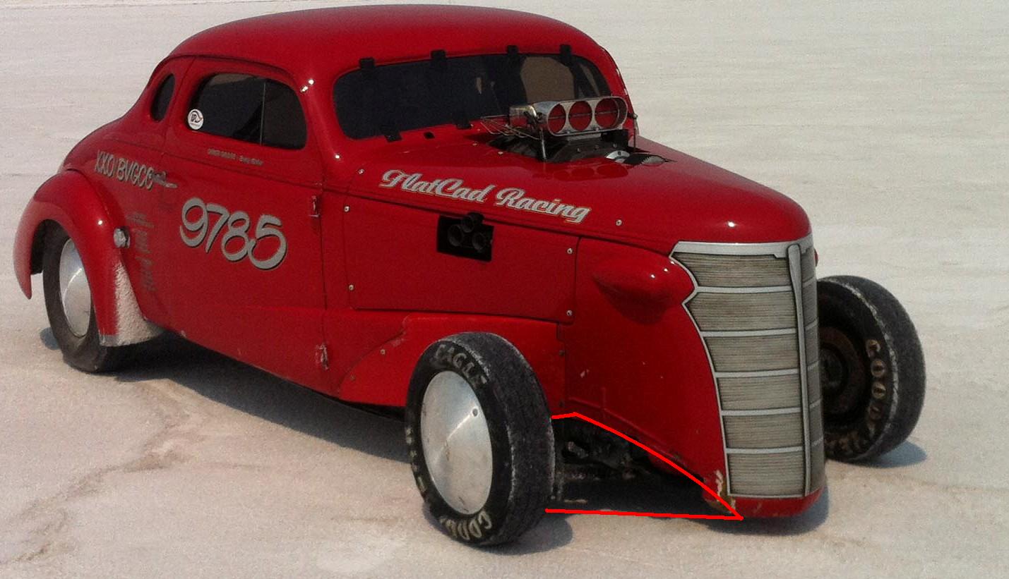

  23. Guys,
    I'm bored today, and I have ms paint...:rolleyes:
    Why not add aero to the existing front end? Knife edge the bottom, follow that body line up the side to over the axle, then out to the inner disks? Do the rules allow this?
    Thom

    Thom, that might work-we'll talk!
