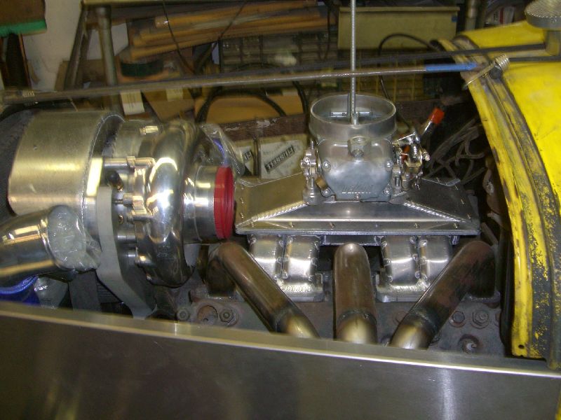

    Well, we spend so much time talking about the FlatCad, that I sometimes forget there are other Cadillac flatheads out there.
    This is Garry Odberts Flatcad roadster, that will be on the salt this year. It's got a Procharger supercharger- way cool!
    Thanks for the pics, Garry!:cool:
