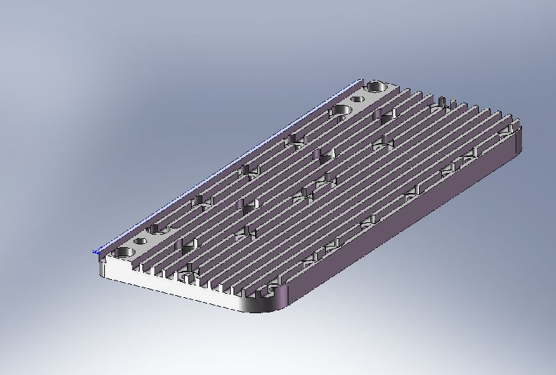

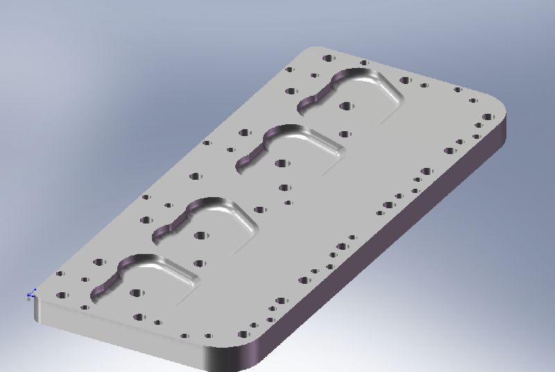

    I spent the day with a CAD modeler/digitizer. I now have two-piece heads on CAD. This will allow us to use different chamber designs, to see what will flow best for us. I thought this was pretty cool stuff!

    Buddy, Thanks so much for the invite. The info about you making your own heads is down right outrageous ! I know you can get aftermarket high compression heads but these new heads are way boeyond my comprehension. I will definitley keeping an eye on your head design.

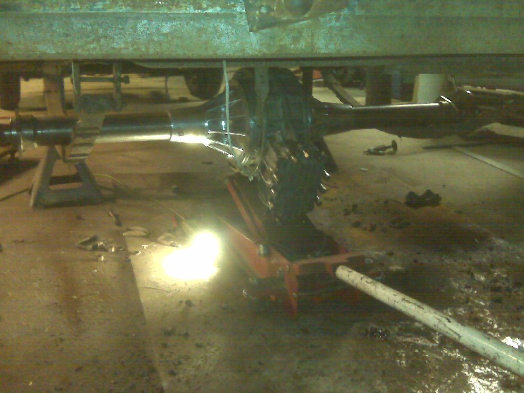

    Afte some fussin and discussin, we decide on a Halibrand quickchange, over the GM 7.5". Wrenchbender sent me pics, as he starts the install.It will still be a 4-link setup.
    out with the old, in with the new.

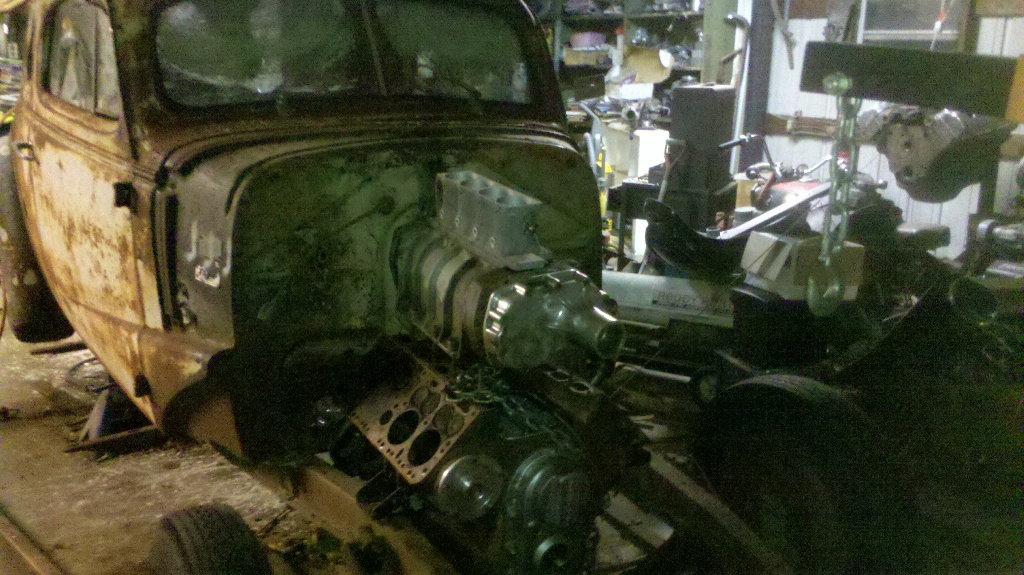

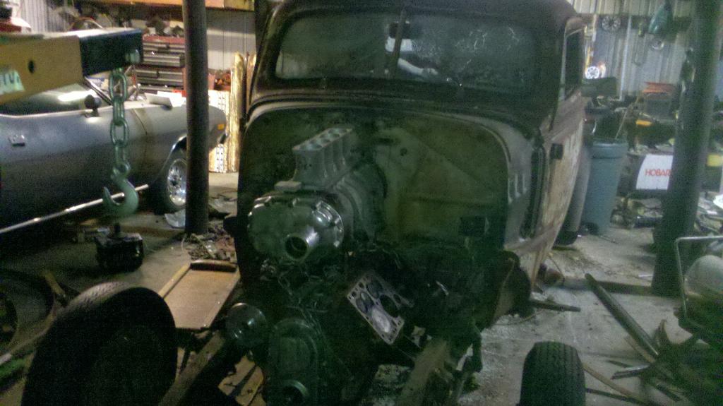

    The rear end is in, and we started mocking up the engine in it, so we can get the proper ride height.
    Once this and the tranny are in, the front suspension will be next.
