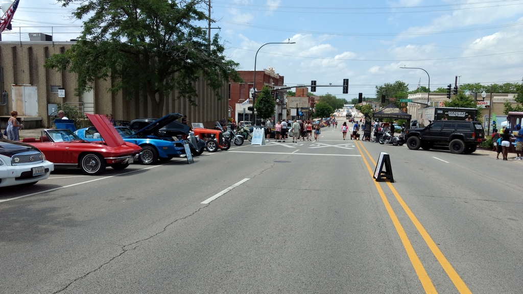

    And finally here is a shot of the car show that we missed out on (wife and I drove over there in suv later in the afternoon when I knew I had the problem fixed) with lots of the cars already gone. Looks like it would have been good fun.
