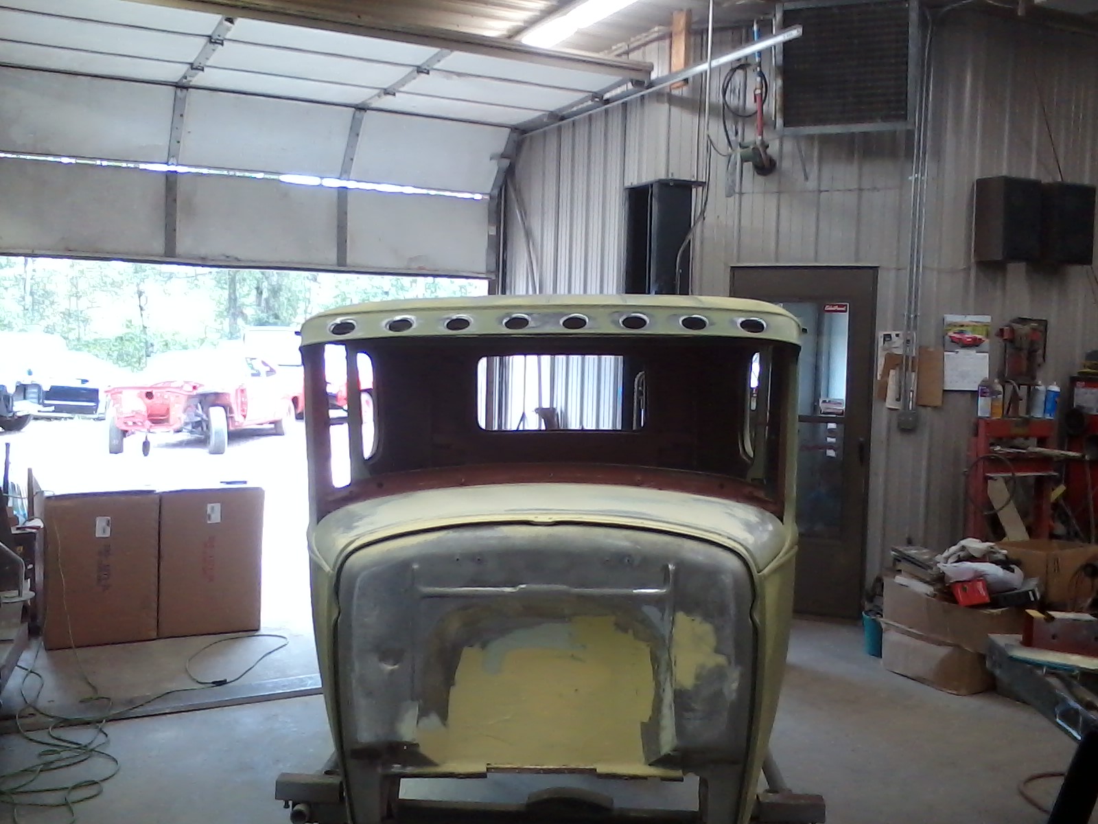

    First time for me to flare holes with a flare die. It went a lot easier than I thought. Did it in-place on the body as the prior owner had welded the visor in place.

    I have been told it adds strength and at higher speeds less buffeting. This is my first AV-8 project so others may know for sure. It is the traditional hot rod look I want.

    Nicely done!!! I just did mine too "no dimple die though" , can't see through the holes because the header piece is in the way but at least I know it won't fly off at the drags haha!
    Looks great man! Cheers!
