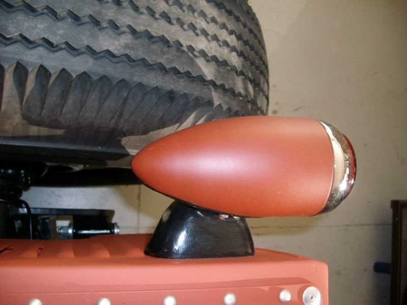

  18. KUZTOM
    Joined: May 6, 2008
    Posts: 909
    KUZTOM
    Thanks very much for taking the time to have a look, & the kind words.
    I suppose we could throw the above idea's into this Tech Week Thread also.......
    We had some steel toe caps from work boots given to us ,so we used them for mounting the 39 Chev tail lights....

  20. KUZTOM
    Joined: May 6, 2008
    Posts: 909
    KUZTOM
    With the Head Lights, which are from an old Railway Jigger, we used a combination of old 1940's Bicycle componets, seat & handle bar stems, plus forks, once fitted ,we had a clearance issue,so the trusty steel to caps came in use,to raise things up a tad....
    As you can see ,its all very simple stuff, This whole build was about using stuff in the shed, giving every thing a go ,and having heaps of fun !;)
  21. How do you do the rivits, with a air chisle and some kind of back tool?
  22. KUZTOM
    Joined: May 6, 2008
    Posts: 909
    KUZTOM
    Frank Hi, I have use it on various sheetmetals, the challenge is on thicker stuff, the tool tends to open up a tad in the 'jaw', but really its for doing just simple flares in light to medium grade sheet.
    Steve
  23. KUZTOM
    Joined: May 6, 2008
    Posts: 909
    KUZTOM
    All by hand , had to shorten them first, then just tapped away with a ball pein hammer , easy as ,just takes time.....;)
