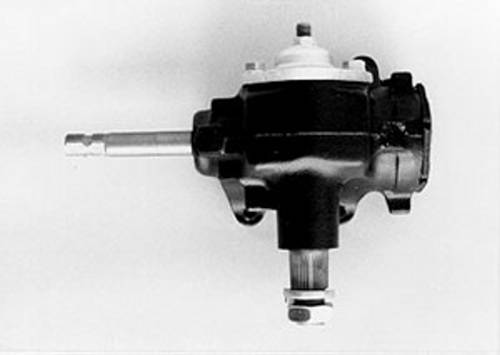

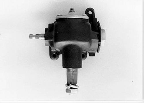

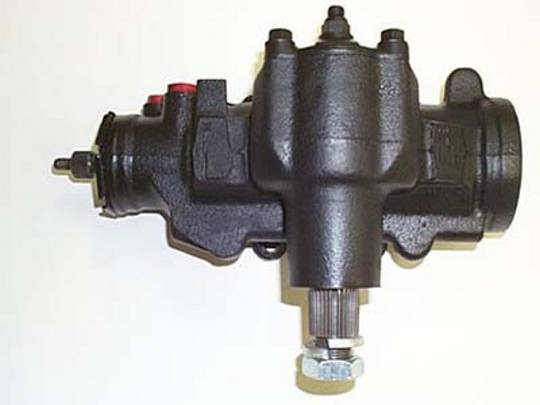

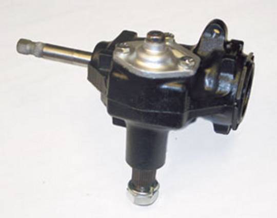

    Here's some pics of other Saginaw boxes.
    First pic - #122
    2nd - #525
    3rd - Vega #140 box for reference
    Long as I'm at it - #605 - power box
    5th - #800 - power box
    Note that the #122, #525, #605 and #800 all fit the same bolt pattern as the Vega #140 so that should make life easy for you.

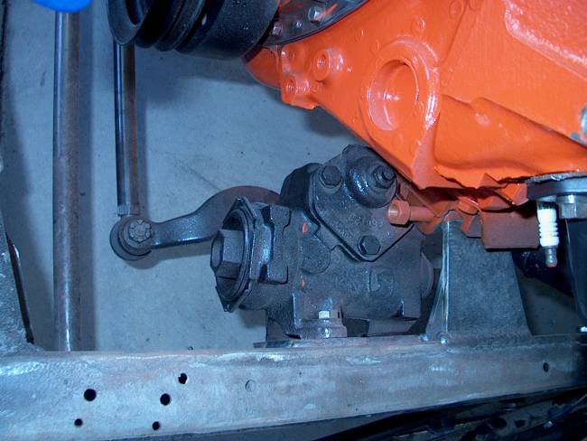

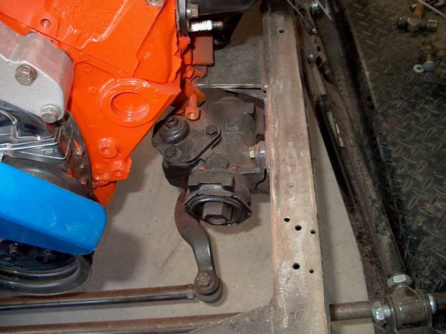

    Along those same lines, here's a couple pics of an unknown to us Saginaw non-power box in an SBC engined 29 Model A.
    ID'd to an extent by the S shaped pitman arm.
    I'm not sure if the mounting pattern is the same as the above mentioned boxes, but looks to be either right on or close.
    We think it comes off a Camaro from perhaps the 80's or so.
    We found in on the shelf in a Needles, California junkyard.
    Be aware that there's a similar looking box that steers the reverse of what you need.
    We came close to buying that one, but realized it wouldn't work for us.
    Probably something to do with front and rear steer cars.
    It is a larger box and may work well for your 37.
    It's a moderately tight fit in the A, but not bad.
    Doesn't appear that headers will be a problem either.
