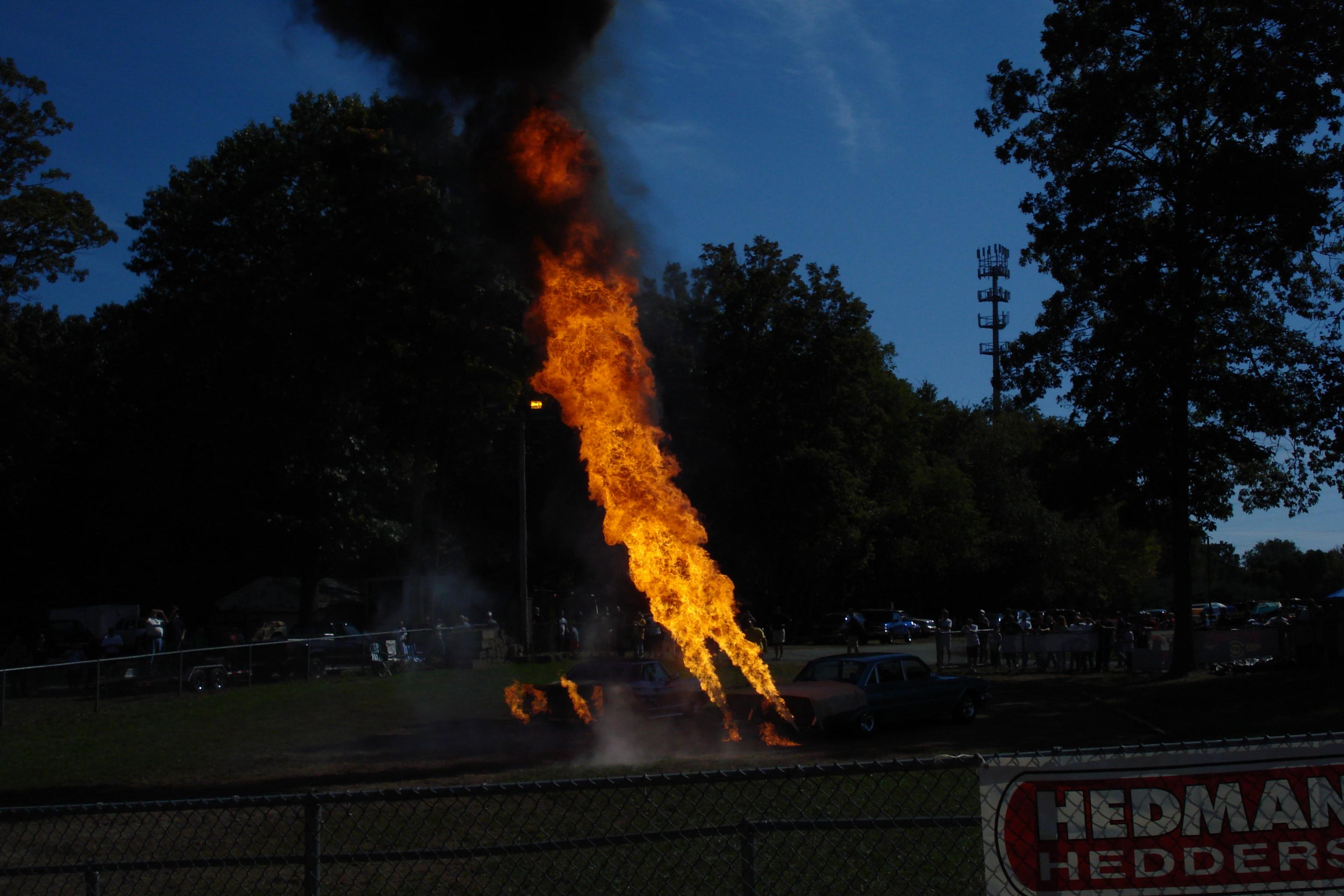

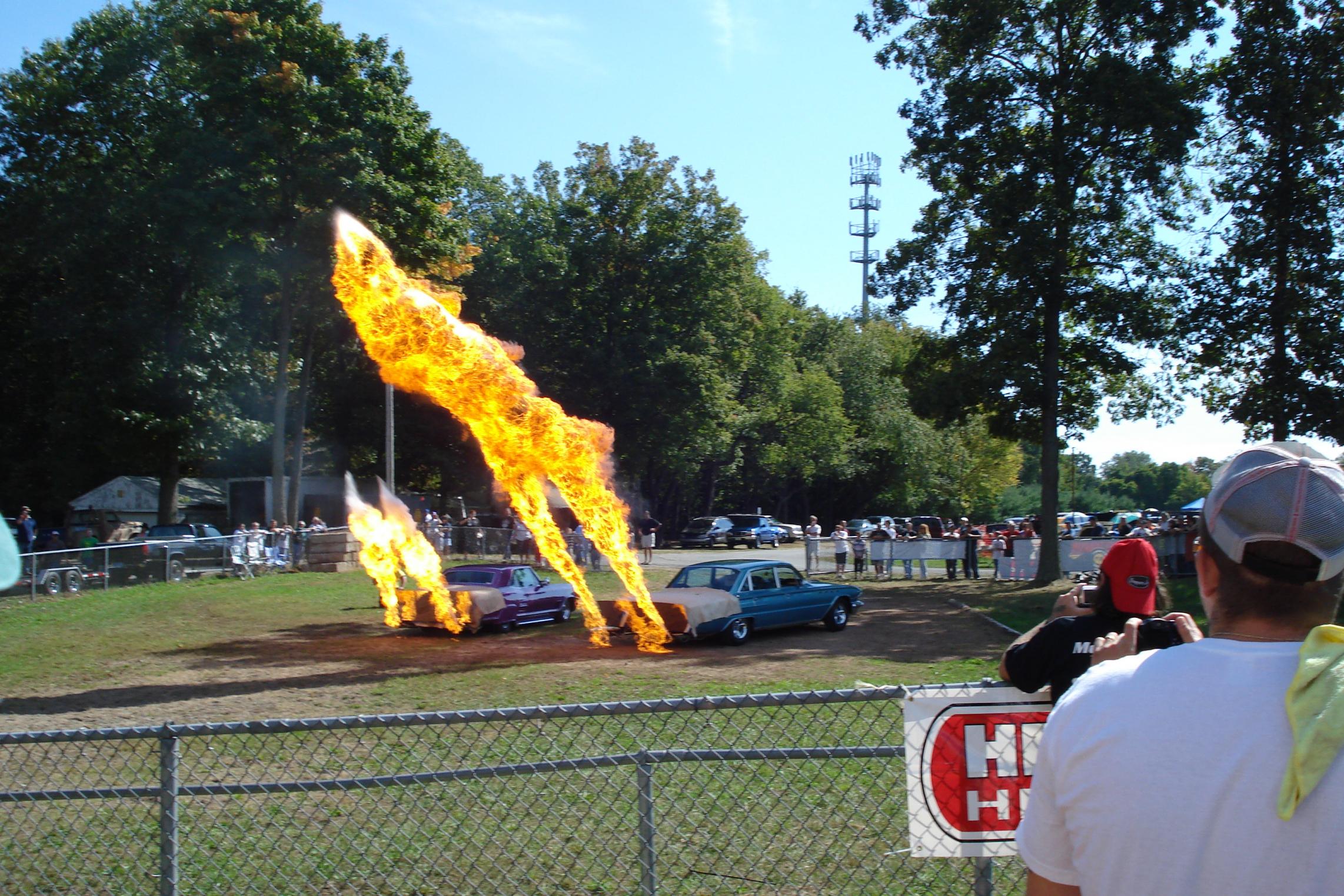

    This was taken @ the Pyramid Shriners Car Show, Orange, Ct. Oct 2007.
    These guys came up from ether New Jersey or Pennsylvania I thing.
    Those flames were real cool. I was about 75 to 100 yrds away and the heat from them was unreal.

    I like Ltorch's kind - but the Blowtane setups and cans of compressed gasoline in the trunk scare me. I stay far away from those . Anybody got a horror story.
  25. lostforawhile
    Joined: Mar 23, 2008
    Posts: 4,160
    lostforawhile
    I think most of the people with those are doing it competitivly there is an entire culture of that stuff, compressed gas is cheating to me anyway, not the real deal
