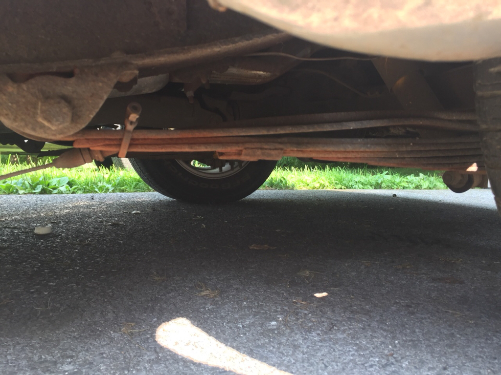

    [​IMG]So I picked up a 51 fleetline for me and my boys to work on together. I knew it needed work need to replace the master cylinder and am going to replace all the brake lines and am thinking of disc brakes and power booster (keep bouncing back and forth on firewall or under floor) but there are a lot things I have to make right[​IMG]
    It has a power steering but the rack hangs down lower than I like so I’m not sure what I’m going to do
    The rear springs are shot and will need replaced.
    Has a 350/350 in it with a 10 bolt rear (it looks a little wider than the front and I can see tire rub on the inner fenders)
    But I don’t like the wheels on it and think I’m going with some steel so hopefully I can get some with enough backspace to tuck them back in so I can put the skirts back on.
    Then a lot of other little things steering column is out of a newer chevy I want one more period correct one, some rust in the floor boards and about 40 pounds of bondo in the nose the looks like crap. Looks like we have some busy weekends ahead of us, looking for more of a old school 50’s street rod
    Been reading thread after thread and have a lot of ideas from here any tips are appreciated

    And also with that homemade power steering that is full lock in the first picture so turning radius is going to suck. I may have to go back to manual steering not sure until I can get it out and drive it

  9. Most racks are intended for shorter steering arms.
  10. Jack it up and see what other shit you find.
  11. What is that hanging down below the rack ?
  12. gene-koning

    Looks like a crossmember (angle iron?) someone added to mount the rack to. I can see the flanges of the rack with the bolts going through them attaching the rack to that low hanging piece. Gene

  13. JohnCox

    Gene is correct. Home made mount (not very pretty either) for the rack, it hangs way too low for my taste I can see me ripping it off on something.
