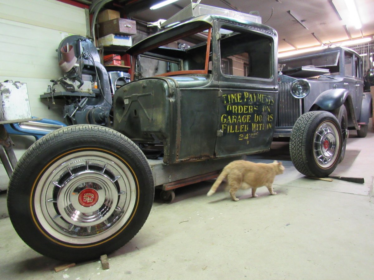

    looking very well,whats in the backround a roller? maybe
  9. 1932 rolls royce 20/25 limo. amazing car!

    i see the truck is getting a cat scan lol
  11. Looks great! What does the kitty think?
  12. ha
    he thinks it is purrrfect

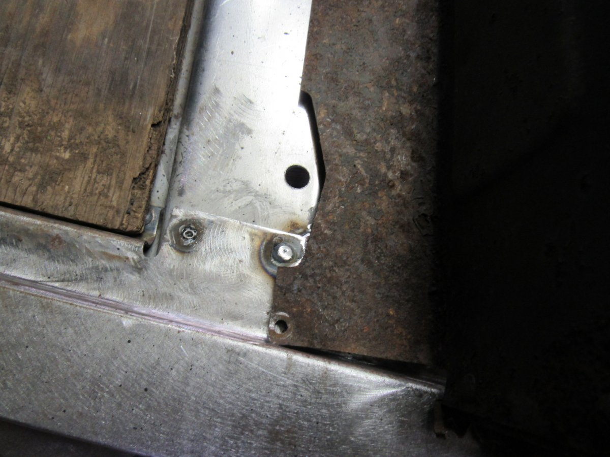

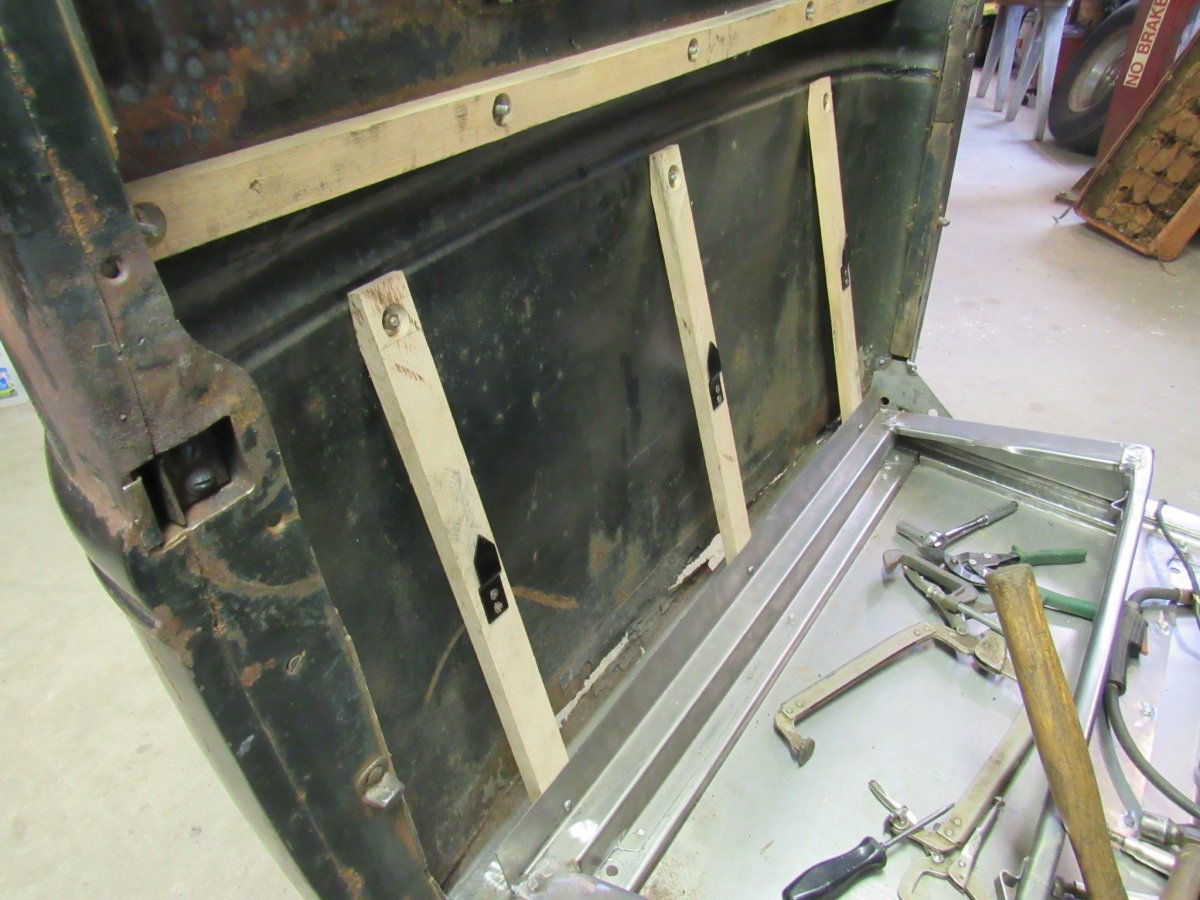

  13. started to fit the seat frame, I had to cut a couple notches for the body mounts. I measured off the original frame. IMG_0074.JPG IMG_0075.JPG IMG_0076.JPG IMG_0077.JPG
    chryslerfan55, Stogy, brEad and 6 others like this.

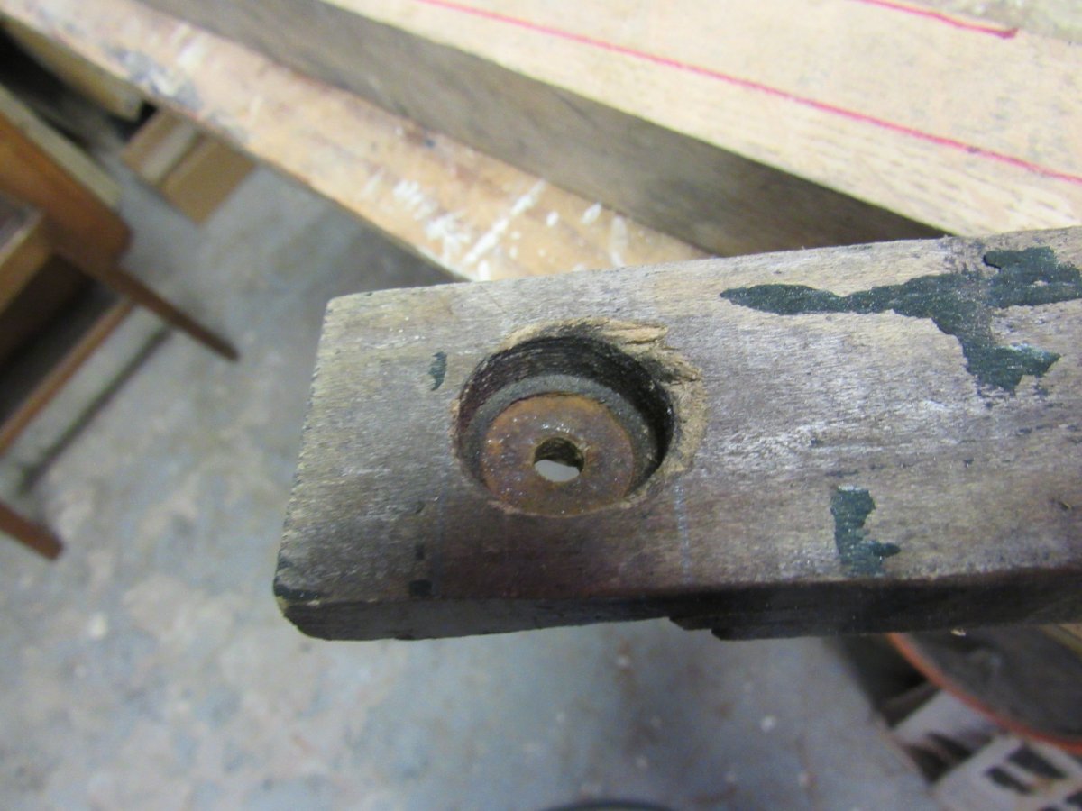

  15. the Slacker had cut the 3 boards for the back of the seat last year but had never drilled the holes or cut the angle into the ends. I set up the sliding miter and cut the angles into it. IMG_0079.JPG IMG_0080.JPG IMG_0081.JPG
    chryslerfan55, Stogy, brEad and 5 others like this.
  16. the holes and mortice have to be drilled perpendicular to the miter I cut, so the bard had to be clamped at that angle. IMG_0083.JPG IMG_0082.JPG
    chryslerfan55, Stogy, brEad and 7 others like this.

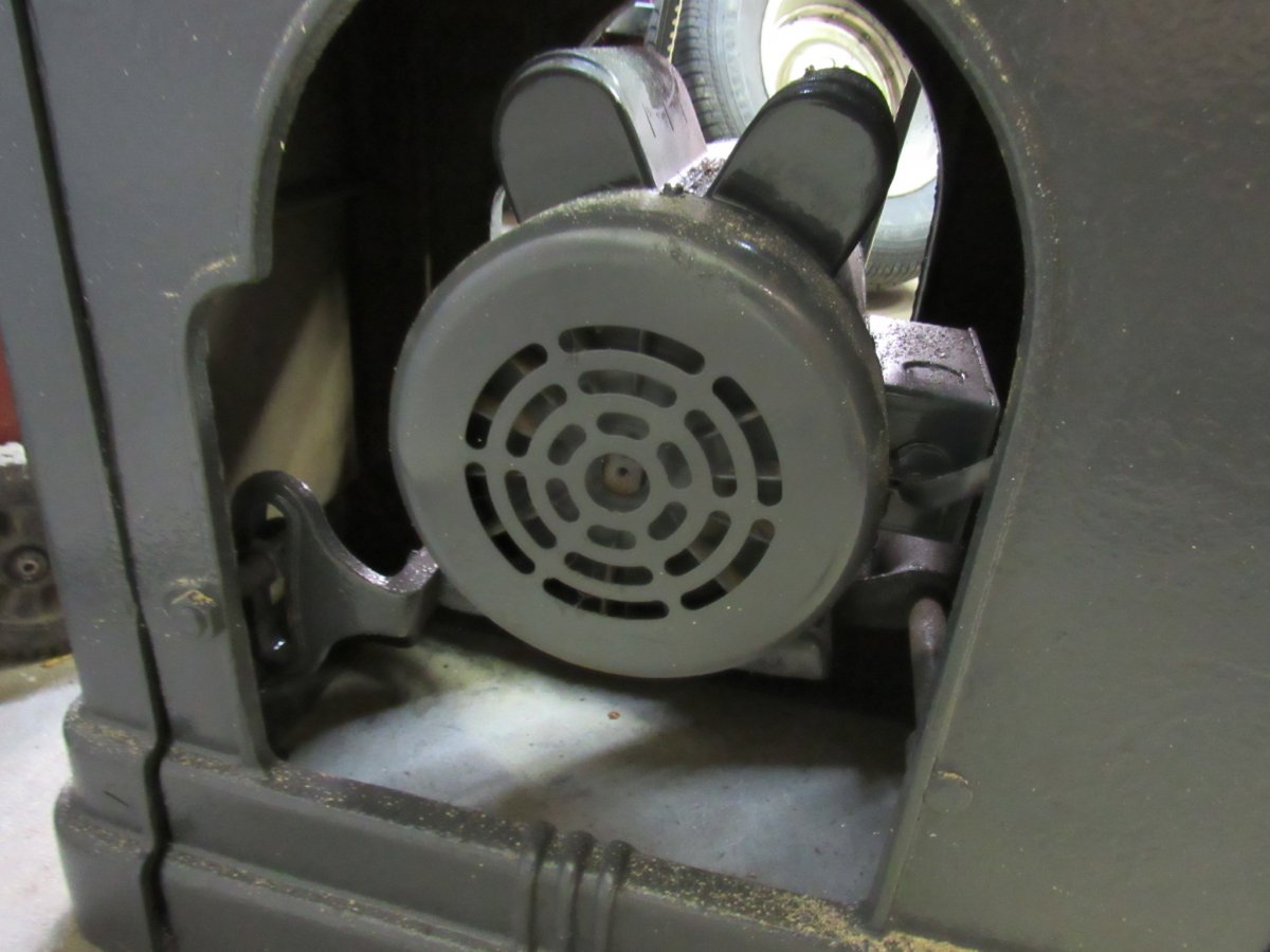

  19. the new tires for the bandsaw came in. I cleaned up the wheels and installed them. the machine has/had a couple issues. the blade looks like it had been tracking wrong and was hitting the back shield of the upper pulley and the door of the lower pulley. for some reason the top pulley "head" had been shimmed up with a couple washers. I pulled the washers out and put them on the nut side. this allowed to me to make the final adjustments of the upper pulley and guide bearings. it tracks perfect and doesn't hit anything. now I am having problems with the motor popping the breaker right as it gets up to speed. I tried it a few times and could only get it to stay running once by lifting the motor so the belt would slip, getting it up to full speed then I dropped the motor so the belt tightened and it stayed running. when it did run it cut wood amazing. IMG_0154.JPG IMG_0153.JPG IMG_0156.JPG IMG_0155.JPG

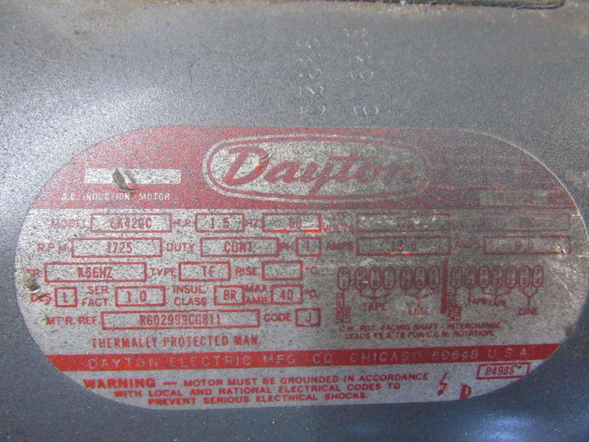

  22. I checked the plug and it is on a 20 amp breaker with a short cord. it starts fine but the minute it gets up to speed it pops the breaker. I was told there are flyweights[?] inside the motor that switch on the secondary windings that could be stuck? we need a electrical guy...

    you just have to free up/oil the hollow shaft/flyballs so the repulsion start works properly-make sure the commutator is polished up too

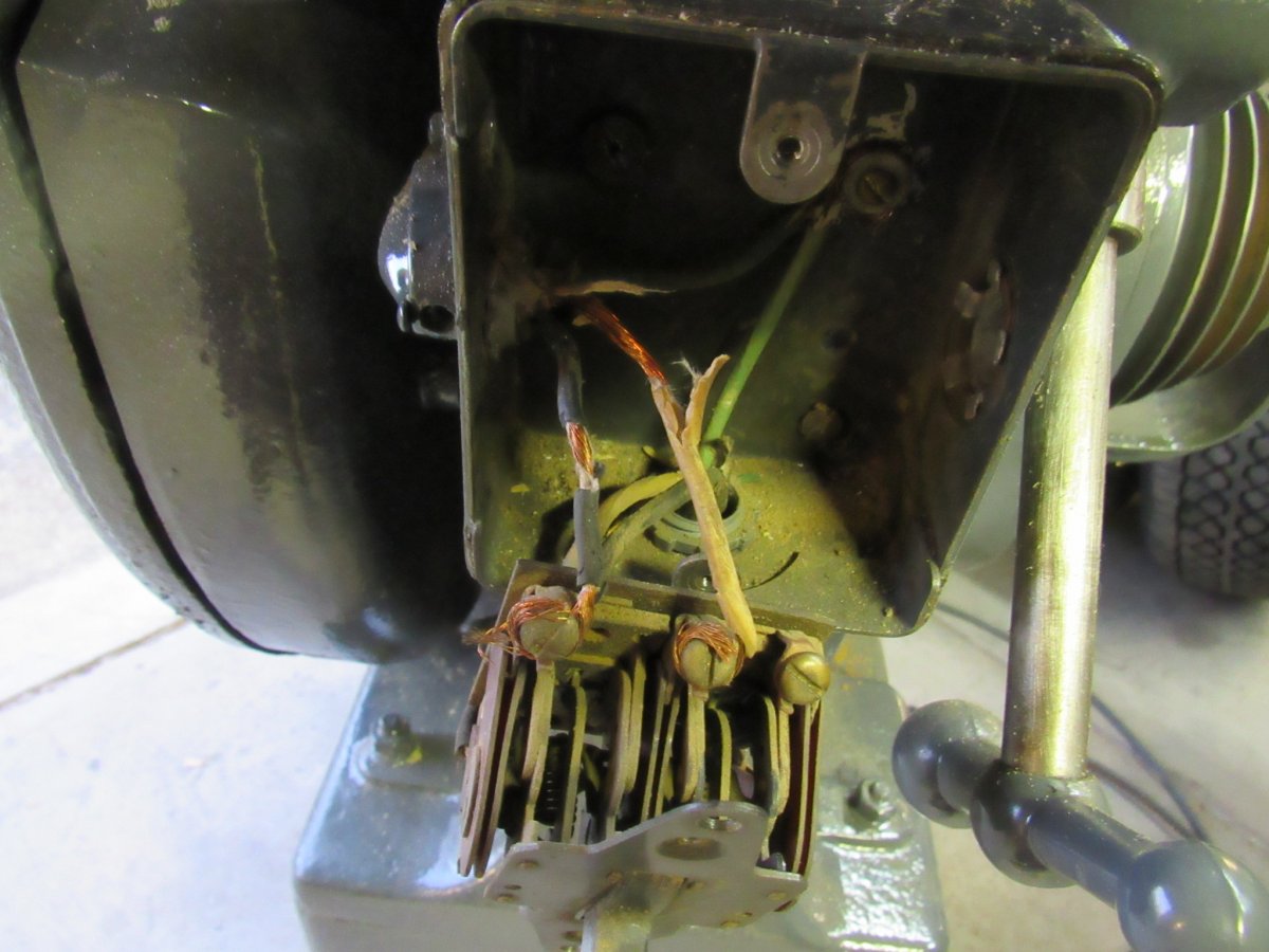

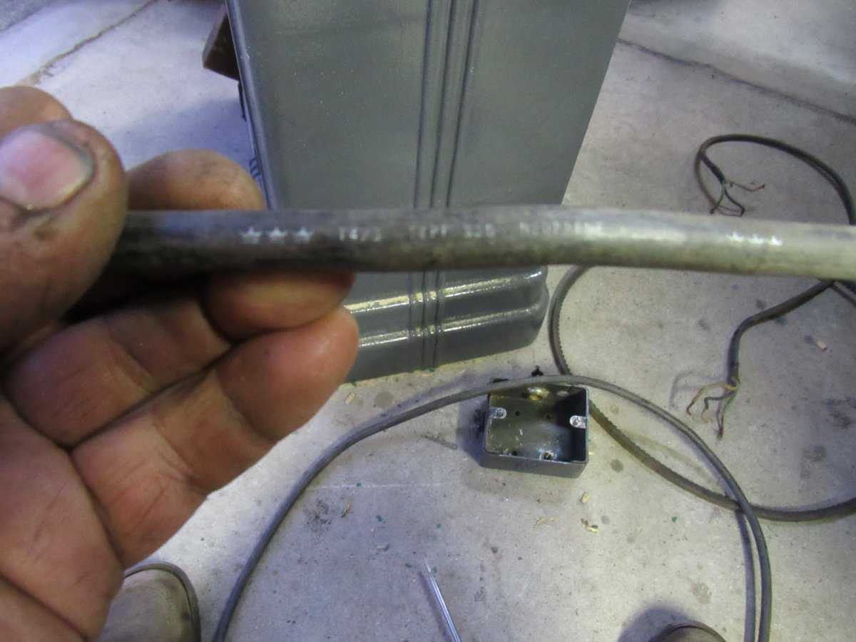

  25. ok, I just took the motor out so I could see what was going on, I found that this motor is a monster. 1.5 hp and running on 115 volts it draws 18 amps. much too close to the 20 amp breaker with the 14 gage cord they had wired it with. I decided to rewire it so I took the switch apart and found it must have been getting warm because the insulation just crumbled. . so the plan is to clean up the switch, paint the switch box, rewire it for 220 using 12 gage[?] wire . IMG_0157.JPG IMG_0159.JPG IMG_0160.JPG

    that junction box is scary
  28. I don't think it was going to ground. the insulation came apart as I pulled the switch out. pretty cool switch tho that disconnects all three wires.
  29. nunattax
    Joined: Jan 10, 2011
    Posts: 2,248
    nunattax
    lucky you are not 220V
    kidcampbell71 likes this.
