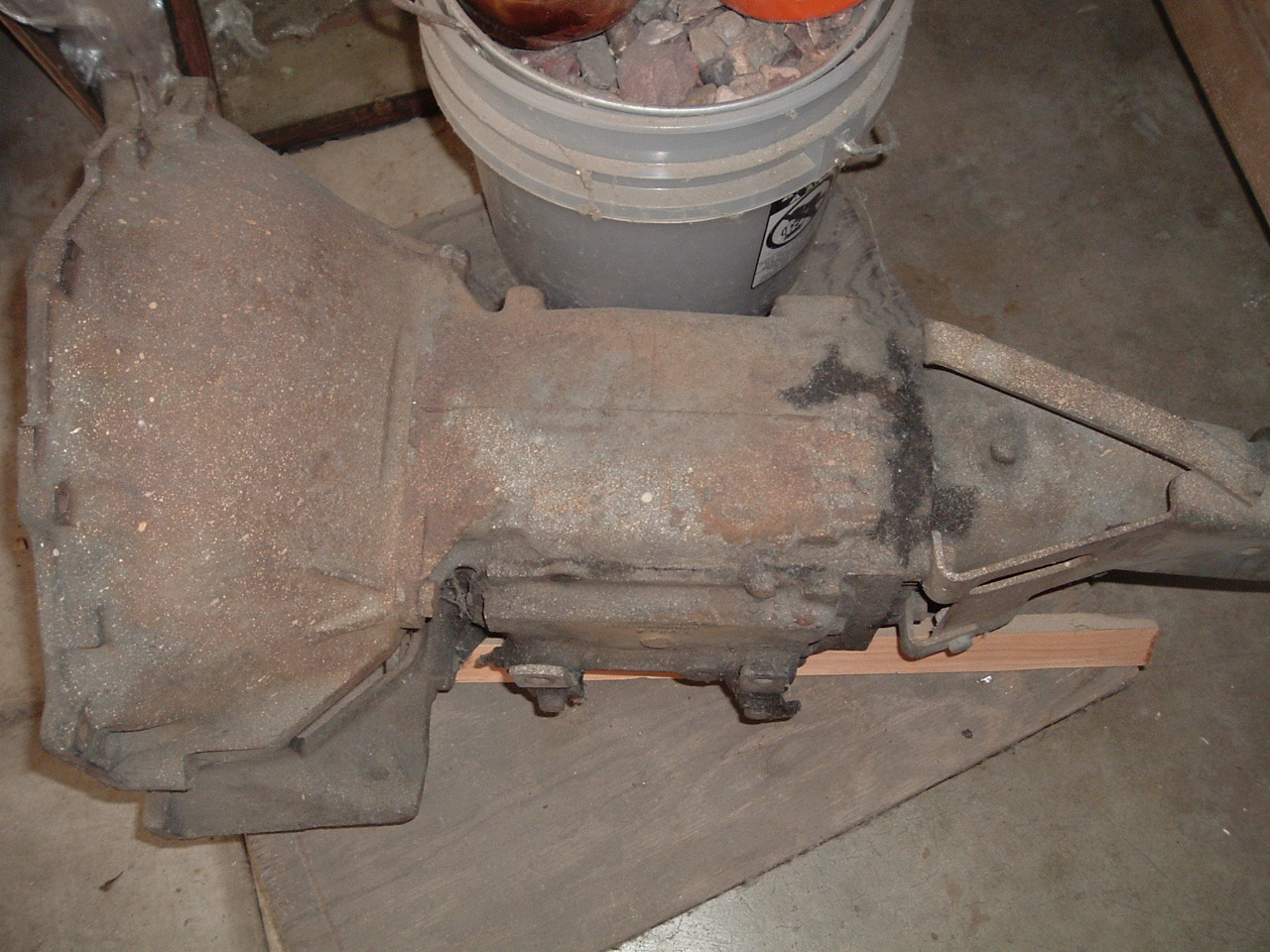

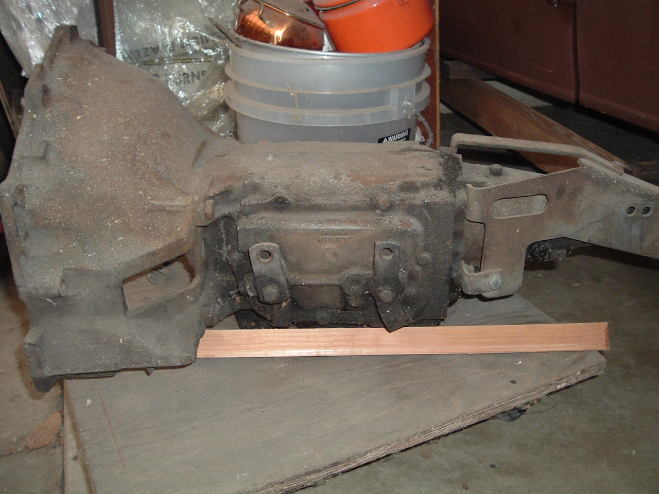

  10. Something like this yard art I have abusing my cart? 2003_0116stuff0001.JPG 2003_0116stuff0002.JPG 2003_0116stuff0002.JPG
  11. Invisible kid, do you know if the one in your pics is the synchro or non-synchro version?
  12. Haven't taken the cover off..... Just going by the net....:rolleyes: But,from what I gathered,it "should" be.......
    Not holding my breath on that one though.......maybe someone will chime in. Mid/late 60's GM from a truck.

    It is the full syncro model. The main case is longer, the side cover has more bolts......put it side by side with the earlier non-syncro 1st gear trans and the differences are unmistakable. to my knowledge, the case type you have was never produced in a non-syncro 1st gear version. Maybe a googler serach could turn up a pic of the other trans, there were produced in the hundreds of thousands, if not millions.

  15. Hey Ray and Jim- Does the "model" I have represent a full syncro unit? I can pull it to check,but with this info from you both,I'm thinking it is. Thanks.

    I absolutely believe yours is a full syncro model. I have one just like it (minus the shifter bracket) laying in my shop right now......also collecting dust. :D

  17. I have been doing some more searching and found this pic.
    The guy said it was a Saginaw 55-65 3spOD.
    So I guess that would be the non-synchro version.
  18. Thank You!:D
  19. The guy steered you straight. It's a non syncro 3 speed O.D. with the 4 bolt cover and the full syncros were a lot bigger with the 7 bolt cover...easy peasy.

    Yes, that is the non-synchro 1st gear trans. However, it appears to be for a '55 thru '57 model because of the length of the tailhousing and no rear mount pad.
    On '55/'57 cars, the trans just hangs off the back of the bellhousing with no additional support. The basic trans is the same for '58 thru '64, but is shorter and has the mount pad as mentioned previously. The '65 may have a longer tailhousing, but also had a rear mount, so this transmission is not a '65, in my opinion.
