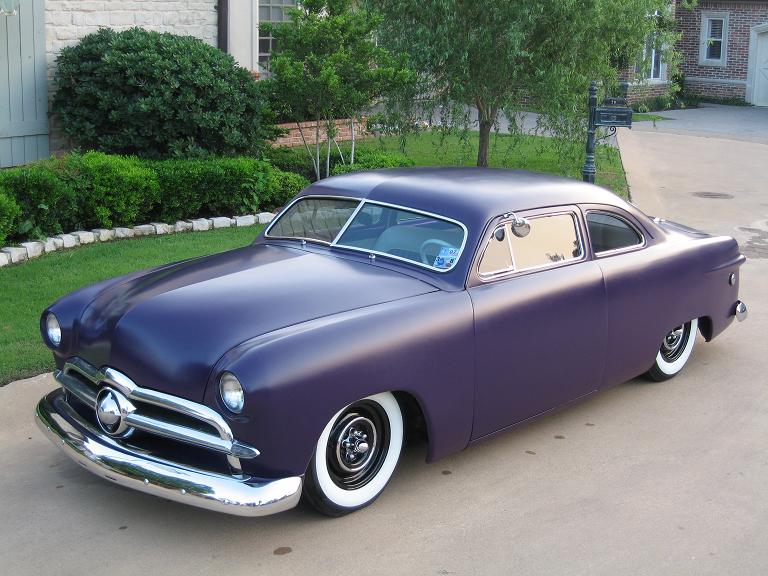

    Here are some pics of 2 Sedan chops that I came across on the HAMB. The first, albeit a 4-door, is my favorite. The roof isn't too crazy. Just plain and simple.
    I'm pretty sure it is a 4" chop too. The second is jus t another inspirational pic.
    Take note of the "hump" in the roof around the rear windows. I think this looks 110% better than having a "sloping" rear roof section, and is how I plan on doing mine.

  18. DAMN! That fordor ^^^ looks GOOD!!! I own a 49 2 door sedan. Post some pics of your car as it is now. What color is it in your avatar? I really dig it, kinda dark blue/gray?? thanks!
    josh

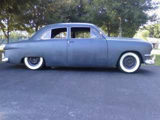

  23. Pacsh
    Joined: Apr 11, 2010
    Posts: 115
    Pacsh
    from Venice, FL
    Here are a couple shots. The first is the day I gought it, and the second is as it sits right now. I still have the skirts and baby moons. I'm torn between which look I like better.
    Sorry about the pic size/quality. My computer isn't uploading any of my other pics for some reason. I'll Have some fresh ones up tomorrow when I actually have a camera that isn't part of my phone.
  24. '52mildkustom
    Joined: Feb 26, 2010
    Posts: 21
    '52mildkustom
    from Forney Tx.
    mmmm just my two sense but I dig the skirts and moons. Maybe try a pop of color on your wheels like a red or blue candy. With or without the moons it should look cool. Good luck with the chop. Can't wait to see the build thread.
