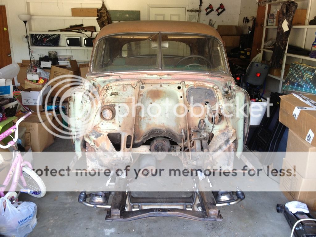

    I was able to get a little more work done last night. I got the front suspension unbolted and ready to come out, just have to figure out how to disconnect the steering box from the pitman... With all the 60 year old grime I can't tell where it could come apart. Any suggestions?
    Once this is done I can prep the frame and order my MII!!!

    Pull the nut off of it and then use a pitman arm puller or a pickle fork to separate the arm from the box, very simple. I love it man, I have a 52 styleline special business coupe. I kept the stock front end and bagged mine all around, good luck with it and like the many other offers if you need help or have questions pm me! ImageUploadedByH.A.M.B.1371002920.642427.jpg

    Thanks for the response. Looks like I'll be picking up a 1 5/16" socket and a pitman puller tomorrow!

    Thanks to raymiller's tip, I got the steering disconnected and front suspension is completely out! Thanks again!
    I ordered my TCI MII last night. I went with the "basic" kit that comes with manual rack, 2" drop spindles, 1" sway bar and single piston calipers. Going to replace rotors with some Stop Tech drilled/slotted ones and that should about do it for the front suspension minus the motor mounts.
    While I wait on these parts to arrive I'm going to finish cleaning the frame up and then start working on my rear axle. I have a lot of brackets and tabs to cut off and then have to weld on some spring perches and sort out the brakes. Not sure if the calipers are any good, but we'll see. New drilled Stop Tech rotors are going in for sure.
    Hopefully I can get all that done before the MII comes in...

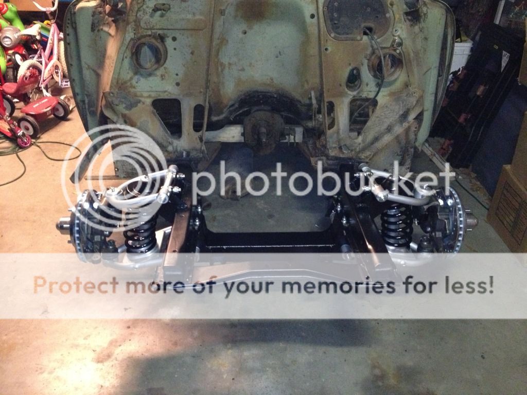

    Slowly making progress on my build. Summer is in full swing and I haven't had much time to work on it lately, but here are some pics of what I've done to date.
    Got my TCI front suspension painted and all put together.
    I was also able to gut most of the interior and remove the old 3 speed and closed drive assembly.
    Now I need to finish knocking tabs off my 10 bolt rear end and get it slid under the car and weld on some spring pads. I ordered V8 motor mounts and tranny X-member from Walton's that will be here by the end of the week. Also, I'm going to check out a motor & trans on Wednesday that will hopefully be just what I'm looking for! I'll update with pics when I can.
