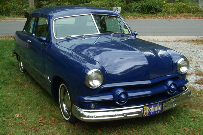

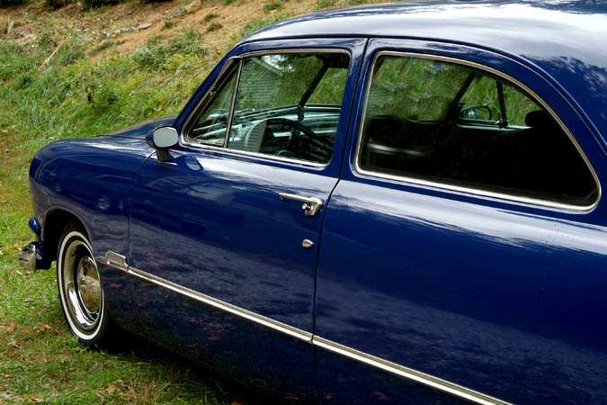

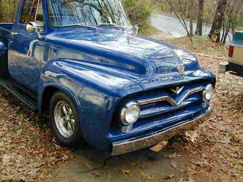

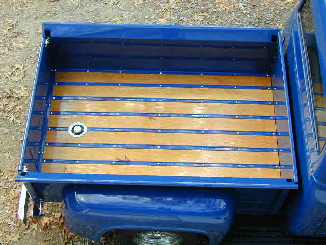

    Here are the other two cars from ground up that I mentioned.
