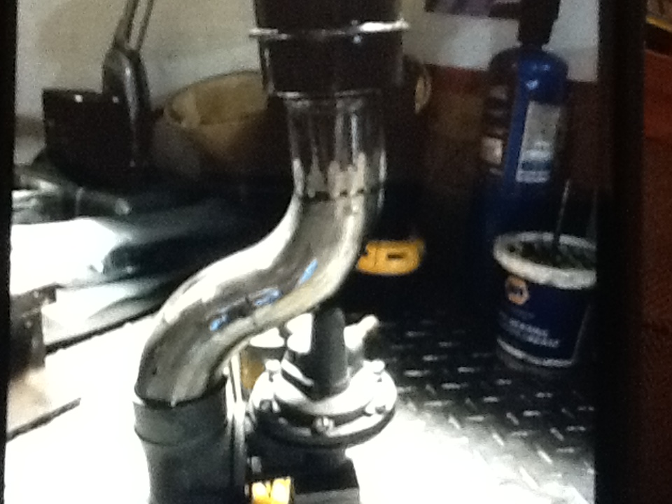

  4. How hard are you going to drive your hopped up A . My AV8 has a nice model A Banjo axle and close drive line no issue .
    If you swap to a Early V8 banjo rear axle your going to have to cut the drive line down .
    The only issue I had was firewall clearance With fuel tower / oil fill pipe and cap .
    I made a S pipe for the fuel stand oil pipe and cleared the FW

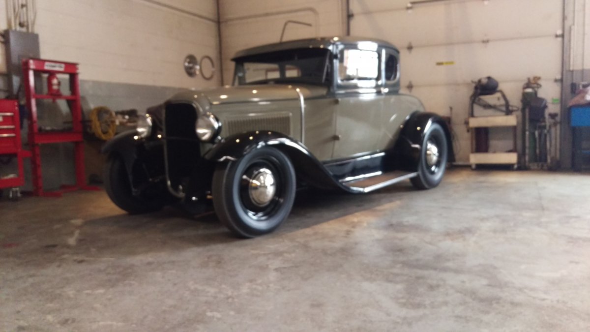

    IMAG0770.jpg IMAG0076.jpg My 31 has a 59a, 37 transmission, stock 31 rear banjo and it's held up just fine.
    Granted, I don't drag race it or dump the clutch, but I do drive it like I stole it occasionally. I think an A banjo is just fine and dandy under considerate driving with a flathead, plus it's already in the car, so it's hassle free...
    I'm using a 50 f1 steering box, and brakes
    And those are darn near bolt in as well.

  17. image.jpeg If you run the model A banjo axle with your 59 the fuel tower will hit the fire wall. This was my solution .

    How much of a chop, looks good.
  19. e z i
    Joined: Sep 5, 2007
    Posts: 596
    e z i
    3". Thanks!
