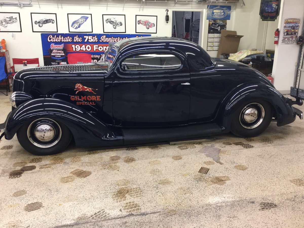

    80BF6FF2-E05C-404C-AAC0-C4A6F423620E.jpeg F1C2C6BE-955A-4D73-AF4E-256CE279FD61.jpeg Great determination and fine job
    Maybe some inspiration

    Very nice. If NYC had decent roads I could go for that stance but I'd be sure to leave pieces on the road if I did. Sweet ride. Black is awsome.

    I think you have it licked. That poor little car suffered at the hands of someone who never should have touched it, but you have her back on track.
    Nice work, -Abone.

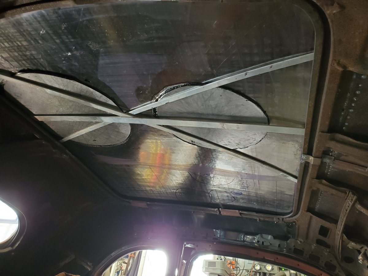

    I think I've got enough tacks I'm place now. Gonna get to sleep early so I can be fresh when I lay down the lead tomorrow. Got a very slight oil can at the angry face area. I'll lay a bar or three of lead on it to stiffen it up.

    Did a short section of leading. A quick fill and file so I'd know how much lead to put down. This test showed me I put on too much. I used half a stick and wasted 20% of what I used. Now inside to make some spam and eggs and give my dog her meds. 20200627_073841.jpg 20200627_073852.jpg

    This leading business sure is hard work. A full day at it and I'm still not done. I'll fill the deep depressions with lead but will use filler to smooth out the roof.

  9. You are leading it without fully welding it up?!

    Got plenty of solid tacks on it less than 1/2" apart.

    I think I know what Tman is thinking and I would agree. Then I remembered this is a traditional site and Do It Over's efforts are better than most traditional cars done 70 years ago. How well will it hold up and what will it look like in 40 years? Pretty sure I won't be around to critic it.

    I understand the tack weld concern. I have melted a lot of lead out of spot welded seams. Its gonna out live most of us anyway.

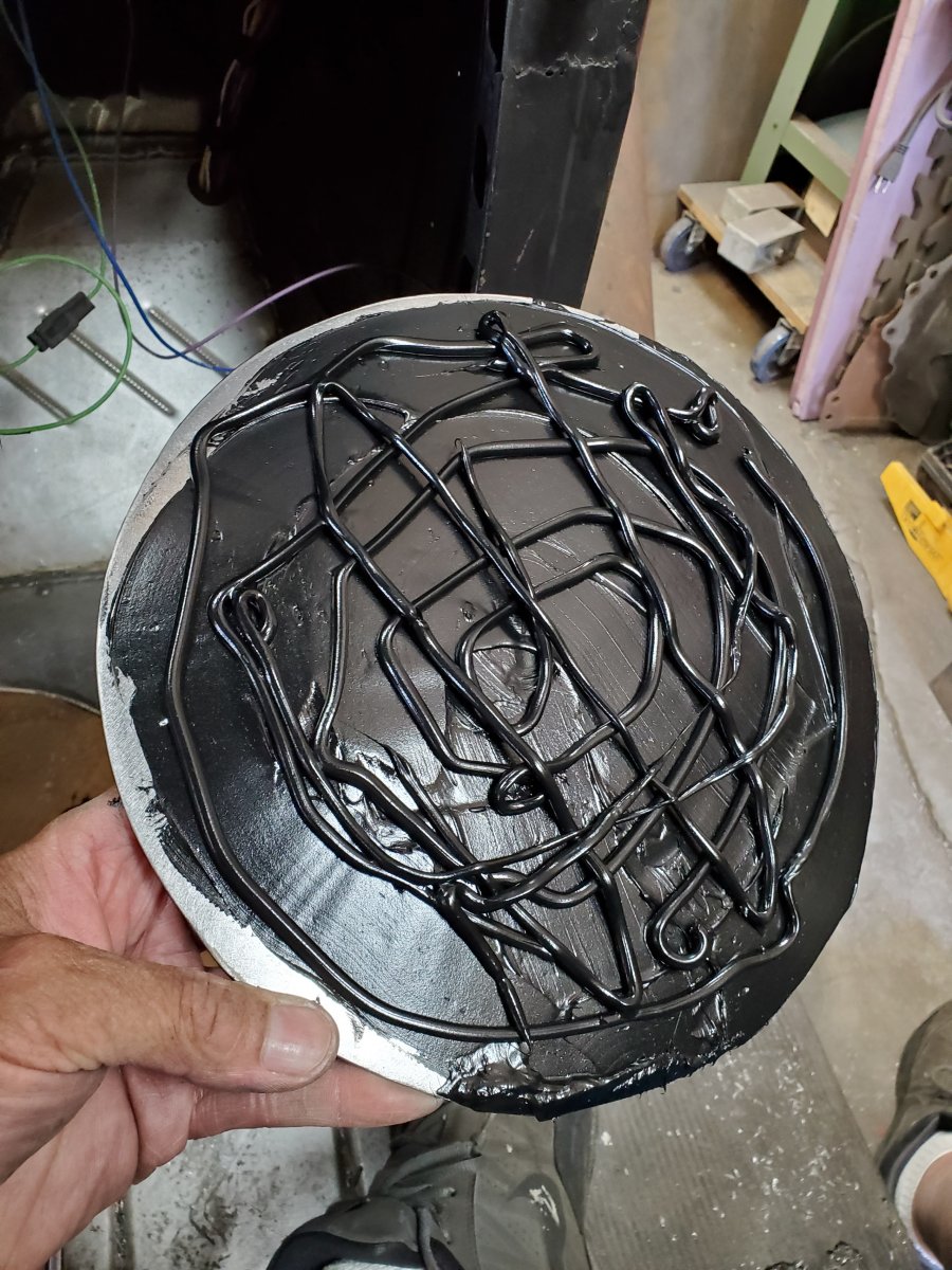

    Back at it. It's prepped and ready for frosting except for to soft spots. I've tried a couple times to tighten these areas up but only managed to turn them into sink holes. I decided to glue these two patches underneath. My thinking is that two layers of steel will be much stiffer than the one. Figure I got nothing to loose.

    sometimes an over shrunk area can act like an area that needs shrunk.
    try just hammer and dolly work on that area an see if it changes

    Understood. I tried that twice but ended up with the same result. I believe if I had put more crown in it with the English wheel I would have avoided this problem. Lesson learned ;)

    Works like a charm :) . Lots of adhesive. Lots of pushing up. Lots of turning/twisting/pressing. 20200718_143430.jpg 20200718_144320.jpg
