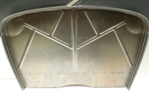

  16. Mo rust
    Joined: Mar 11, 2012
    Posts: 532
    Mo rust
    One of these 32 style flat firewalls would probably work pretty well as long as you support the front cowl corners inside it.

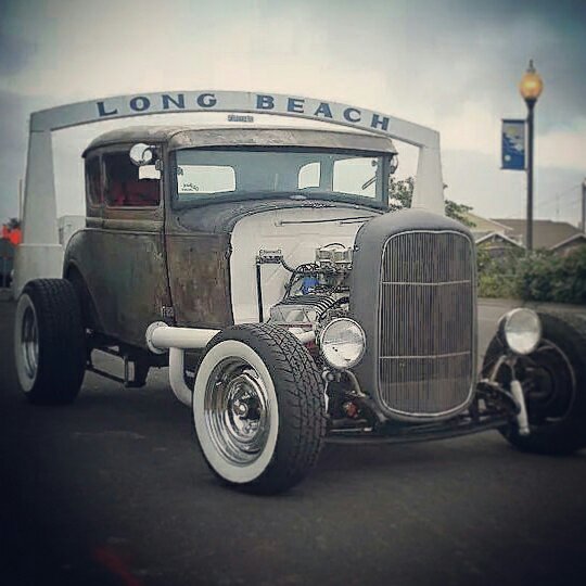

  23. When I get around to my coupe I will either flip it or do like Mo Rust did here.

  28. skreemin
    Joined: Feb 24, 2006
    Posts: 146
    skreemin
    from Salem Or
    Thank you! Those pics are a couple years old. It's currently torn down so i can paint it...2 summers ago! Haha!
