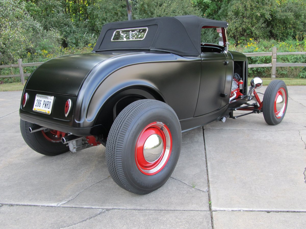

    Rears are 7:50x16s on 6" rims, fronts are 5:00/5:25x16s on 5" rims. Tires are Firestone Deluxe Champions.

    Looks great. I am running the same tires and rims on the front too. Are your rears Vintique series 14 rims ?

    The wheels were made by Stockton back in the early 2000s during the build of my '32. The company fell on hard times later, but may still be in business, although their web site is dated 2011.

    Hi. That 6" wheel in your photo really gives it a great fat tire look and effect for the rear. I prefer the 4" - 4.5" front wheels with the narrow tires for easier steering but the 5" ones are still great for there. Jimmie
