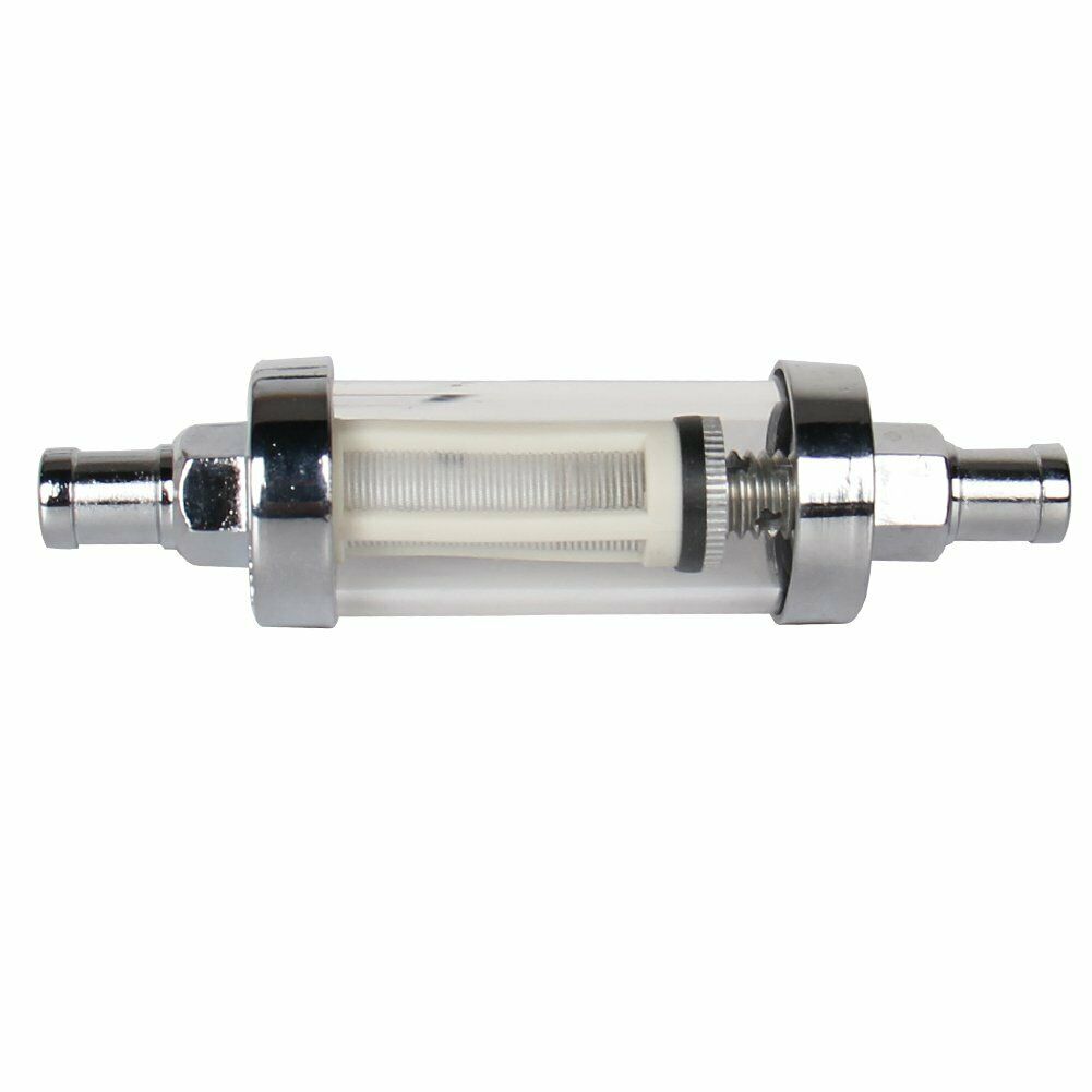

    Have never had a problem with glass bowl fuel filters. Hundreds of thousands of miles on 1950's and 1960's vehicles. Thousands of hours with tractors. I have never used one of the new aftermarket versions pictured in this thread.

    The other thing is plastic fuel filters too close to block or exhaust.
    Or as mentioned those groovy glass filters.

    It's called a sediment bulb LoL

    And has sealed well since time
