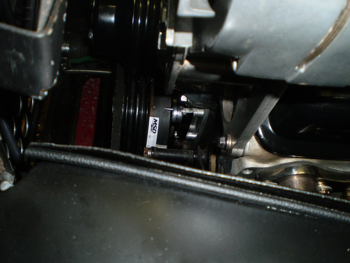

    im anxious to get the timing set once and for all.we tried strobing it but those chrome timing pointers are stupid pieces of crap .too much reflection.i took it off timing pointer 002.JPG timing pointer 005.JPG sanded it and painted it .the paint wont stay on long .i tried to mount the adjustable pointer but it will need some spacers .the timing cover is cast aluminum and not flat around the mounting flange it is counterbored around the mounting screws approx 11mm diameter .some 10mm diameter spacers should sort out the issue on a permanent basis.trial run shown with a stack of 6mm washers .

  17. Leakie
    Joined: Nov 10, 2010
    Posts: 271
    Leakie
    You know what they say, “chrome won’t get you home” or in your case it won’t get you 3 degrees before TDC.

    collected the temporary spacers for mockup (unchromed) will offer them up tomorrow. thanx mick

    from IRELAND
    offered up the 10x10mm spacers for a look added 3/ m6 washers on each allen bolt for a total of 13.5mm.texted my guy with the new measurements should have them in a few days.this pointer was a PITA to set up but i think its worth the trouble in the long run.the spacers are a bit fiddly ive droped one more than once .thinking of sticking spacers to the bracket for a easy fit.also had to file a little off the tip of the underside of the bracket to clear the bulge in the cover

    collected the stainless spacers long after T time due for fitting in the morning.not so sure about the white timing tape black might have been better.time will tell.

    sprayed the bare aluminum on the pointer fitted the new spacers loctited the screws .happy with the result .then fitted the gaiter around the shifter.on last spin there was a lot of hot air coming in where the shifter gaiter was missing.really uncomfortable so i fitted that today dont know why it took me so long to get around to doing it. might be cooler and quieter in the cab now

    finally got the timing set .it was running very advanced ,how was it running at all.its now 11* TRANSFORMED running happier and more responsive hopefully more economical too.starting first tip.yippee
