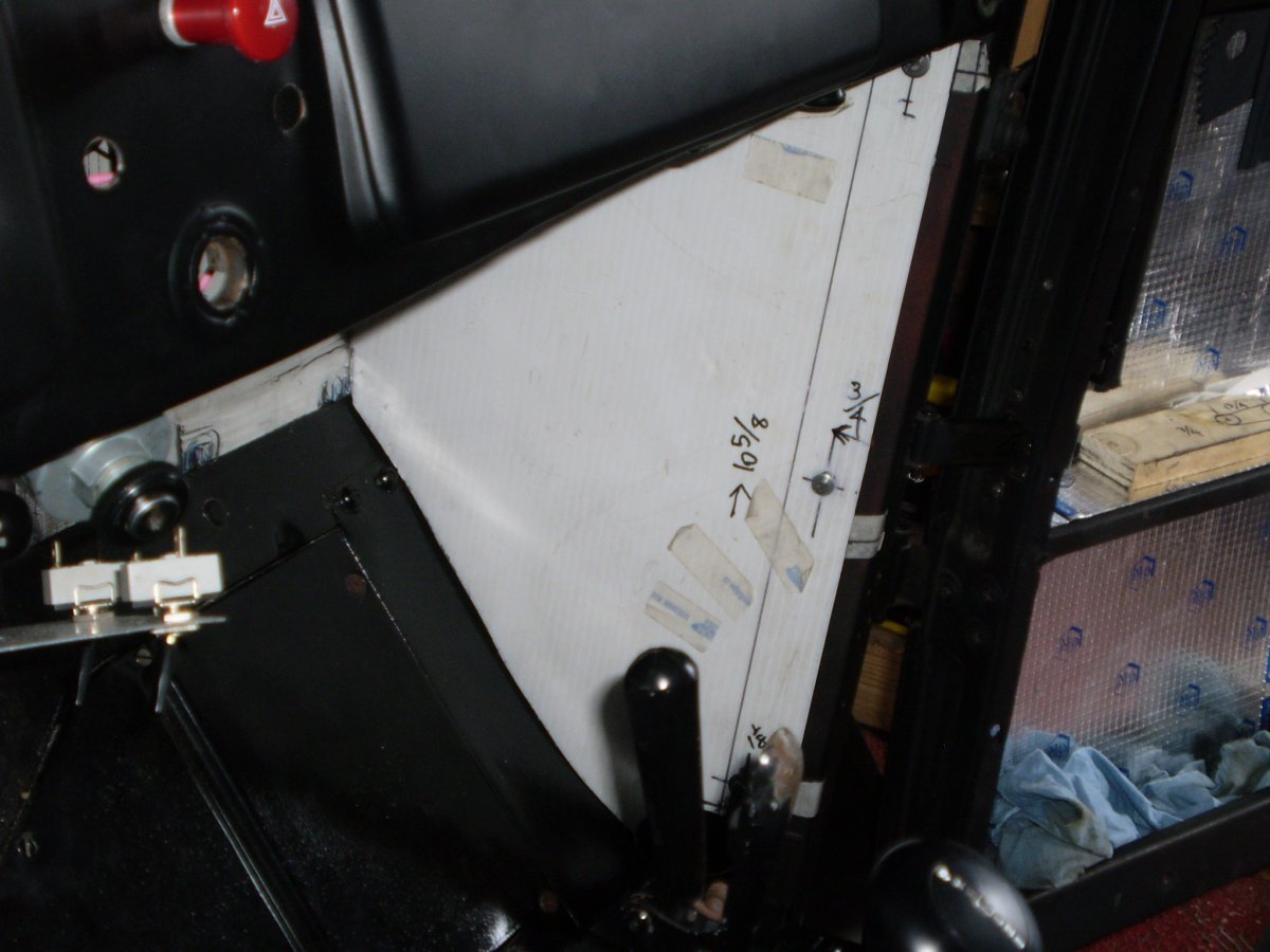

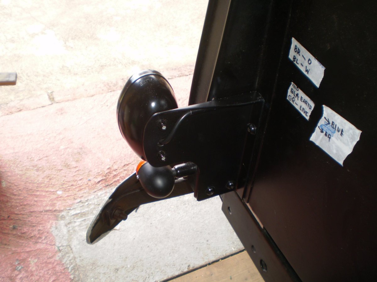

    toe boards cowl and window winder nuts 033.JPG toe boards cowl and window winder nuts 036.JPG toe boards cowl and window winder nuts 034.JPG toe boards cowl and window winder nuts 035.JPG cameras back.been busy ,cutting cards for the side of the cowl.ill be covering them with black vinyl and insulating the backs.wired the taillights /indicators keeping the wiring out of sight with the connections under the floorboard.working on fitting the windscreen winder .getting the winder shaft central in the dash opening..decided to cut some captive nuts that cant rotate in the dash but will allow me to adjust them up/down ,left right.one end is 1" diameter the other 3/4 at 1 5/8 centres.the 3/4 end is drilled and tapped 1/4 unc.cut from 8mm alloy.1 done 1 to do.

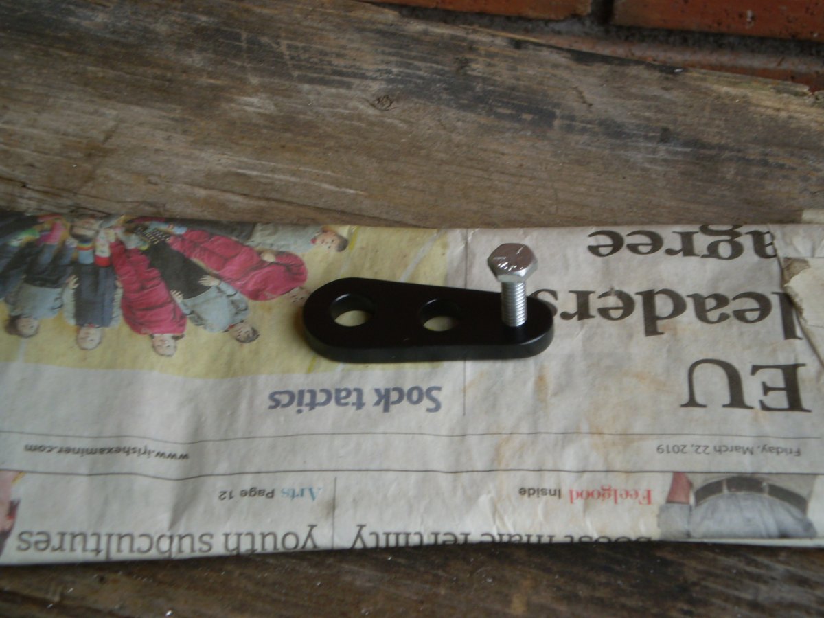

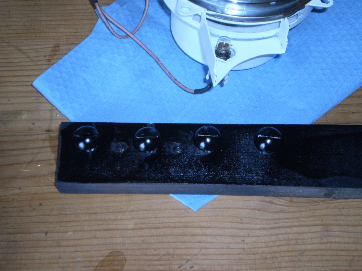

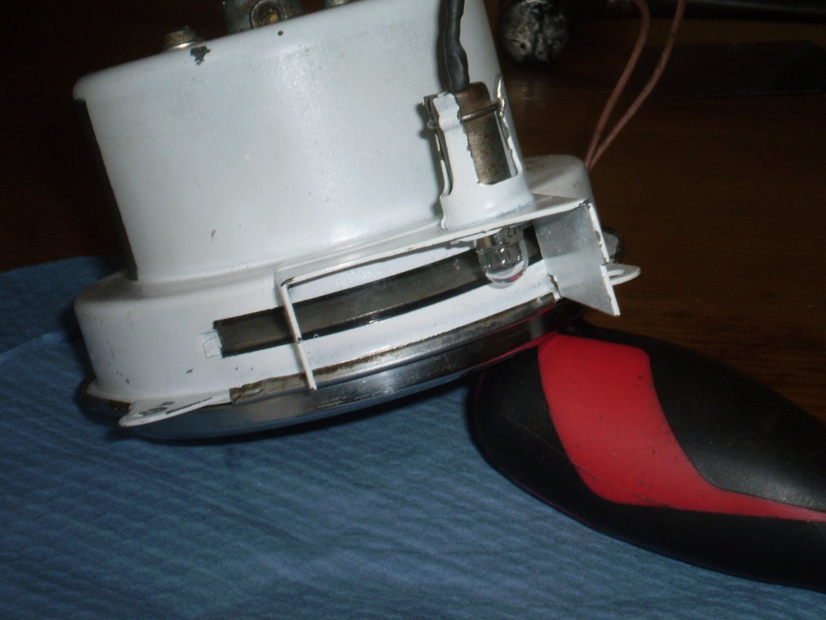

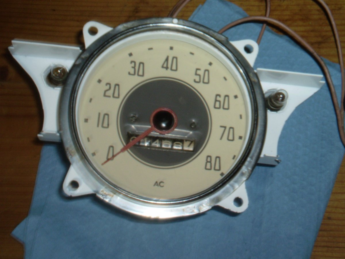

    the next issue popped up straight away .noticed I had the glass in the speedo inside out.couldnt be looking at it.opened the gauge up and sorted it out.first pic is the (be cool)windows painted the speedo white to reflect the light into the gauges. gauge windows reverse glass 001.JPG gauge windows reverse glass 002.JPG there is little need to bend the chrome strip around the glass.its trapped between the body of the gauge and the dash when its bolted in.

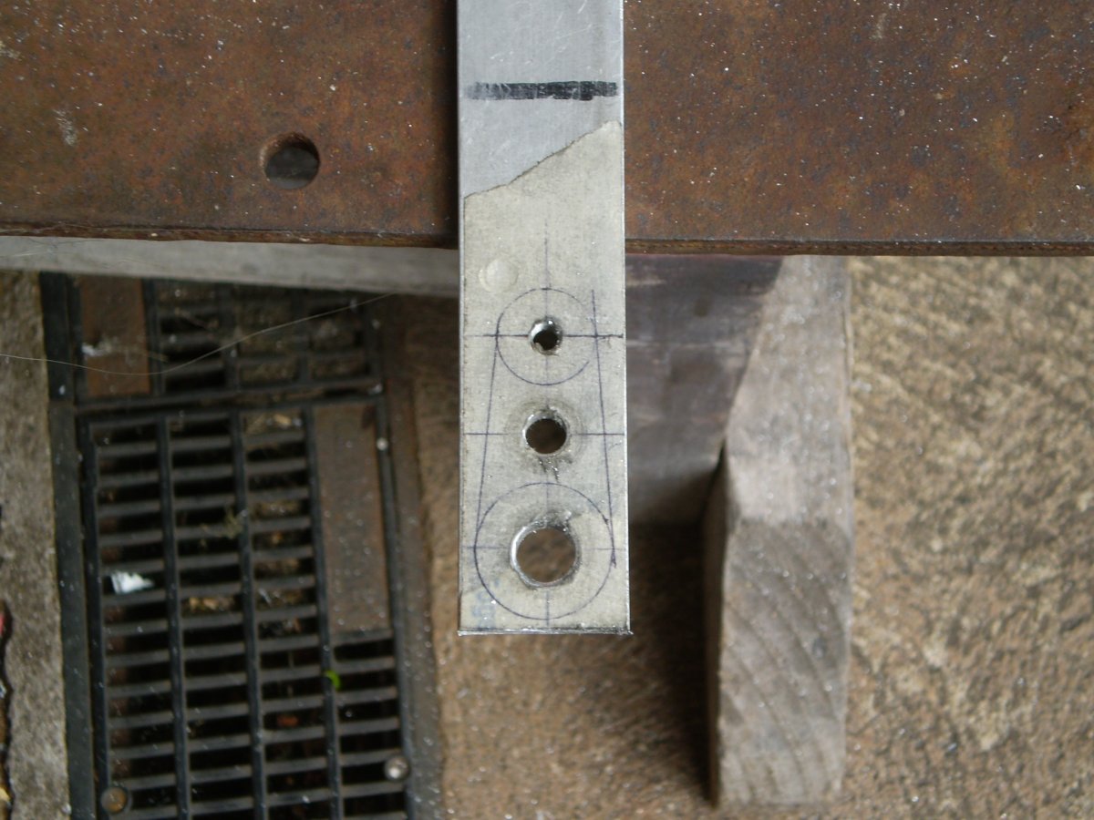

    working on a few different jobs at the same time again.no pics camera battery on the way out.spent a good while on the seat belt mount slow work and tedious cutting and shaping rolled 5mm steel.first one is close the second one will be quicker.used off cuts to insulate the back of dash.made a bkt to stop the wiper switch from rotating while tightening it/painted /drilled /and araldited it to the back of the dash.finished insulating the drivers door.used 2 layers of 2mm foil backed then added 6mm foam heat insulation.extra weight helped the door close firmly and sounds quality.packed the door lock and window winder cavitys with grease.should really have added a grease nipple to the door locks.a while back when I opened them up I found the workings dry and broken return springs.sourced new springs local and added bushings where possible..if /when I come across some other locks I will add grease nipples and make them serviceable.currently the lock halfs are opened by bending a tab.eventually the tab will break.plan is to add a bushing and hold it together with screws.offering unlimited access.when I got the truck the lockrail was well out of shape..its approx. 4"x1/4" u section.straightened it on a shrinker/stretcher and welded a crack midway.i felt it would bend again so I added some 1/4" x 1 1/4" alloy to strengthen it.drilled and tapped 3mm countersunk screws to hold it in place and also used ARALDITE 2 pac adhesive to keep it straight .filled the remaining space in the U with 6mm foam insulation.getting there slowly but surely

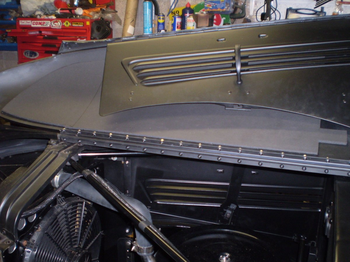

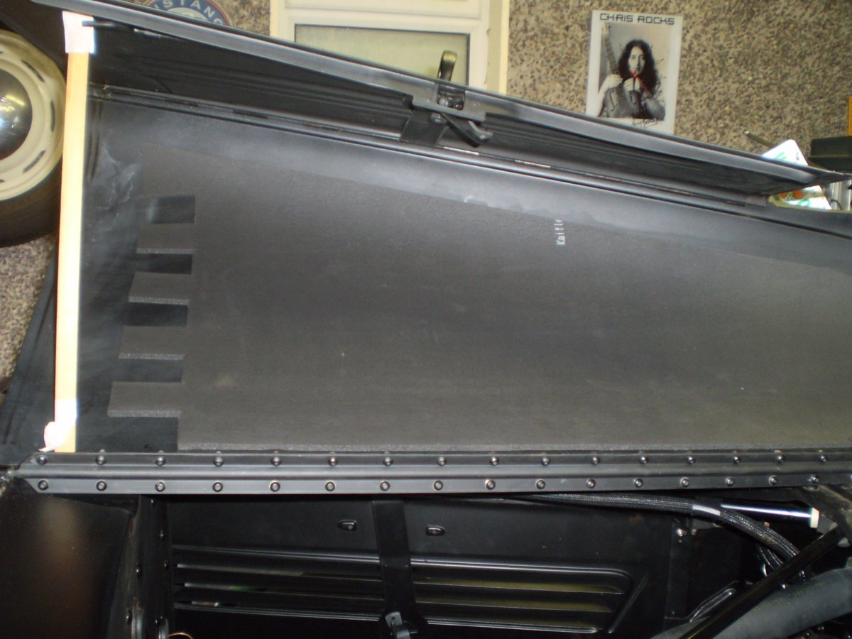

    nderhood insulation 001.JPG great stretch in the evenings at the moment.bright till after 6pm.trying to make a move on the chevy.today I cut some underhood insulation.6mm foam.be sticking it under the hood.be leaving it run over the cowl to cushion it and keep it quiet.stepped the edge so it wont seal the heat in

    nderhood insulation 002.JPG be fitting them tomorrow when I have some help.tricky business fitting it upside down

    I cut the non stik backing into 2" strips and pealed them off 1 at a time so it wouldn't stick on wrong.it worked ..the foam doesn't work as well as the foil but its way lighter

    second side done.would be much easier to do with the hood off and on a table,spare pair of hands would help too.

    these tabs worked great.allowed me to make a quick adjustment to the windscreen winder assembly while the dash was balancing on hot rod girls knees.[​IMG]
