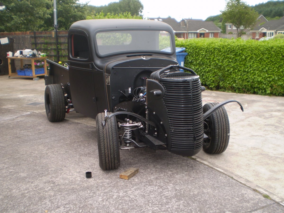

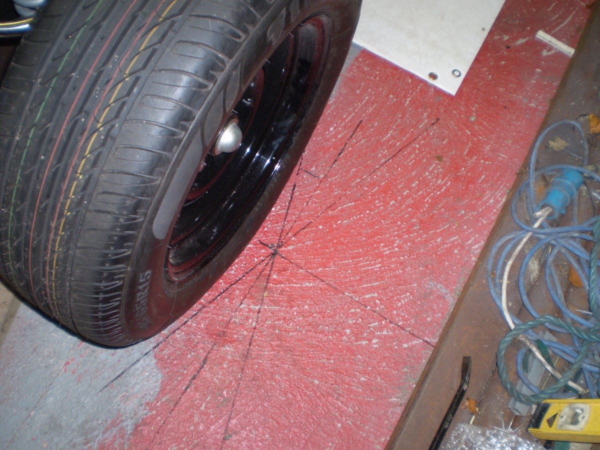

    shim pack 3 002.JPG moved on to aligning the front end .aiming for 4 degrees negative castor 0 degrees camber 1/8 total toe front.drilled and wired the shim pack used ARP bolts and locknuts.got my own stainless shims cut id recommend many thin shims over less rigid thicker shims will conform much easier

    nice to learn something new especially when it works out .
    CAMBER= -1/2 degrees
    CASTOR= 4 degrees
    TOTAL TOE =1/8 in alignment finished 001.JPG

    filler cap stage 1 002.JPG filler cap stage 1 001.JPG moving on to the petrol filler cap situation.day 1 stage 1

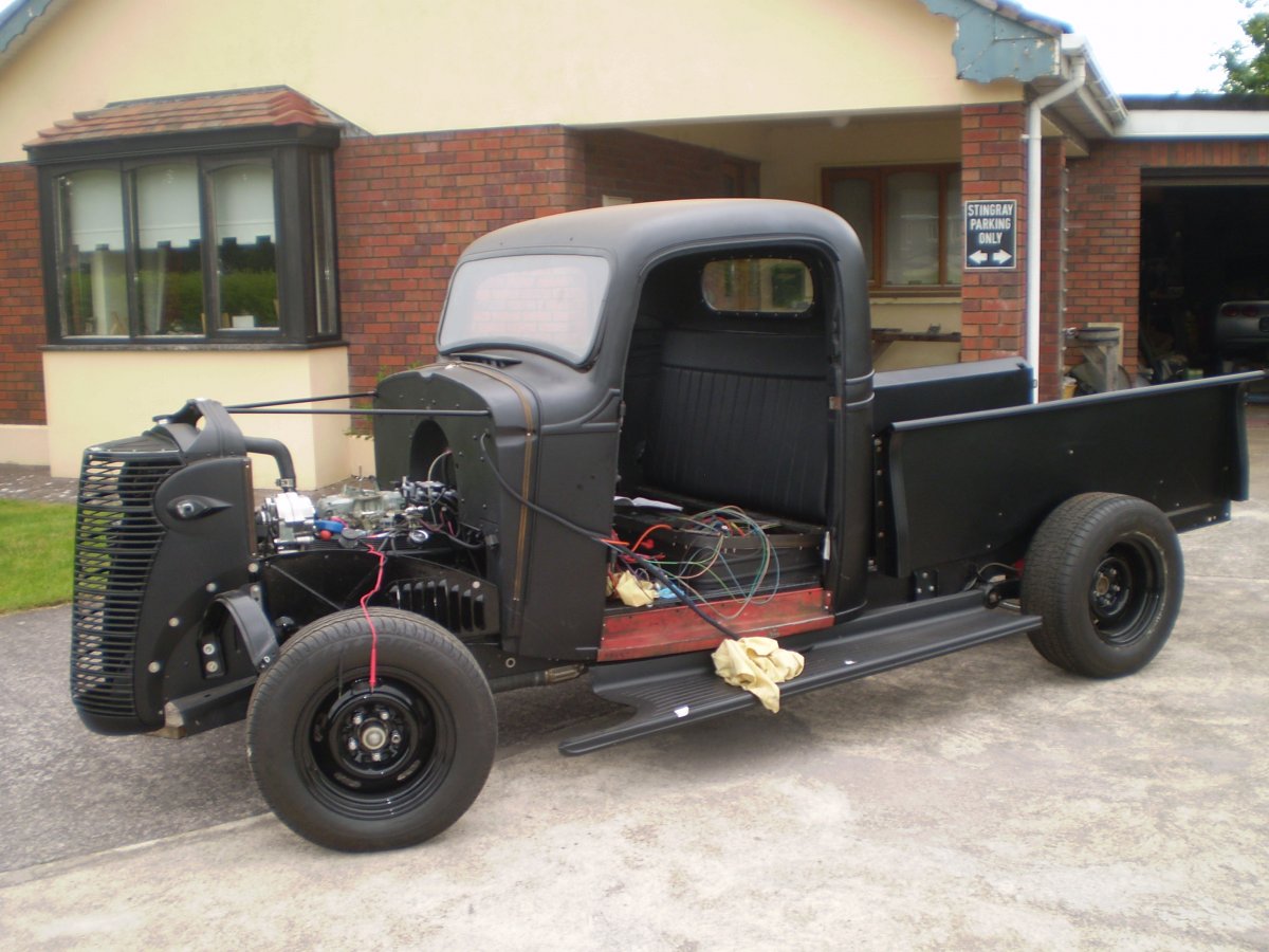

    START UP FIRST ATTEMPT 18-06-18 001.JPG START UP FIRST ATTEMPT 18-06-18 002.JPG made first attempt to fire her up today but no happy ending so far.no spark and no fuel pressure.seven years since the motor ran so some casualties expected.full 14 volts to the dizzy and fuel at the petrol pump.no spark,no fuel pressure.pump diaphragm is the suspect need tofault check the dizzy to mor.push it out into the sunshine,nothing caught fire,no fuses blown,no leaks ,good oil pressure on the starter only a matter of time before it runs,looking forward to hearing it run.sheetmetal is all painted and ready to go except the cills .lots easier to fault find without the wings in the way

    well another day down.cleaned the holley fuel punp liberally sprayed wd 40.and scrope the rust from the one way valves.pump is putting out 6 PSI now,nearly bought another.Ciarain saved the day good job bud.
    no spark situation is still the same -no spark.tested the coil,not good .borrowed another hei in the hope of swapping out some parts but that was crocked as well.ill order parts this evening.nearly there.

    big day today 4 july distributor parts arrived from summit took 12 days to arrive .rotor,cap and coil,plus module .fired right up great to hear it running again.fuck its loud.its not running right.stripped out the carb .its full of crud.major rebuild kit needed new gaskets anyway and a few new jets..idle mixtures need to be dialled in and timing set.
    ive a set of comp cams roller tipprd rockers to fit as well.
    it was very hot today 31 c so we hot wired the spal fan.sparks due on Friday to do a shift.
    wire the fan up correctly is top of the list
    good to be making progress.many thanx to ciarain for getting it running top job.
