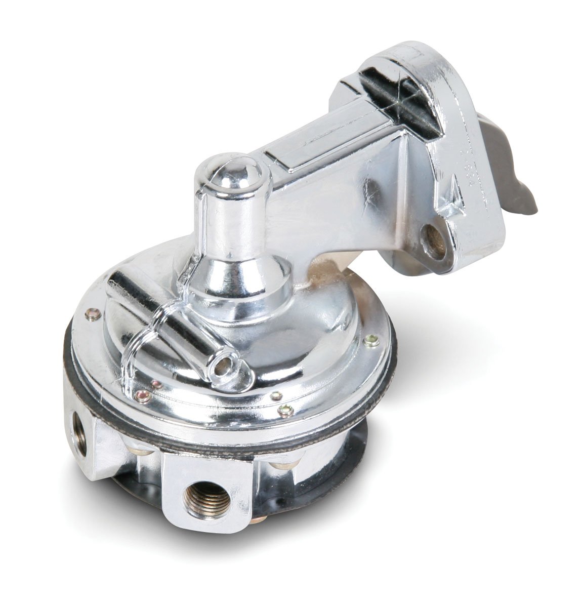

  10. my '58 Vette has a built 327 and uses a Holley pump that looks like an original screw together style like you posted. As phat rat says you can remove the screws and clock the outlet to your needed position.
    Here's the one I have Holley part #12-834
