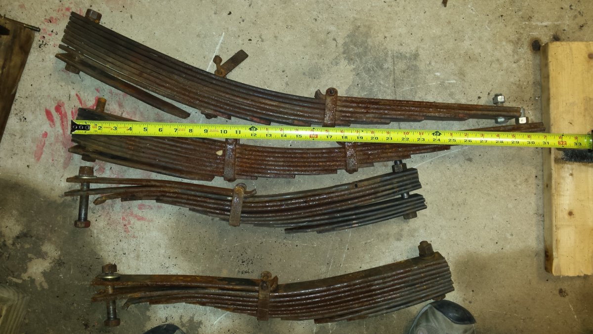

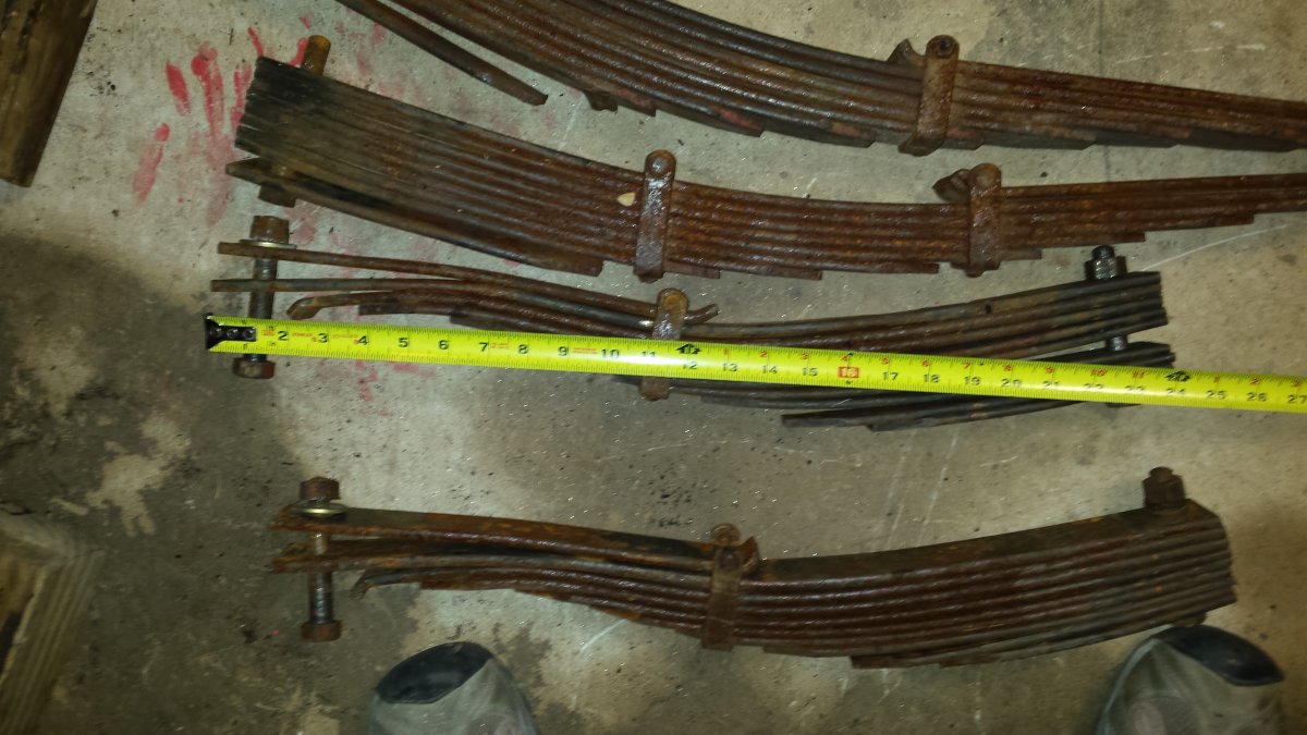

  7. Okay, my pc won't let me download the pics- will try to find some on the net and share them. One thing to understand is that there are no eyes on these springs; they are flat on both ends with a hole through each end to mount them in the spring pockets and on the axles.
    Also, the front springs are 1 3/4" wide... and the rear are 2" wide- shame on me for assuming that front and rear were the same width...
  8. Gotta love the guys on MTFCA- someone posted some 490 chassis pics on coaltown kid's (man I miss him being on the HAMB) thread about his 20's sprinter!
    Here are the pics:
  9. Just needed to upload an Adobe update- here are my pics:
  10. I can see why those would be too stiff! I'd remove what leaves possible with the way they are made. Slick them up and separate them with some sort of plastic sheet. Of course this is as old as the hills method but it does work. Worth a try.
  11. Let's put it this way- if I step onto the rear bumper of a modern pickup with leaf springs, my 240lbs will lower things about 4-6 inches.
    When I stood on the chassis of the 490, nothing moved... even when I hopped up and down on the front or rear crossmember.
