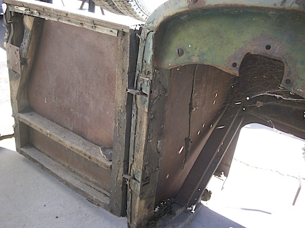

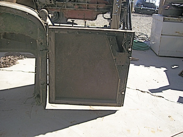

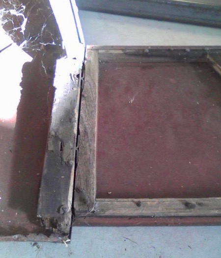

  11. CRAIG ADAMS
    Joined: Jan 6, 2023
    Posts: 25
    CRAIG ADAMS
  12. CRAIG ADAMS
    Joined: Jan 6, 2023
    Posts: 25
    CRAIG ADAMS
    At least it's not Ford, or fiberglass like my current body. And you have to start somewhere!

    That one is pretty rough for sure but not beyond repair. I used to know where there were two nice cowls. I haven't seen or heard from one of the guys in a few years. Considering getting one because mine has some rust along the bottom.
    I'm sticking with the wood at least until I give it an honest try. The wood is amazingly strong and a bit flexible. I figure if I get in a crash in a roadster I'll be toast anyway.
    All I have is on this site. There is no file. We have only worked on one part in the cabinet shop. Hope to get back on it soon. It has been crazy here for the last few months. It take a lot just to live here. I need a few ranch hands but don't have a bunk house. :rolleyes:
    I'd like to see what you come up with for your 8 port head.

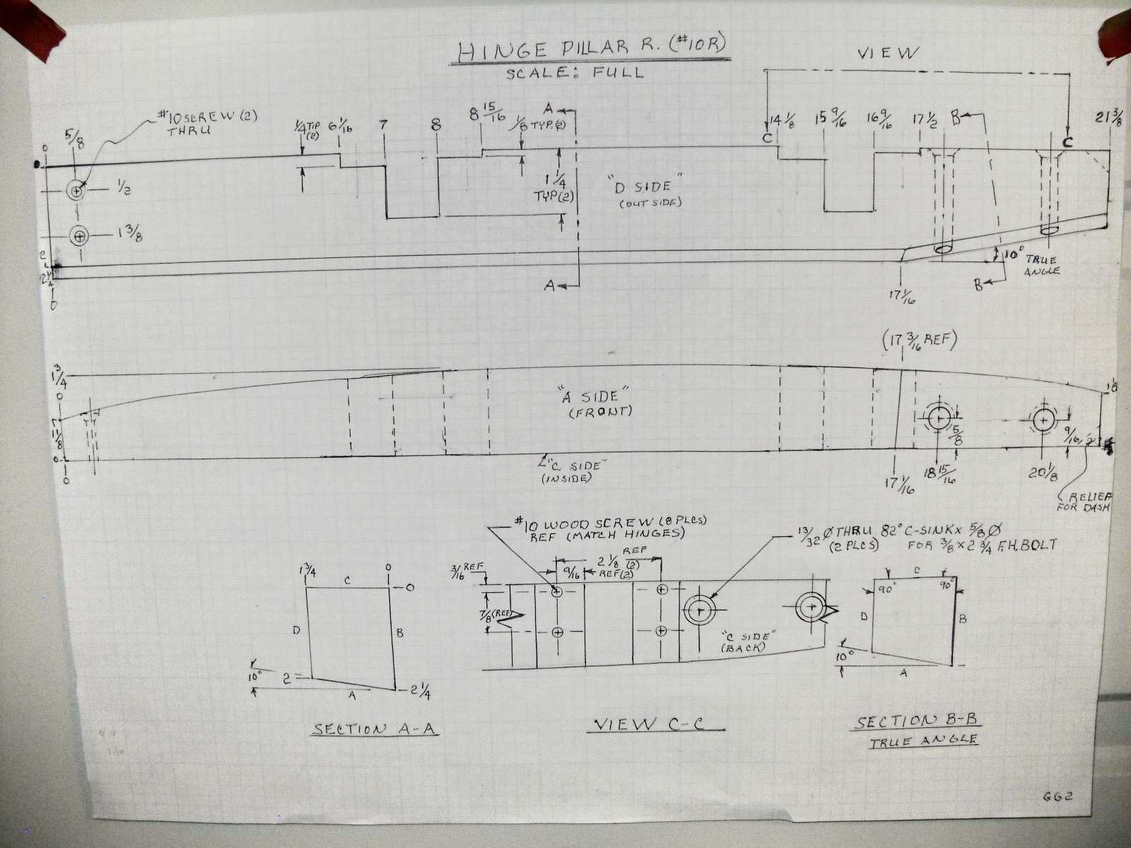

  22. mlagusis
    Joined: Oct 11, 2009
    Posts: 1,130
    mlagusis
    Do you happen to be a steel detailer by trade?

  25. mlagusis
    Posts: 1,130
    mlagusis
    haha! Your drawing/sketch in one of the post's looked a something a good steel detailer would have produced.

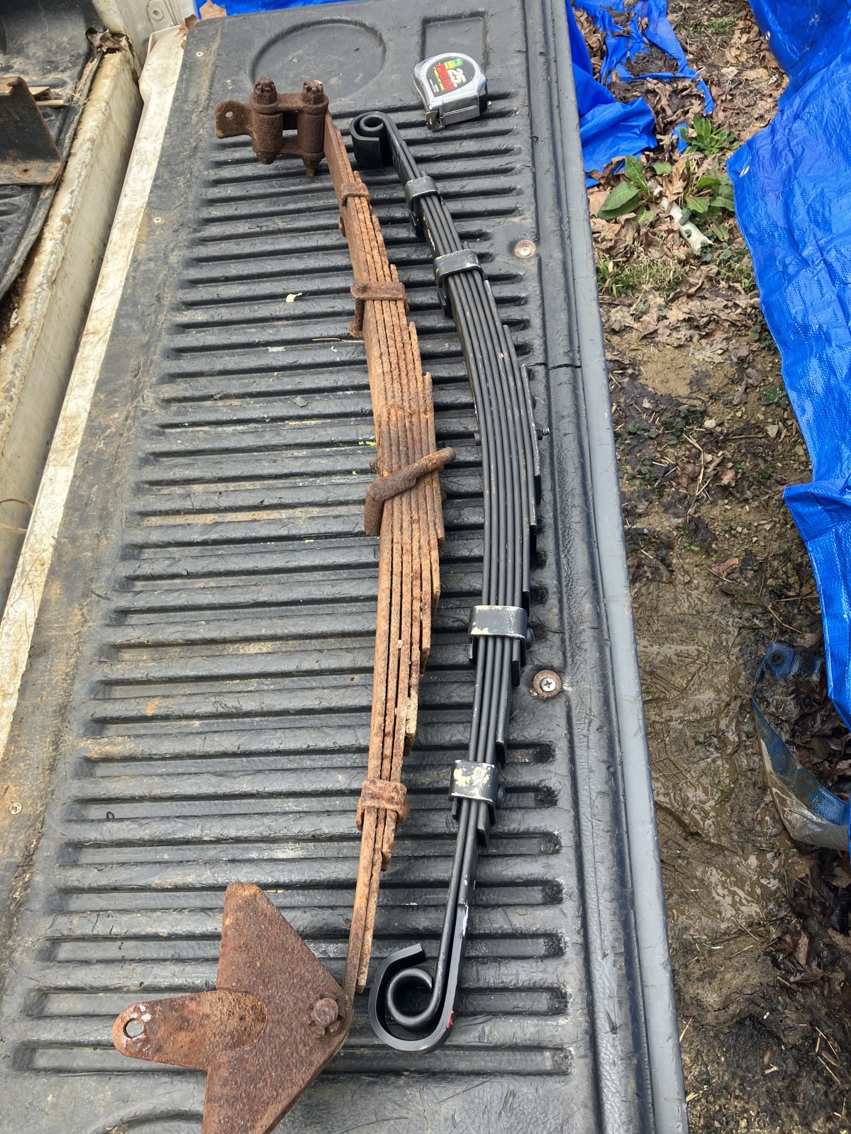

  28. chevspeeder
    Joined: Dec 13, 2023
    Posts: 16
    chevspeeder
    The new springs came today. They are the right length. If I throw away the smallest leave, the rest of the leaves match up within an half inch or less, except the 2nd leaf which will need to have the ends cut off. The new ones have a little more arch, but they are new. The only issue is they do not have bushings in the end, which isn’t an issue except one eye is slightly larger. Worst case, I might have to make some bushings on the lathe. IMG_4428.jpeg

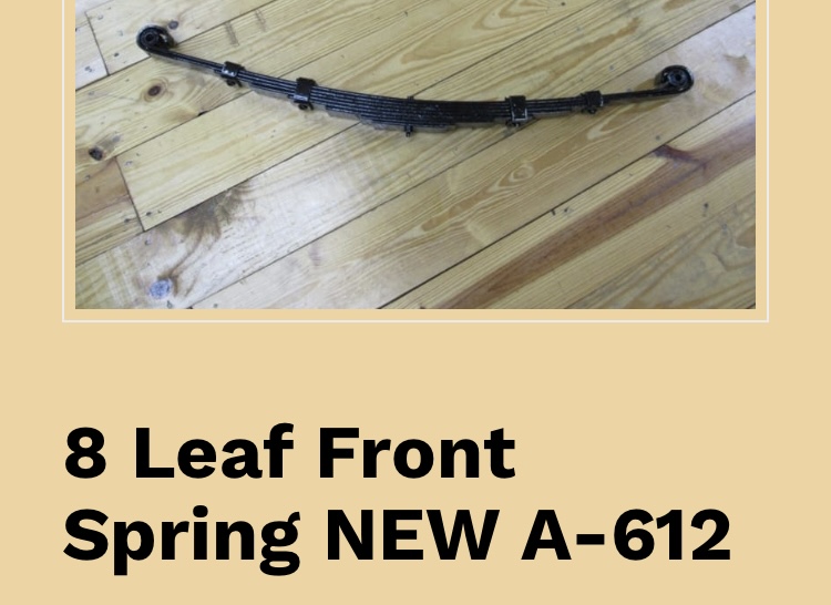

    Man, I'm sold! That is a great find & price. What year & model Jeep? It's worth $110 each just to not have to disassemble & clean up the old ones. Do you have a full length comparison photo?
    Stogy, patmanta and Outback like this.
  30. chevspeeder
    Posts: 16
    chevspeeder
    I ordered 8 leaf front springs for a 1941 Willys CJ2A Jeep. They are the same for a few models/years. Omix brand number 18201.01. I paid $95.09 each with free shipping from ebay. The spring industry number is A612. Several vendors list them. I found some cheaper but they were out of stock. I haven’t figured out the bushings for the eyes yet, as one end was set up for a rubber bushing, and consequently one eye is a little bigger than the other, but I am convinced there are some brass bushings out there that will work. I will share the info on the bushings when I find them. If you lay the new spring on top of the old one it is about 1/2 inch shorter, but I think it is because the new spring has more “crown”. Except for the end wrap on the second leaf and the little eighth leaf, they are almost the same. Leaf thickness looks the same as well. If you zoom in and see how rusty that spring is, then you understand why I ordered them. One thing though, the ends of the ends are straight cut and the clips are a little different, so if you are going for originality you will have to do more work. I will be happy if I get mine going period, I will keep it original as is reasonable.
