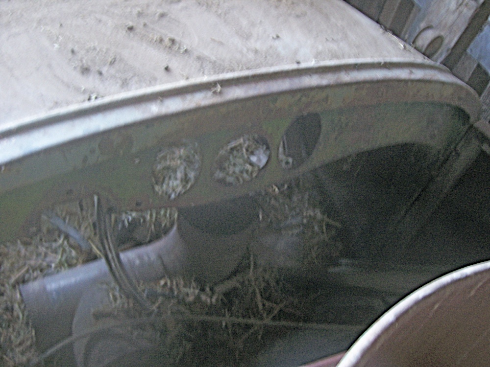

    After high school in '63 I was working part time at a Montgomery Wards auto center and going to JC. Still driving the '38 and a '40 Chevy Pickup. I came across a '25 Chevy roadster that was an circle track car. It was in pretty good shape but I could not afford the $125 the guy wanted for it. That included a 153 Chevy 4 cylinder the guy was building. Pretty new stuff back then. I had to pass up a straight running $100 '40 Ford Woody once because I had just bought a $75 very straight '40 Ford sedan delivery. Prices were low but so were wages. Cars were everywhere!

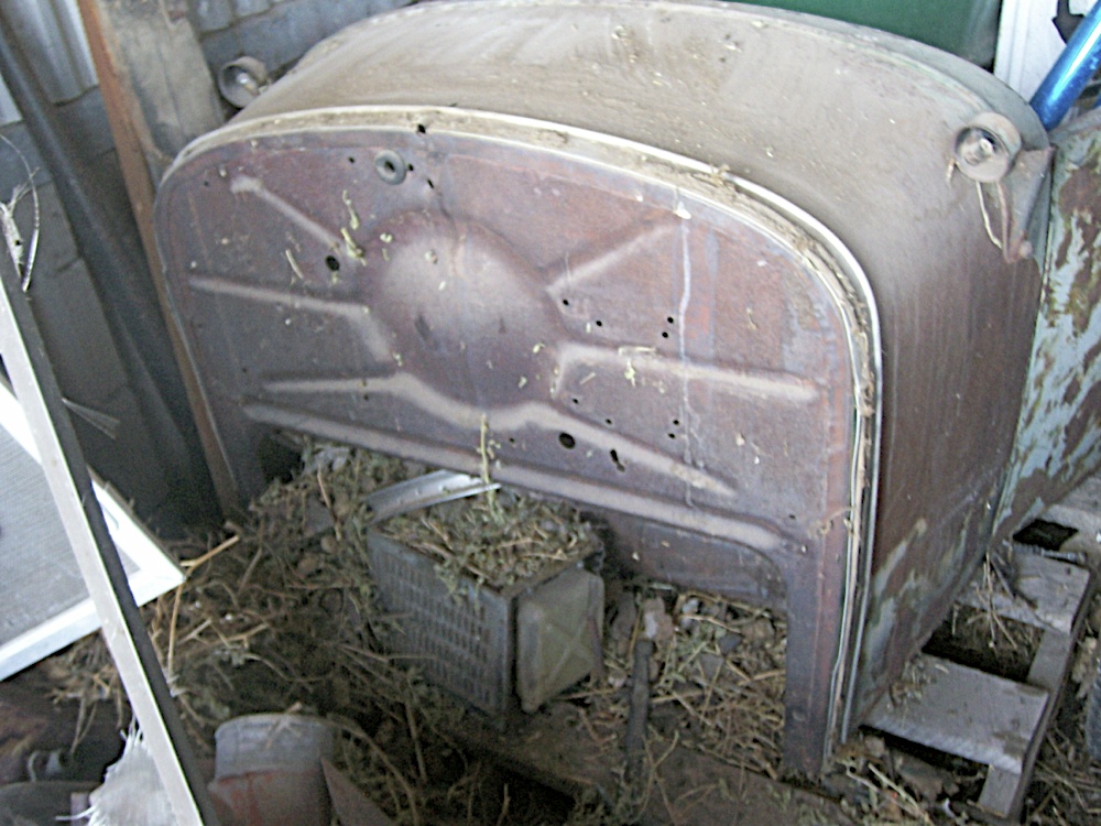

    So several years ago I was able to buy a very complete '26 Chevy roadster body that had come out of the Bill Harrah collection when it was sold. It sat around a while and I started gathering parts. I have always liked the looks of the early versions of the Spurgin/Giovanine roadster. I don't want to copy anything but I'm thinking of building this like I might have rebuilt that '25 in the early to mid '60s. It will retain the parallel leaf front springs and have a 4 link with 1/4 elliptics on the rear.

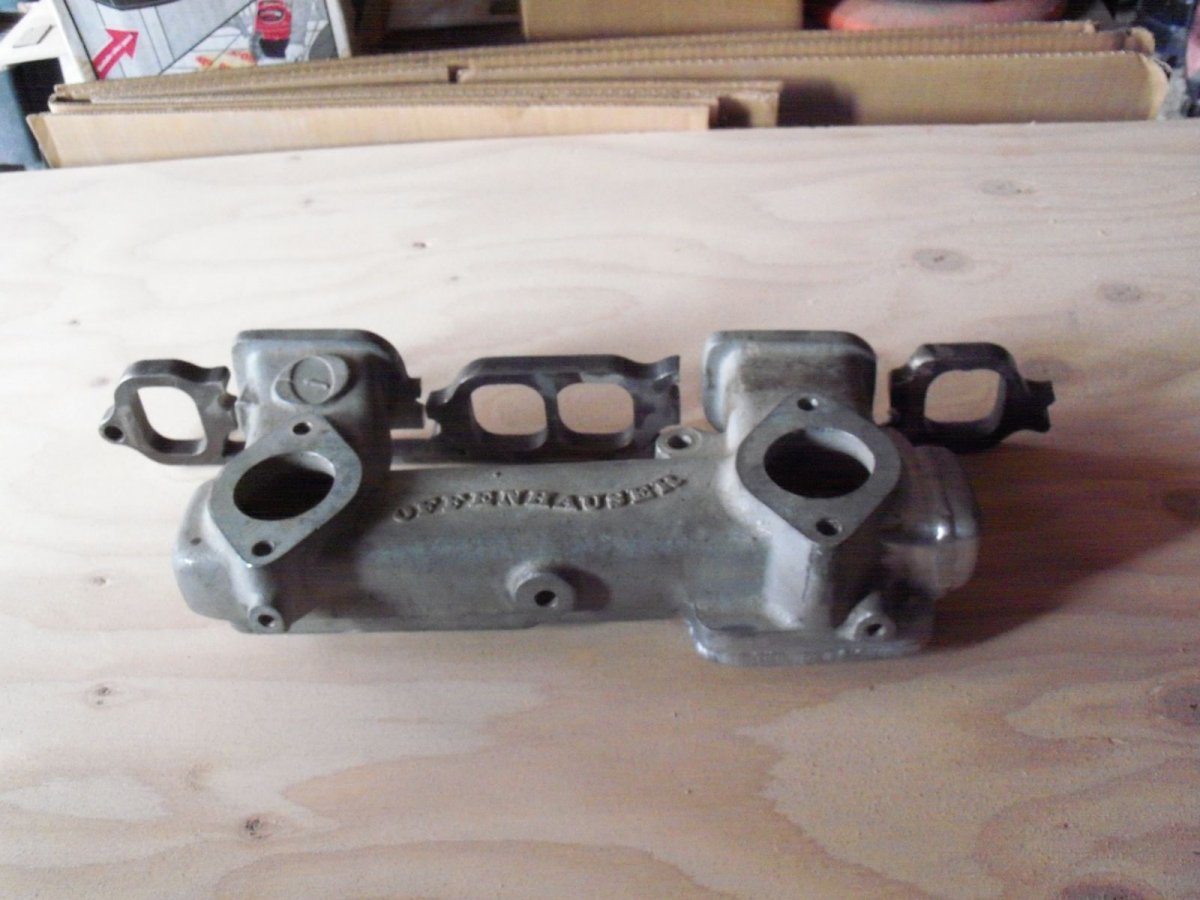

    Besides the body there is a .040 over 153 Chevy four in pieces. Pieces include a 181 crank & rods, .040 forged Ross pistons, head with lumps, screw in studs, roller rockers, 1.84" intakes, 1.60" exhaust shaved .030" 70cc chambers. There is a custom ground Erson cam, a modified Offenhauser 2X1 intake, two Zenith down draft single barrels, a modified Fenton Black Widow SBC header, a modified Mallory Pontiac V8 Dual Life distributer with the old 2 piece cap. There is a custom rocker cover in the works. There is a Borg Warner T-86 three speed OD soon to have a floor shift top plate from a T-90 from a Jeep. I have a Dana 44 limited slip from a GMC with 4.27-1 gears from a '54 Studebaker wagon. There is a complete dash panel with SW gauges from a '55 Studebaker Speedster and a '47 Chevy 1/2 ton front axle. There's a couple of '20s radiator shells and one good honeycomb radiator. Also there is '30s Oliver tractor nose piece and a stainless grill insert from a '30s Dodge or Plymouth. I have a '25 Chevy frame and hood. I have a set of 19" Chevy 6 lug wire spokes and tires to go on them. Plus lots of other little stuff lights, windshield, jeep steering box………

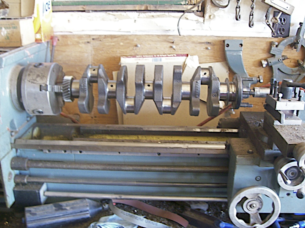

    Thanks Scott. Baby steps, today I drilled and tapped the crank snout. Things were not going well this morning so I did an unusual thing for me. I quit before I really screwed it up and came back later and it came out just fine. While regaining control I sorted drill bits (never found the 25/64) and found most of the parts needed. I'm using the engine assembly to also clean the shop under the assumption that an assembled engine takes up less space than if it's pieces are scattered all over. If that proves to be true I'll test the theory on the transmission next.

    I started with just the body. Bill Anderson who built the Ponderosa Ranch of TV fame at Lake Tahoe also had land in Dayton, NV where the livestock from the TV ranch/tourist spot spent the winter. Little Joe's pinto and the rest. Bill was a collector of all kinds of stuff, lots of antique cars and parts, much of which was stored in Dayton too. Some still is. When the Bill Harrah car collection was sold a lot of stuff found it's way the Anderson's property. I looked at this roadster body sitting on the lot for several years. It had a price of $1,200 on it and he wouldn't budge. One day it was gone. About 5 years later a guy wanted some V8 60 blocks I had so I asked what he had to trade. He showed me the long lost roadster body and a '40 ford rear end. I gave him the 3 rusty blocks and a little cash for the body and the rear end. The blocks were given to me by an old racer. One had a Clay Smith cam. That was at least twenty years ago. I've been building this in my head and gathering parts ever sense. It's time.

    I'm working on getting the engine together. I got the crank snout drilled and tapped. I drilled and tapped two holes in the crank timing gear for removal if needed and got it pressed on. The freeze plugs are in. The Mains are in and plastaguaged, It is tight with standard bearings but turns freely with a little effort. End play is right on the money at 0.006" I had the wrong rear main seal. The right one will be here tomorrow. I didn't know that '62-'67 was a different rear seal than '68-'70. I hope to get the rods and pistons in Wednesday. I read that in the early 181 #2 rod had a notch in it to clear the fuel pump lobe on the cam. None of my 181 rods have a notch. What I read said that if the rod is changed the cam had to be changed too. The fuel pump lobe in my Erson cam is a little thinner than the 153 cam. I may have to do a little cam grinding. I may use an electric fuel pump but the rod has to clear anyway. It's the most progress I've made in a long time.
