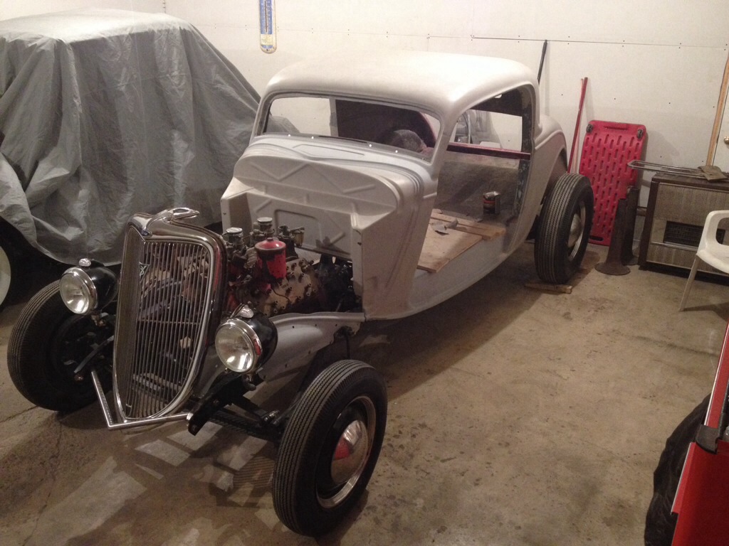

Projects finally got my long desired 34 3 window

    Never mind all that cosmetic shit Ben. Lol. You got those doors swinging yet.
    I'll get onto dragging those pics off to you.
  2. hotrodderhaag
    Joined: Jan 22, 2007
    Posts: 2,123
    hotrodderhaag
    Well........
    I'm trying to get the balls to dig into the doors... It's more of a project than I was imagining, the doors I mean .
    I wanted to line the shell with wood as an original car would be.. I don't think thats going to be possible. I have not seen enough glass cars inside to see how they have done it.. It's hard .
    This is the one thing I've decided i cannot do... I can build or fix anything, accept this door situation ... Makes me regret the choice of glass. Big time

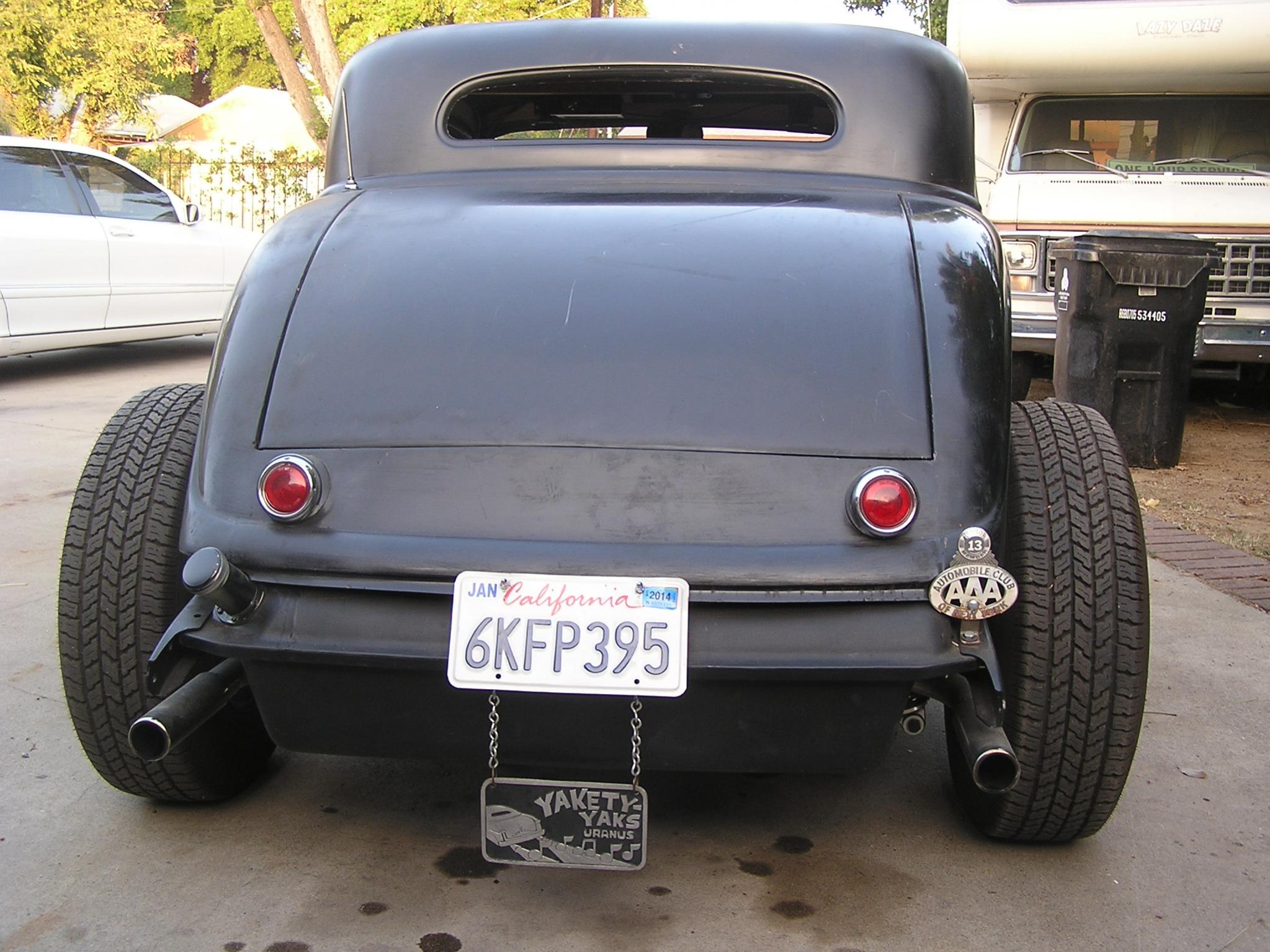

    Didn't do much today other than clean shop . I picked up an original working 34 column drop setup, and an original windshield crank. That will really help the original look... Need some thoughts on tail lights.... I was gonna run the usual bullet style 37 ford and have them on the frame rail sides.. Not 100 percent sure though. I'm also on the hunt for a decent set of old guide headlights . I really didn't want to get troops

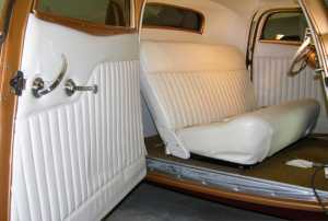

    I made all the wood templates for inside the car. My buddy who is an expert wood crafter is going to hand fit all the pieces in the car. That should make this build a breeze ... Once he is finished I can hang doors ImageUploadedByH.A.M.B.1383049828.946401.jpg

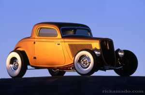

  18. I was just gonna suggest checking out JustplainJ's build on his glass '34,but he beat me to it. He did a fantastic job on building a Traditional style glass Hot Rod.
    This is us last year at Bonneville....
    Another awesome glass '34 was the one Pat Patton built a few years back. I'll post some pic's when I get home.

  19. Here's some pic's of Pat Patton's old Coupe...

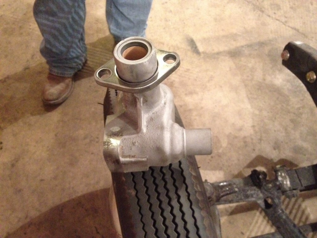

    hotrodderhaag

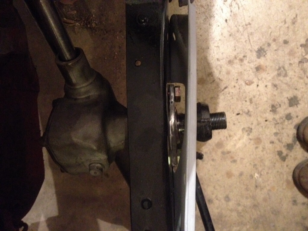

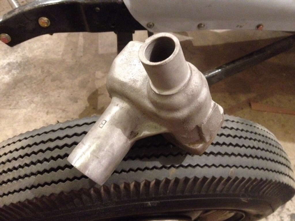

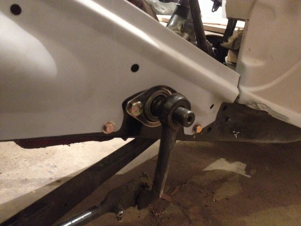

    Milled off the flange on the f1 box... Fit the plasma cut flanges on it. Threw it in the parts washer and then blasted it all . Cleaned it inside real well and now the box actually works good. My machinest is installing a new shaft in the worm gear so it's full length . I'll weld the flanges on and the steering will be done !

    I reassembled the steering box today. Works like new! Very smooth. Also I started messing with the dash. It needed some holes welded up that someone cut into it . Finished that up and that's about it for the day.

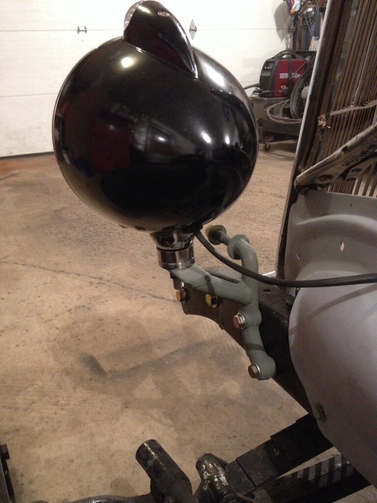

    I had an old set if f1 shock mounts laying around . The were in rough shape . The studs for the shocks were very pitted and not heads. So I milled them off flat. Bored a 1/2 hole in them, inserted a new stud and welded it in. Then I decided to shorten them a lot , also made brackets to hold the headlights from the left over parts of the towers. I'm not sold on the look yet... They may be taken back off and something else done.. Opinions anyone?

  30. ss34coupe
    Joined: May 13, 2007
    Posts: 4,177
    ss34coupe
    You are showing a lot of hot rod ingenuity! Great work on the front shock mounts.
