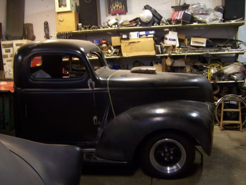

  13. I did one of those godawful PRO ST' scoops on a 40 Pontiac about 15 years ago and its still right where it was put with no cracks..I cut the exact hole size of scoop dropped it thru and glassed it on both side with short strand fiberglass filler[Bondo Glass brand]....
    I also welded the two peice hood into a solid top on that and it was a tilt one peice frt as well...there is a pic of it on my work albumn in profile page if you wanna see it.
    Its really all about a solid structure that does not move but minimally at best....That is why every Semi ya meet on the road has a Glass frt clip on em....
    IT WILL STAND THE VIBTATION BETTER THAN METAL.....so when bonding Glass to a metal part ,vibration/movement is the enemy...

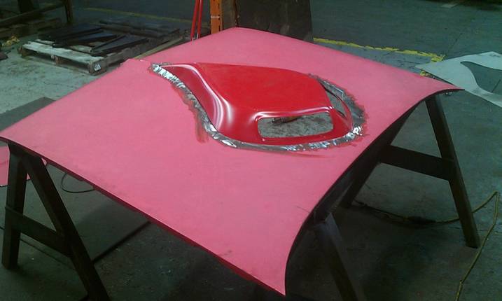

  20. Powerband
    Joined: Nov 10, 2004
    Posts: 542
    Powerband
    I used 2 part SEM panel bond for glas' to steel and screwed down a JC-Witless glas' teardrop scoop on a donated ratty bent hood. F'glas filler and then Rage worked for me. I like the idea if bonding it to bottom, try to show some pics...

  22. KUSTOM 50
    Joined: Sep 20, 2005
    Posts: 250
    KUSTOM 50
    That looks great powerband. I hope mine turns out that good

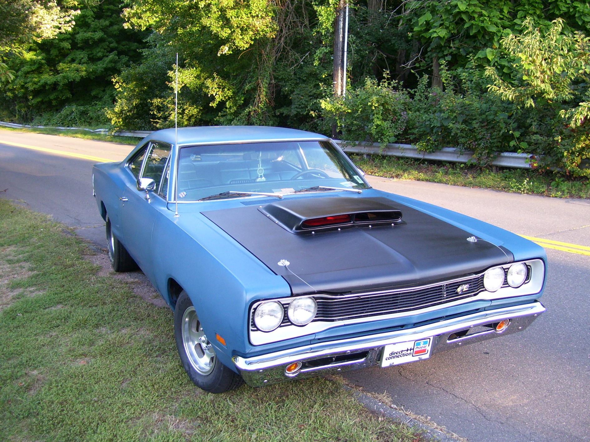

  28. scootrz1
    Joined: Apr 16, 2011
    Posts: 269
    scootrz1
    from usa
    on my superbee i bolted it on with stainless screws ,that was look i was after

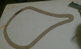

  30. KUSTOM 50
    Posts: 250
    KUSTOM 50
    Ok heres what I did. I made a cardboard template of the outside diameter and trimmed out the middle so that I had the exact shape of the scoop . I traced a pattern out and cut it out in one piece . then done some finale trimming to the inner bracing to fit. check it out so far the scoop is duct taped to the hood in the pic
