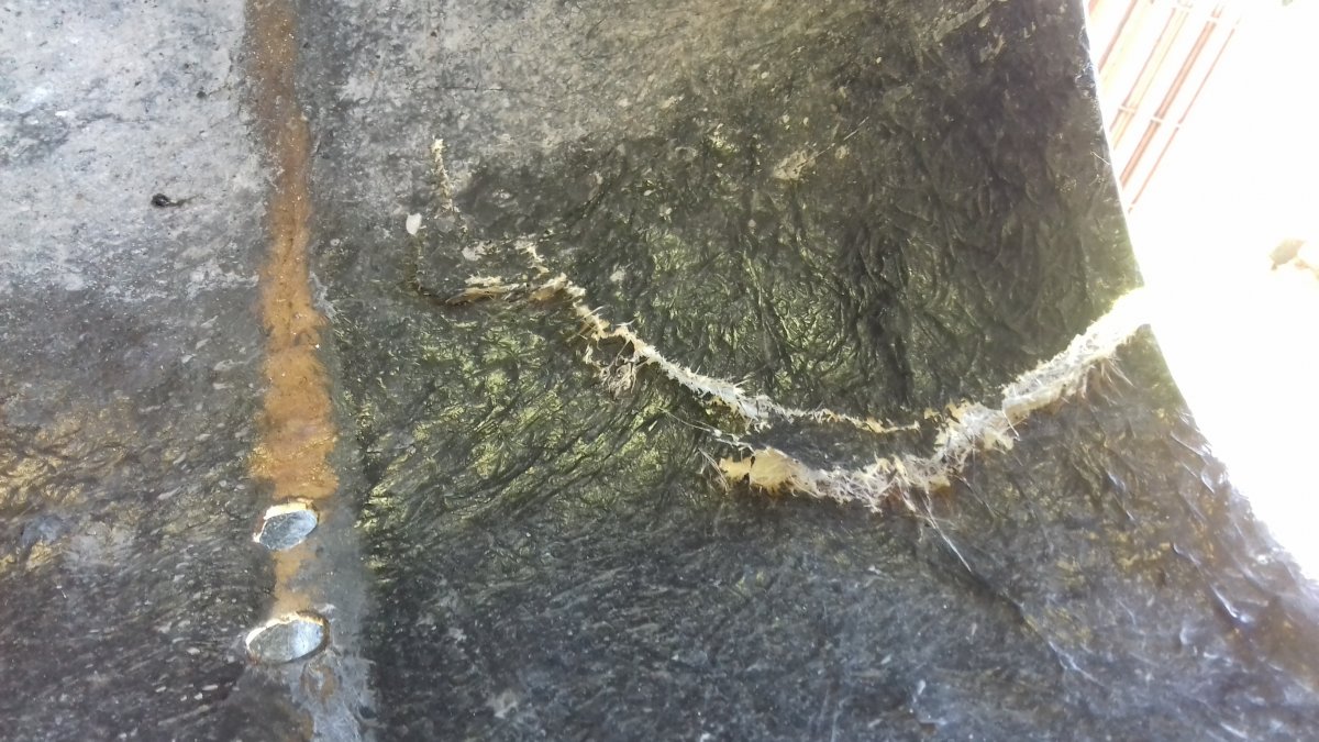

    I am needing some advice on fiberglass repair for my ’32 Ford coupe. One fender has a foot long tear in it. I would like to get it back together without destroying what’s left of the yellow paint. The car has plenty of “survivor” chips, scratches, and flaking paint so this scar will fit right in. If I ever repainted the car I would replace the fender altogether.
    I am estimating the fender was made in the late 60’s-early 70’s time frame. My plan would be to use an epoxy of some sort to bond the tear back together. Then grind some of the underside away and lay some mat over the seam. Does this seem reasonable? What type/brand of epoxy should I use? I have done very little glass repair before, and don’t really plan on doing much ongoing so I don’t want to invest in an epoxy gun. What recommendations do you have? Thanks for all help.

    All the two part adhesives need a gun but you might be able to use fiberglass filler as an adhesive. Prep the part's with a grinder or 80 grit paper until it's dull. Use mixed filler as the adhesive not mixing it to hot then clamp it together with vice grips allowing the excess to come out. Build up the back side with cloth and resin.

    I'd pull it together from the top side as good as possible. tape it up. First a layer of masking type tape for ease of removal, then some duct tape for strength.
    Scuff the bottom side with 80 or so. then brush on resin, add a layer of glass mat (chopped would blend best) followed by 1 or 2 more layers. Then call it good.
    Any glass resin and hardener will be fine for what youre doing. A quart kit will be more than a plenty. itll take maybe 8 ounces

  5. Your plan is basically doable. The way it's torn gives you a natural overlap. Bridging it with a wide strip of mat on the backside is another step in the right direction.
    But I don't hold much hope of eliminating any paint issues. At the very least the epoxy will ooze out and even if you squeegee the excess off, it's going to appear like glue on paint and draw the eye just as much as the crack, if not more. I don't see how you can avoid filling, lots of sanding, and primer...... and possibly color matching as an additional final step.

    I would set up some clamping fixtures first. Have them ready to clamp it. Masking tape to protect the paint, mask just about the whole fender. Have the back side ground or sanded ready to apply matting. Mix up some fiberglass resin, get it in the crack however you desire. Clamp it and let it harden. If you can, apply some resin and mat to the back side before you take off clamps. After that gets hard, take off the clamps and apply more matting to the back. If all went well you can take of the tape from the fender and clean up the resin a bit with some careful grinding. There should be just a line where the crack was.

  11. I would line up the pieces and use painters tape on the paint to "seal up" the crack then use an epoxy like that from the back. THEN do the backside reinforcement with mat and resin. Probably just leave a small line on the front

    What ever you do, You need a bonding strip at least 2" wide the length of the crack, gives an inch each side, doesn't have to be more than 1/8 thick, I have used broke CJ hard top's, you name it in my shop....

    Unless you are looking to do a "farmer repair" you are going to end up damaging the paint around the crack, so you might as well do it right.
    Establish the shape of the fender back where it belongs using 2" x 3" pieces of formed sheet metal to support the fender together and in the correct shape. These are attached to the backside of the fender using self-tappers going in from the top side. Use mold release on these metal strips so you can get 'em off later.
    Then "V" the top of the crack with a grinder going as deep as you can without going completely through. You can mask off the area around the crack so as not to get your filler material any more on the fender than you have to during the course of doing the repair.
    Then use fiberglass resin and matting on the topside of the fender, filling the "V" with resin/matting as required with as much overlap onto the surrounding area as you can. This will get sanded smooth later.
    When the resin/matting on the topside has cured, flip the fender over and remove the self-tappers and the metal strips from the bottom. Using a fiberglass "bonding strip" on the bottom side is a good idea, but you can just use a thick layer of resin/matting on the bottom side of the crack - after V-ing it out like you did on the top - to accomplish the same thing.
    If you put masking tape over the self-tapper holes on the top side you can fill them with resin/matting from the bottom side - or you can use DuraGlass - and they will be good to go when you refinish the fender later on.
    This is essentially how damaged Corvettes are repaired and customized. The metal strips are necessary to hold all the pieces together and in proper alignment. You can't do this with tape and you'll save yourself a lot of time and aggravation later on if you get the pieces in perfect alignment the first time.
    Hope this helps. Good luck!

    I have done and helped others do this type of thing many times. We have found that if you screw a mending plate to the top side, do the glass work on the bottom and then remove the plate and finish the part that shows to whatever degree the owner desires is perfectly permissable.

    This will read more labor intense than it really is but stay with me here...
    1st, and anyone who says different can feel free to shit on me about it, but epoxy based gigs don't play well with polyesters. The older the 'glass is the more likely it'll be to fuck up. I'm not gonna play mad scientist here so take it or leave it, it'll fail either structurally or cosmetically, usually both.
    Ok that's gone. You need some Duraglass (or the equivalent), some regular quality mud/bondo/polyester filler, polyester 'glass resin and mat. Mat is easier to blend in. Grind it out clean 1st top and bottom and get it pulled back where you need it. Mix up some Duraglass and "thin it out" a bit with some resin. You don't need liquid hardener for it just because you added resin. Play with it until works smooth, add your hardener, fill the top lightly as you can but still maintain enough strength to hold it together. Clean out the ooze from the back so it's as out of your way as possible, but again, strength. Let it cure, will be about 10-15 min but overnight will make it harder than the hinges of hell. Rough up the back and 'glass it. I'd recommend about 3 layers minimum and if you can keep it clean enough just let it cure and call it whipped. On top, take down the Duraglass just below your finish level and 'glass a few layers over that too, just enough to execute some decent finishing but still "below grade" so to speak. The textbook move after finishing would be gel coat but we're repairing here, not building. For your 1st build to the finish surface mix a 50/50 blend of regular mud and Duraglass. Again play with it to make it easy to apply and manage for simple finshing. Take it down, a final nice wipe of straight mud, finish, prime and paint. I need to add here, every process will require sanding and grinding after cure for a good mechanical bond throughout.
    There's a theme here, everything is polyester based. It's also going over a polyester substrate so all the components will play nice together for years to come. Again anyone that feels like flickin my nut sack over the avoiding epoxy thing go ahead, but it will fail. If these were SMC you might get away with it but they're not. Good luck, and maybe show us how it comes out.

    Epoxy based products aren't meant to "soak in" like old school polyesters do. When you grind out old stuff like vintage boats and fenders, old 'vettes, etc, those surfaces are pourous enough to suck in the liquid resin and create a nearly chemical bond as well as a stronger mechanical one from grinding. The newer stuff like panel bond won't play either. They grip but they also suck up solvents and then shrink later compromising the mechanical bond. As mentioned above it's a simple gig, a few hrs and some itch, done. Long sleeves and fan behind you goes a long way to managing the misery.
    Modern epoxy formulations have their places and do last longer, have superior strength when applied as engineered. From experience I've never had an epoxy-ish product last on an old 'glass part repair. There's only 1 thing worse than doing 'glass work, and that's doing it twice. The obvious question; if the old polyester parts and repairs are inferior then why is the shit still around? We're here discussing a fender built 50 or 60 years ago. Fuckin junk...:rolleyes:
    quick edit: Just took another look at the damage. Once roughed up top and bottom you can mix up the Duraglass as recommended, thinned with resin, use THAT vs epoxy, tape it together for position and let it cure about an hour. Still take down excess ooze. It'll stick sooner but leave it until it's back to room temp (gets hot when it hardens). Flip it, grind the stuff that came through and glass the backside, maybe 4-5 layers but keep it at least looking like rest of that rough ass surface. Let it cure, rattle can some black, bottom done. Finish the top with Duraglass and bondo. No need for glass work on top. Resin is cheap, a qt of Duraglass is cheap, bondo is cheap. I'm out, but I'd still like to see how ya did.
