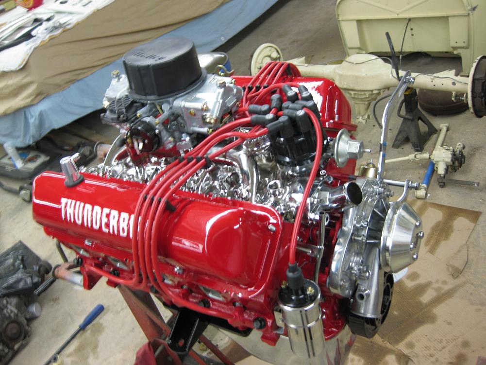

    few shots of the engine i'm wrapping up for my 28 roadster pickup ! computers alittle slow now , will post more pics tommorow ! the truck is undergoing a complete makeover engine assembly is about complete. frame will hopefully be done tomorow and body work is underway ! let me know what you think ! will post more pics of the build soon !

  4. dude that looks really nice, what you got for heads, exhaust ports look a little large!

    they are edelbrock aluminum heads ! i painted them cause i wanted some street camo !
  6. Is that eng going in your rpu? gonna have to run with a few plug wires off till you get used to the power! Hope to see it around this summer, tryin to get my junk ready to roll. The valve covers look sweet as well. Nice work

    ya thats what its goin in to ! should be a handfull , a little differance frpm the 4 cylinder huh !

    were did you get the valve cover adaptors?

    Very nice! Great looking engine. I'm a small block Ford fan, too... Can you tell us more about the valve covers and water pump? What transmission are you going to run?

    had a buddy machine them for me ! but i got the idea from second strike cobra parts ! now let the beatings begin ! haha

    thanks !early fe ford valve covers ! not trying to disguise it as an fe just couldnt find any small block ford valve covers i liked ! had a machinist friend make the adapters allthough i know they are available ! originaly wanted to run an early 260-289 timing cover with the oil fill tube and put the pcv in the intake but after getting the one i found degreased and noticed it was cracked i just pulled holes in the covers for pcv and breather ! waterpump was a must as the chassis is an early chassis engineering set up for a small block chevy ! with alittle haggling the ford fit about perfect as the firewall is recessed but the waterpump was to long , its a snow white shorty conversion using an opel gt pump and machined adapter frees up about 2 inches ! was gonna run an aod but it would have required alot of modification to the crossmember so a built c4 is going in with little work , just had to fab a new mount !
