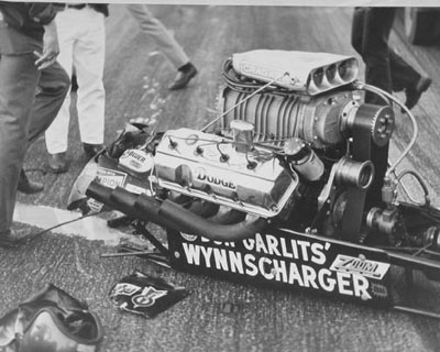

    I found some pics of the Garlits clutch/trans explosion;

    I think it was a drum in an automatic, at least that is what the sign next to the shrapnel at his (Gartlis') museum said.

    as pointed out in an earlier post the Garlits deal involved a two speed transmission. The early two speeds were effectively an overdrive with a band to lock up the planetary and the greatest mass of the gear set spun at high speed. The later two speeds use a clutch pack to lock up the planetary and are underdriven in low and locked up in high, less inertia in the parts that are wizzing around internally.
