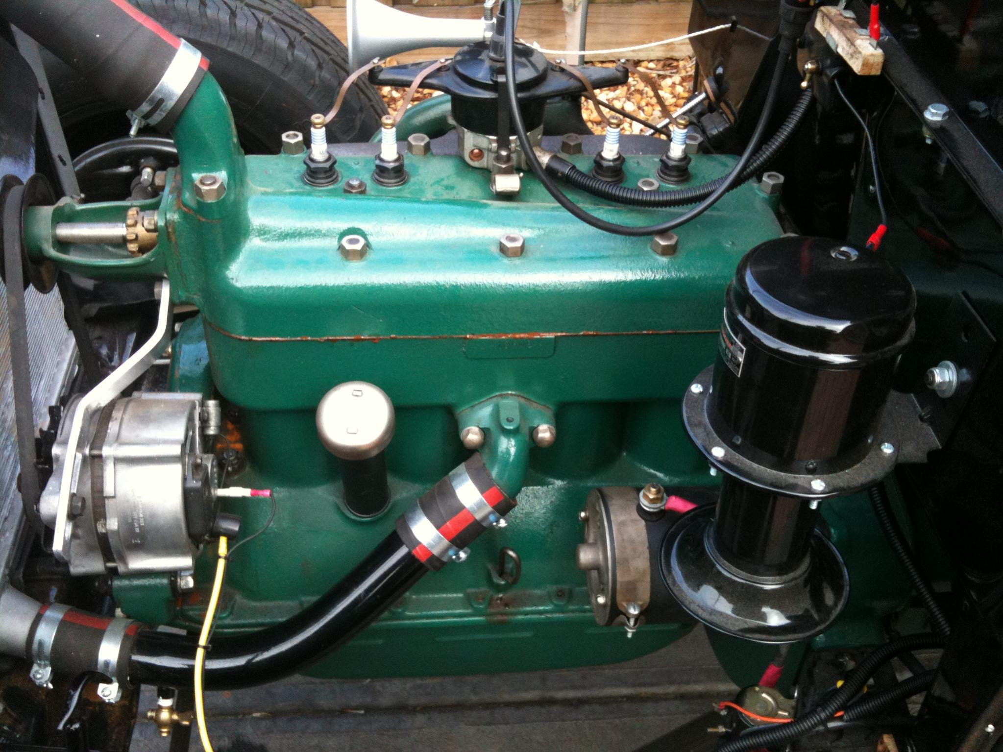

    All this talk about alternator / generator is not the simplest way. He's not running lights.
    Just run everything off the battery and charge the battery at night. Simple wiring. Battery to the starter, wire from battery to on/off switch, wire from switch to coil, wire from coil to distributor. All done!!!!
    I run an alternator and I think it looks as good as a generator.

    Good point, CDO. Is that a Powergen? Also tell me more about that water pump setup.

    thanks for the link. I have a cyclone head and cyclone adapter for the V8 water pump, but it is oriented straight up. Looking at yours I was wondering if a B pump could be used on it with that bolt orientation. I've never compared the 2 to see if bolt spacing is close.

    The B W/P bolt patern is different then the Early V8.
    I modified the adapter by cutting it, clocking it @ 30* and welding it back together. I'm running '32 shell cut down 6". I had to rotate the pump so that the top hose didn't stick up above the radiator.

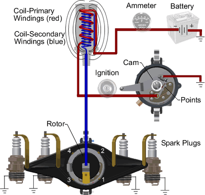

    Did a little more to the tudor this afternoon. I fixed a couple questionable test leads, then checked voltage at key locations (per my Les Andrews Mechanics Handbook Vol 1). At each location, I'm getting the proper 6V....starter block, each side of the coil, and at the points post just prior to the points. Also, I'm getting 6V to the rotor button from the coil.
    Then I put a plug in each plug wire and rested the plug over each hole in the head. Keep in mind, there's no fuel to the cylinders! When I push the starter rod in, the engine turns over, but I get NO spark at the plugs. Does this indicate the points and/or condenser is bad? What else should I be looking for?
  26. Take the cap off and check points gap. Then turn motor over and see if you have spark at the points. If not then change condenser.
  27. Thanks 62! That's where I was headed next! Glad my thinking was working in the right direction. I didn't see a spark at the points with the cap off.....going online for points and condenser set!

    Just disconnect the wire from the condensor and see if you have spark then. That will prove the condensor is bad.
  29. noboD, Which wire? The condenser is bolted in...no wires on the outside. Is there a wire inside that I need to disconnect?
