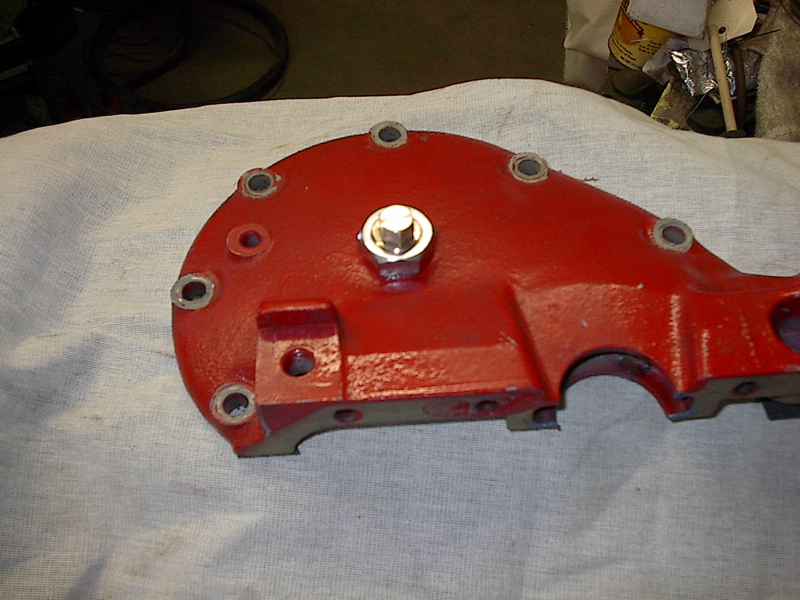

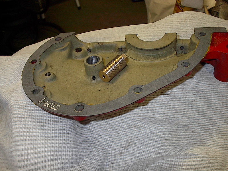

    Changed our timing cover to use a needle bearing cam button. Have one left listed in the classifieds if anyone is interested. Can machine another run if there is enough interest.
  17. I just tap the stock cover 3/4 16 and turn a piece of bronze to fit The clearance or guide tube on inner side of cover is 11/16" which is tap drill size for 3/4 16 so I just extend the hole drilling from rear side and tap from front after facing a small area for locknut to tighten against.
    Of course I have a mill and a lathe. But I don't have any for sale.
    I drill the bronze screw for oil.Also cut a groove to align and collect oil from original hole in cover
    I have a stock cover from a sprint car that has a 3/8" bolt in it. It has been tipped with a drop of braze
