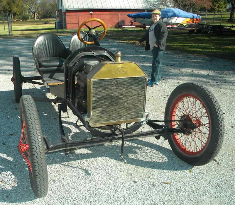

  13. Just joined the banger group, though can't say I'm actually "building one". My '20 T fairground racer was built at least 63 years ago. Seems the latest part on the car is about '38 or '39 -- the hairpins from a Ford tractor.
    I'm adding lights, bulb horn, spare tire/mount to the rear, trunk and perhaps a cowl. Also plan to lower the steering column a little and tilt the wooden bucket seats back a little bit.
    Planning on running 12-volt for the lights -- the typical driver around here is a complete idiot so visibility is kind of important. But I'm keeping the hand-crank -- but no starter or generator -- and will just slow-trickle when needing more juice. The typical generator spot on the block is occupied by an oil pump.
    I've driven the car once and it was more car than I anticipated -- she'll fly!

  14. RussTee
    Joined: Mar 25, 2008
    Posts: 1,241
    RussTee
    Buckelew that looks like a real handful of fun do you plan to use it on the street? Could you give us some more pics and details of parts I see a Rajo Warford Dayton wheels dropped suspension what else a build of that age may have all kinds of goodies?

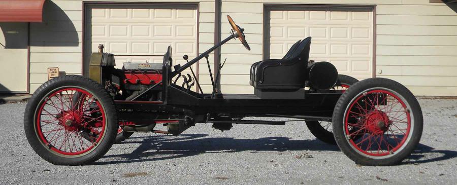

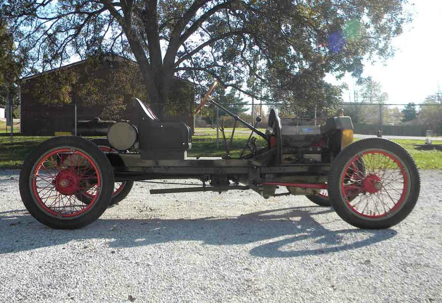

  16. [​IMG]
    Yes this car will be street-driven -- I don't believe in putting it up if it's drivable. The challenge is making it street-legal, but it's coming along.
    The build;
    - Springs behind axles, lowering frame and improving front/back balance
    - 1920 Ford block, drilled crank and full pressure lubrication
    - RAJO Model 'C' OHV head with RAJO intake/exhaust manifold, circa 1925
    - Cast-iron Warford auxiliary transmission, circa 1925
    - Ford Model 'B' carb
    - Bosch magneto from 1930s heavy equipment/tractor
    - Ruxstell transaxle, early 1922
    - Hayes wirewheels, demountable clinchers, early 1920s
    - stock brass radiator, 1913-1915
    - 1913-1915 hogs head
    - Early Stewart speedo, driven by front wheel gear
    - oil pressure gauge
    - full-lubrication with oil pump to top of RAJO head
    - speedster buckboard body
    - stock 1920 frame
    - Ford 2N or 9N tractor hairpins
    - stock steering
