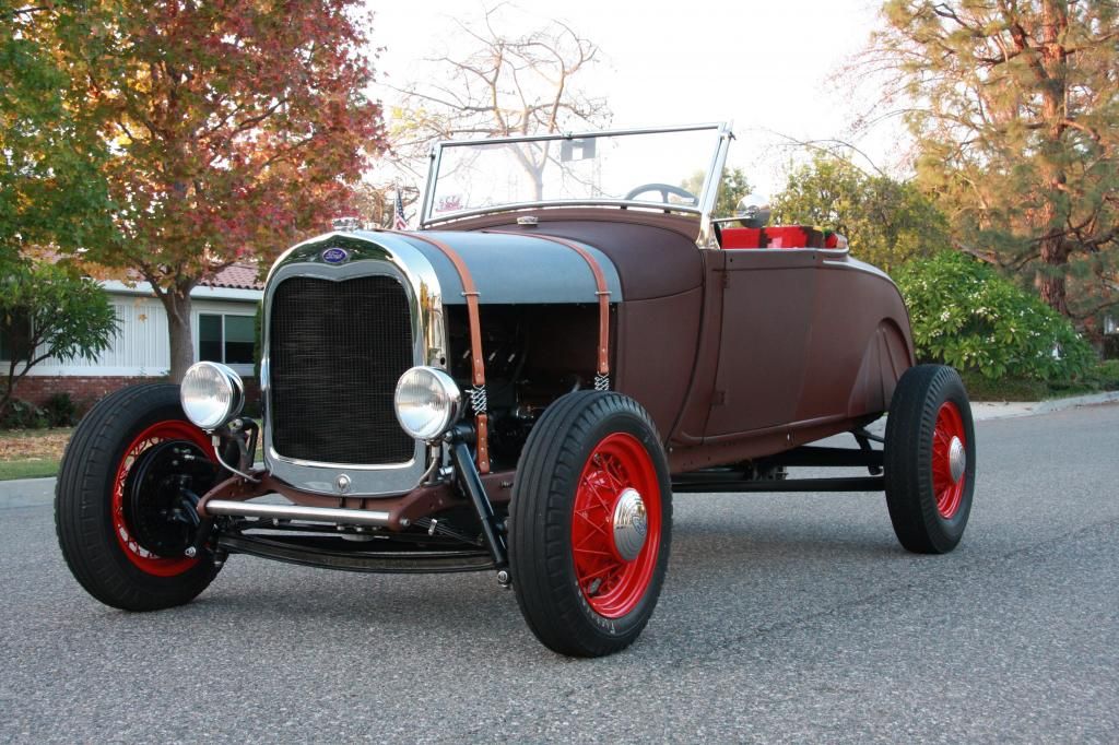

  17. Just joined being a Banger owner!
    28 A with Miller Head with 1.8" Inlet and Exh valves, bored +60, Cross drilled C-crank, insert bearings, Modified Chev 235 oil pump, Magneto, Brierly 280V cam, twin strombergs on unnamed inlet, 4" header
    Very impressed with her power and speed :)

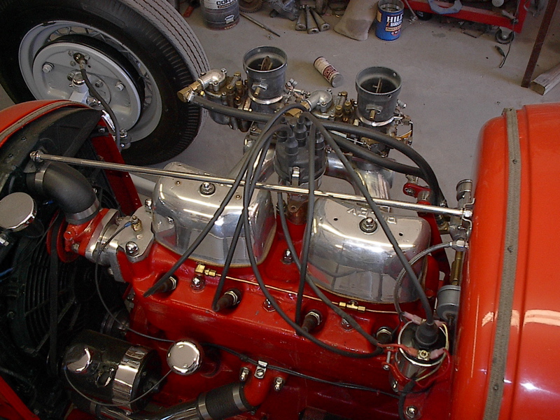

    lazio , you would like my motor ! built by a friend who has many bonneville records .
    jimski .... took .060 off my snyder 5.5 head with no problems .......... steve
