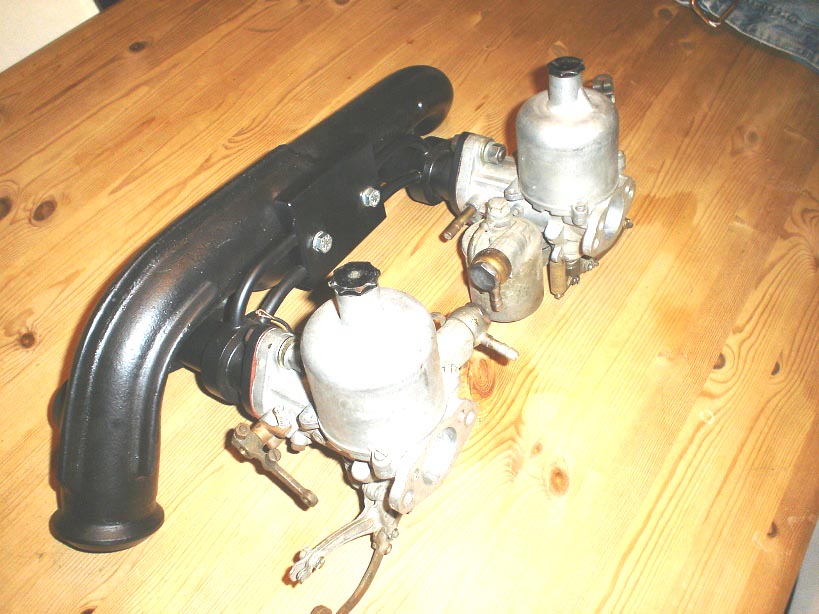

  10. My name is Lars, im pretty new at this, but am in the process of reading all the banger meeting treads.
    Anyway this item just came for sale in Denmark, for about 1200 $
    Kan you pleace help me id it, the seller say its for a model a-Ford.
    Lars

    Lars, have you got any photos from other angles? That really is a nice looking piece.
    Always had a soft-spot for SU carbs...

    Welcome Lars, nice to have You on board. Made Your picture a bit lighter. Don't hesitate to show us Your beautiful Corvette and 4banger.

  22. Ive got another picture from seller, theres no name on the manifold
    Lars

    neat looking piece, but about 1000.00 over priced. A pair of 1.5" HISF S.U.'s shouldn't be more than 200.00 (these are missing all the linkage) and the exhaust manifold, albieght different, doesn't appear to be anything that unique...except straight, which can only be determined unless bolted to the car. My guess is that the exhaust manifold is for a heater application. ok my math isn't the best, but I don't believe that is a really good price.

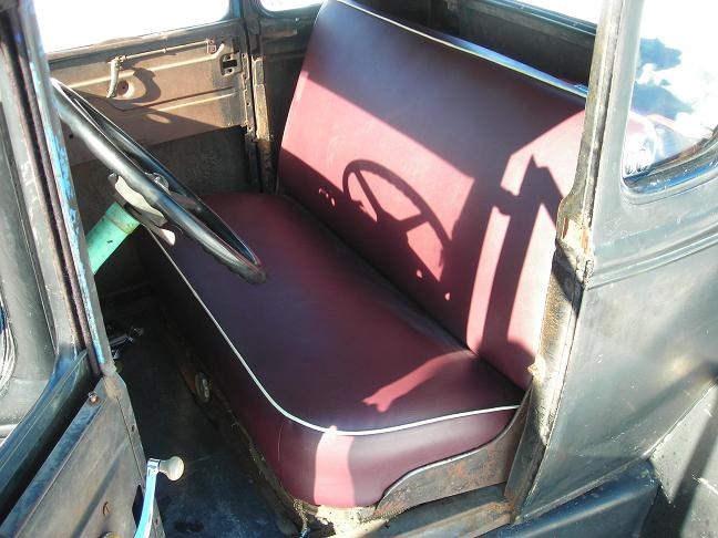

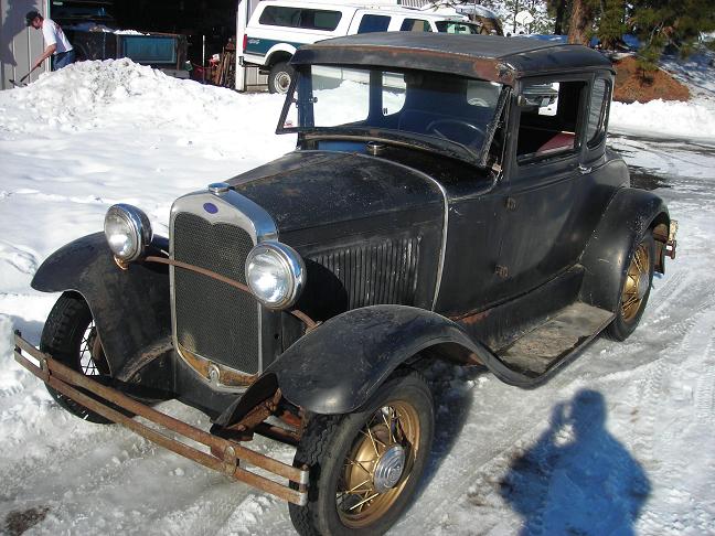

  29. Havn't done much on my engine, got busy here so have not touched my B mill. I did manage to get the A out and drive it around in the snow. It was a nice day yesterday, and after installing new glass and a new seat, decided a jaunt was in order to help keep my sanity :D
