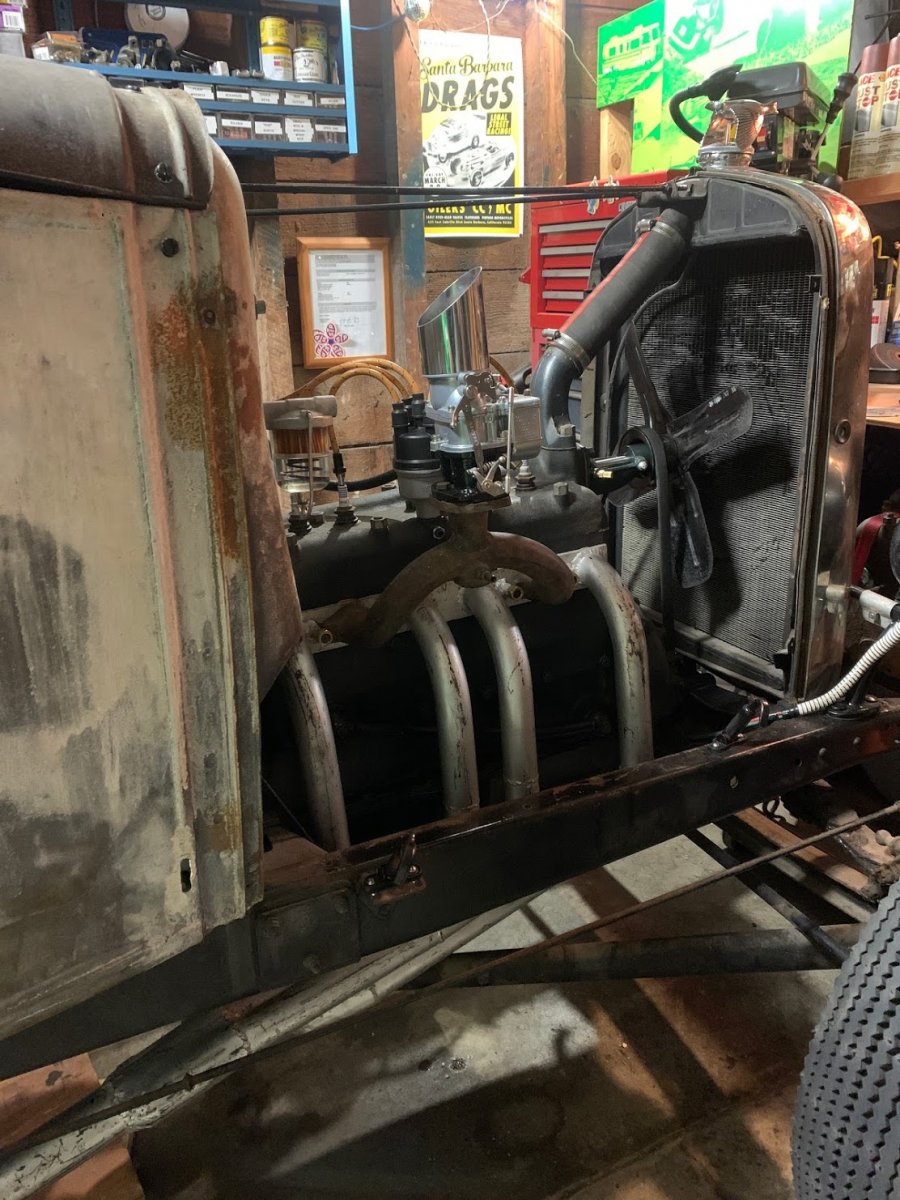

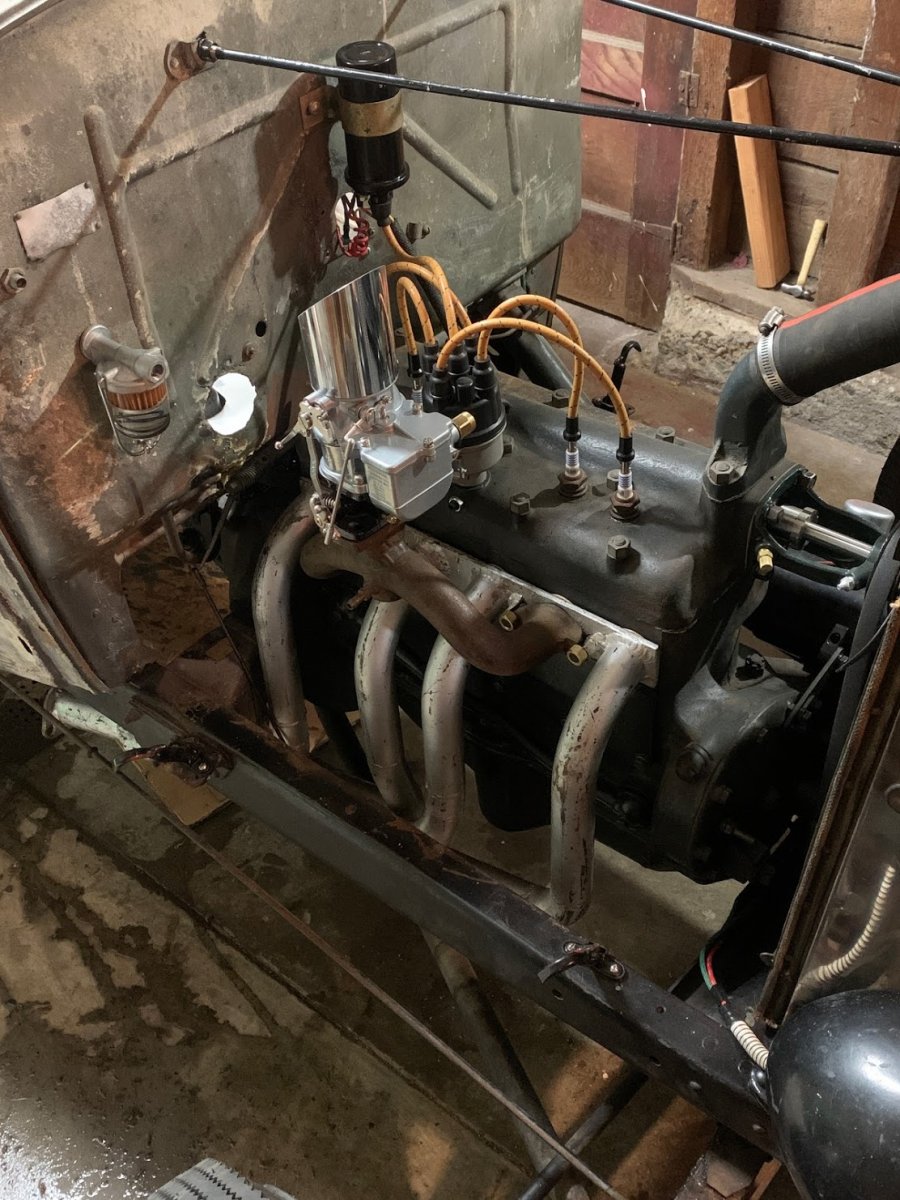

    Checking in from San Francisco with a 'banger question for everyone. Last night's programming included the much-anticipated speed equipment installation on my roadster's engine. Everything seems to fit pretty well, but I realized that the exhaust studs are too short to work with the header. Does anyone have a good source for longer studs? As you can see, they fit the nuts but not the thick washers, which obviously won't fly. Any input would be greatly appreciated!
    One more just 'cuz I'm excited to finally be hopping this thing up!
    (Our garage ceiling leaks when it rains, hence all the water on the floor.)

    Hey J,
    There is a well known long time hobbyist who specializes in selling bolts/ fasteners of any sort that used in our hobby. With my memory leaving me, I cant yhink of his name right now. Maybe this will trigger someone else in chime in with name ?
    Anyway, I have a bos with a lot of V8- 60 head studs. They are shorter than the studs for large flathead studs. Ive used them for this banger intake/exhaust purpose !
    If you cant locate any, let me know. You also know that you need the CUPPED THICK special washers also, eh ? Might have those around also.

    I got longer studs from Burt's in Denver. They had them in stock.

  12. You may be thinking of Roy Nacewicz (Fordbolts.com)
    Unfortunately he passed away, but fortunately Michael Driskell, ThirdGen Automotive picked up the torch and is carrying the lineup. (www.thirdgenauto.com)
    Also @J Ukrop, have you checked Dorman Products? They have a very broad line of double ended studs in all sizes.

    Picked up some longer ones from Brattons i think they were actually head studs i really like that header wish i could measure up need to make one for my db roadster

    I found longer studs locally at my O'reilly's Auto Parts. Search Dorman 7/16 studs. There are quite a few variations so you might need a little time to find what works for you. Note that some have coarse thread on both ends; you want coarse one end and fine on the other.[/QUOTE]

    Red's Headers has the longer manifold stud kits also.

    Thanks everyone for the stud advice. I'm going to do some more research, but great to know that there are viable options out there!

    NAPA auto parts carries them, along with brass nuts

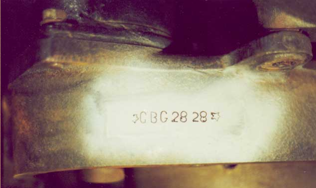

  26. After doing some digging, I found this:
    "A limited number of Model B engines were also built and assembled in East Windsor (Ford City), Ontario. Canadian-produced 1932-34 four cylinder 'engine' serial numbers were actually stamped on the top of the Model B or Model 46 flywheel housing above the starter, and the engine block pad was left unnumbered, similar to US Model B production. The prefix is preceded by a ☆, and the serial number is followed by a closing ☆ character, and reads from the rear of the engine."
