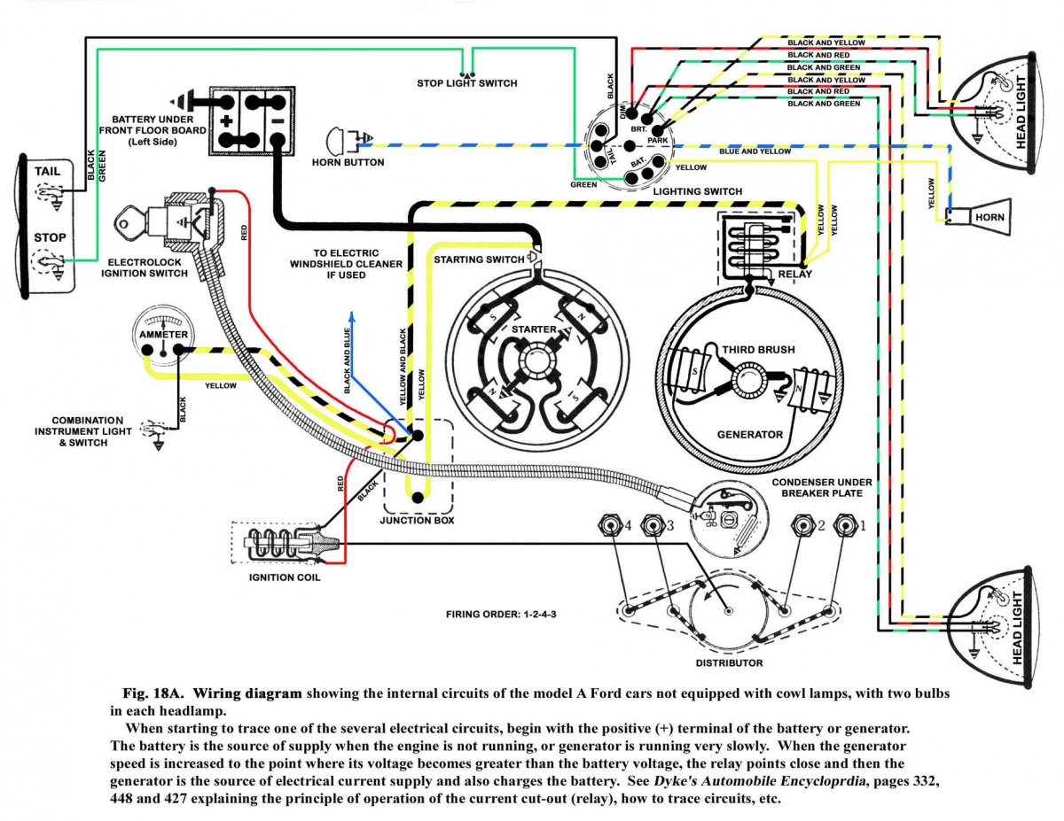

    RTR,
    stock Model A is a positive ground system, check the battery, which post is on the ground strap.
    J

  11. Positive is on the ground strap.

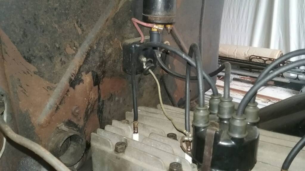

    Your questions are of a fundamental nature and of general knowledge. Most people with average automotive experience know the answers to the questions you are asking. I personally don't like to answer them because I think it is a waste of time. But you are young and maybe a little wet.
    Here are some pictures of one of my cars with a B distributor. See if you can figure it out from here.

    Stock Model A wiring diagram showing positive ground.
