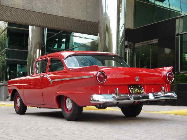

    I picked up a 57 tudor 300 last year at the Round up and in the last year started collecting stuff i needed. Plans are to build a dressed down sleeper... completely stock looking but a smoking screamer under the hood.
    I decided to run with an FE because they they are my less troublesome than the Y-BLOCK(don't get me wrong..I love Y-BLOCKS... but the Fe family seem to have a better dependability factor) They also have a greater range for making some real buildable Horsepower. Saying that....the plan is for a 400-450 good stable street engine to make long distance hauls.I have heard that the FE's are horrible on fuel... so I am up in the air about using a stick...4 speed or TKO 5 speed(with OD) or less $$$ and go with a good C6.
    The stock rear has a factory 3:00 or 3:25 gear(not sure..The body ID tag has the info)
    I have a number of options on inductions.... an Offy 360 intake,a NOS Edelbrock 3x2 intake or recently i have found a guy with a complete 2x4 intake,carbs and cleaners from a 427......(I guess this is a partial question to the interchangeability question)
    I will check the links out guys and get more info.....
    Here is what i wanna build.....but with a killer FE plant under the hood....
    AGAIN!,.... MANY THANKS
    Jeff
