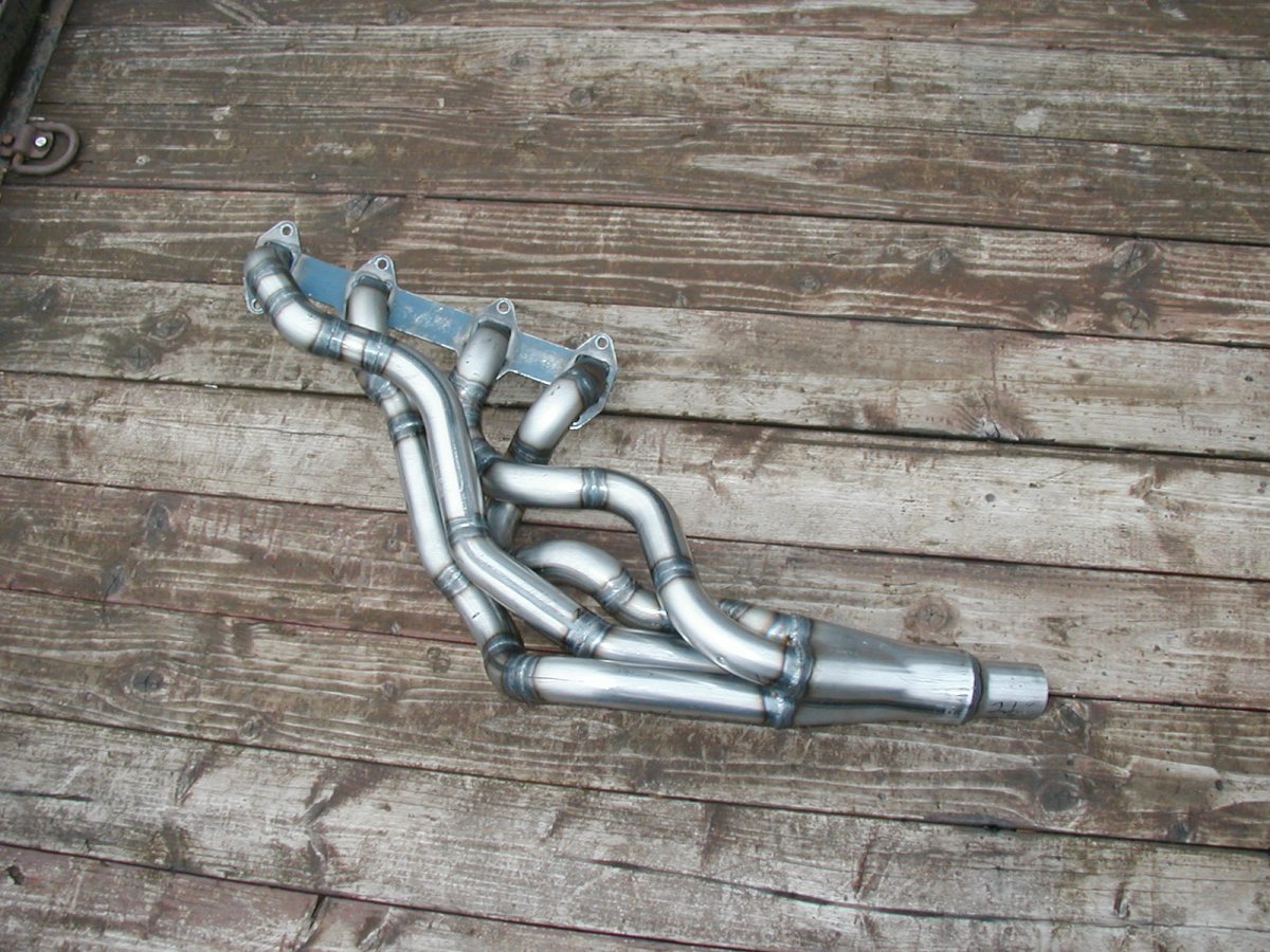

  13. You don't want to use the stock 58-59 on anything with H.P. they choke it up. 1960 was a wider chassis so the rear corner of the Cast manifold no longer needed the step to clear the steering box. The cast shortie header manifold will NOT fit 57-59 Chassis. Crites headers are a Joke but will get the job done more or less. I've heard and tried the Mustang/Cougar headers fit but to this day I haven't been able to make them go in. I ended up building my own because I can but really would have perfered to have bought a good set of quality performance headers but learned they just don't seem to exist, at least if you have Horse Power you want to use.
    The Wizzard

    hi wizard
    holy shit I get dizzy just looking at all those elbows , nice job

  15. Thanks for the nice comment rustymetal and Yes I would like to but sad to say these Old Bones don't get as much done in a day as I'd like to anymore. I have however thought long and hard about taking what I have being they are out of the 57 now and talking to someone about copying each tube and bending them up solo and see where that goes. There is a local shop that has a new style bender that can do that but I have no idea what cost would be. My headers have not yet been coated so cutting them apart is still an option. That way each tube can be handled and copied exact to what I have. My headers clear stock clutch linkage as well as column shift arms and a stock full size starter. It's all about time and money of witch I only seem to have one of at a time. Maybe come spring time, we'll see. The big down side is they will only fit 57-8-9 Ford FE with the 58-59 Bell housing. Pretty limited market. That's why you can't just order a set today.

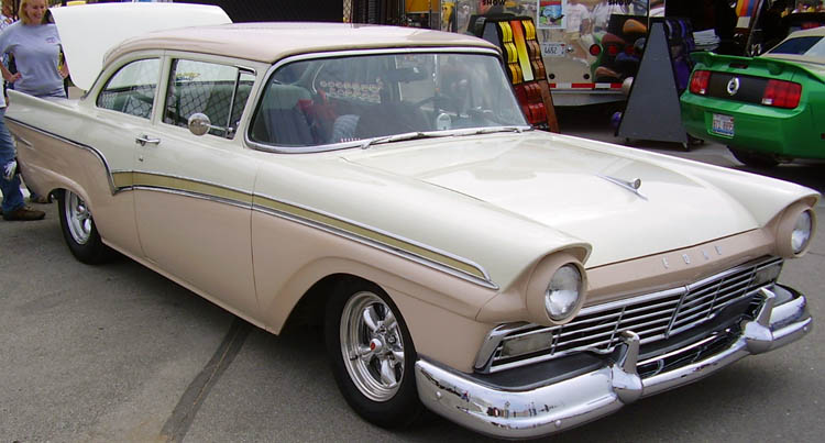

  19. I like your car. I learned to drive on one similar back in 62. Here is a pic of a model I made of it. Doeskin tan and white similar color as yours. It had a 312 / 4bbl and was fast enough for me. UntitledMA29622981-0001.jpg

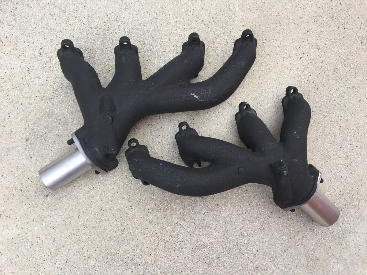

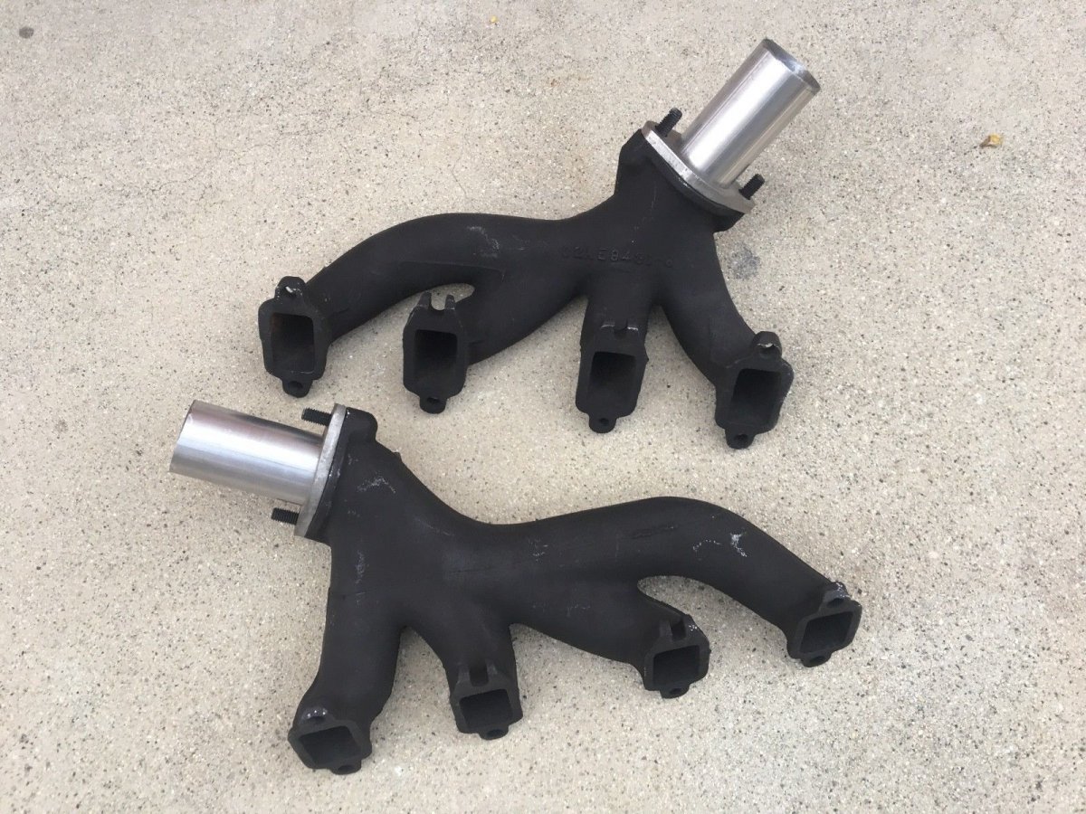

    I picked up a set of stock long tube cast iron headers modified to fit a 1957-59 for my FE 1959. The mounting flanges are cut down at an angle to allow them to fit between the narrower frame rails on the tri-5’s. They were on a 1959 Ford with a 427. I have not put them on yet. Still need to clean them up. The guy I bought them from used them for many years. He mentioned that they are close to the starter and should run a heat shield.

  23. BAD ROD
    Joined: Dec 16, 2004
    Posts: 1,532
    BAD ROD

    Will these clear?
    SPark
    28052704_10204680656374073_488493449_n.jpg 28054096_10204680656254070_1708649913_n.jpg

    SPark, not without modification. Those are what I have. I’m assured they fit with modification (milled angled flanges) which mine have. I haven’t bolted them on yet.
