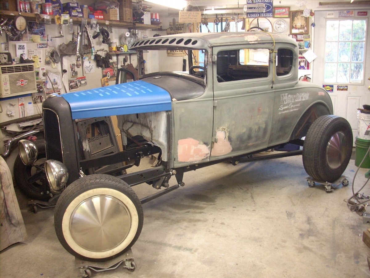

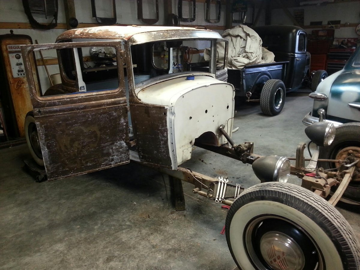

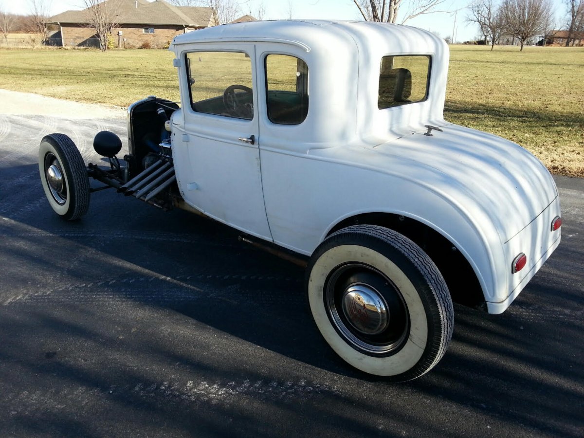

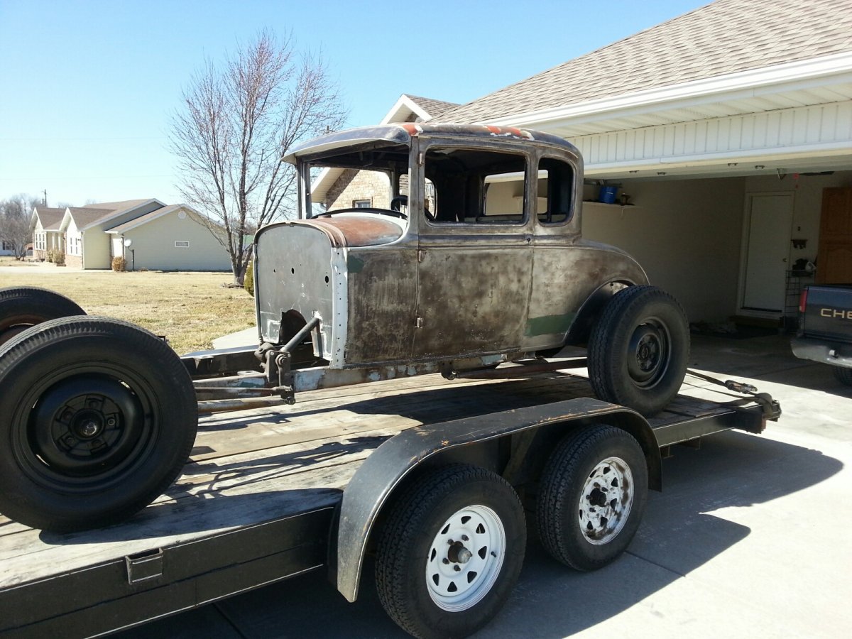

    The car was from Springfield MO.. and was originally done up to look like a rat rod.. and honestly that's not really my thing. So the first thing that happened was basically take everything apart.. body came off, engine came out. It was taken down to a bare roller basically.

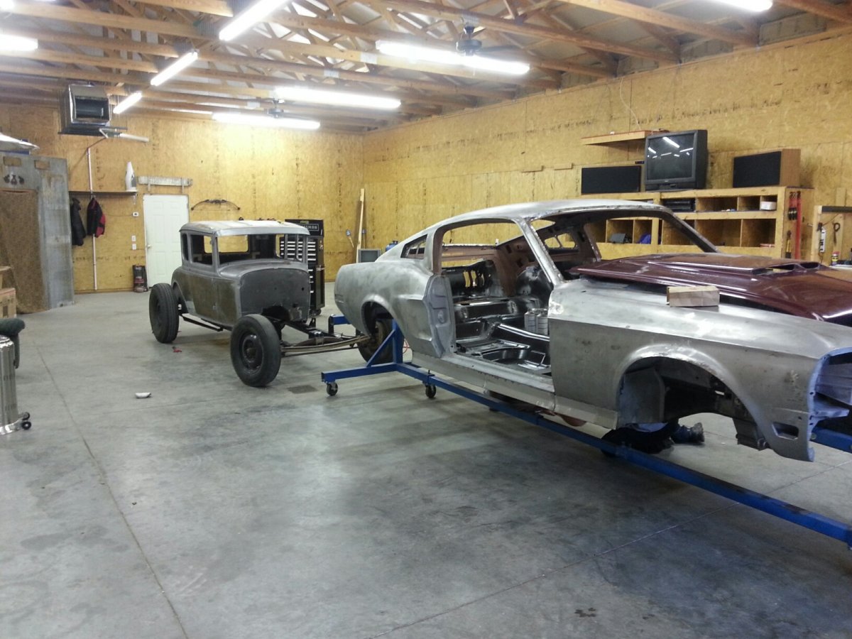

    from Detroit MI
    Picture after the whole car was stripped down to bare metal, all the paint and primer off.
    Stogy and AndersF like this.

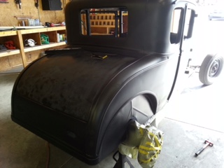

    The car was then re sanded, and all the old steering was removed. Then off came the body. Most of the time spent on the build consisted of sanding and prepping for paint on both the body and frame, as well as the suspension components.

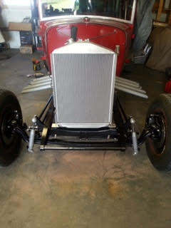

    Because real hot rods have straight axles and the original front axle was so clapped out, a Pete N' Jake's 4' drop axle was put in up front and the back was left as is (previous owner Z'd the frame 6 inches in the back, and re located the fuel tank to under the trunk).

    Also decided to ditch the straight front arms for hairpins, and all the suspension components were painted black to match the rest of the frame.

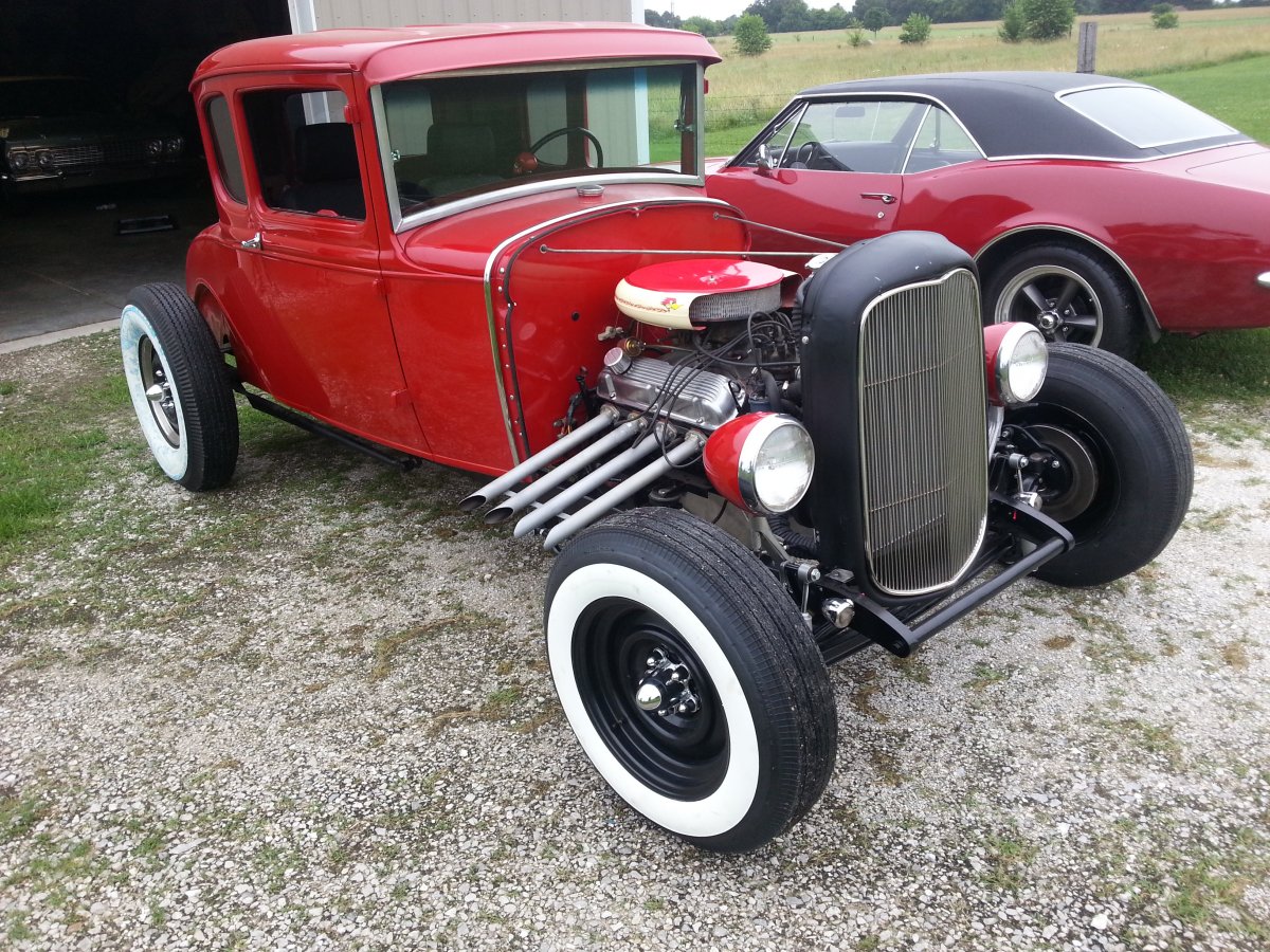

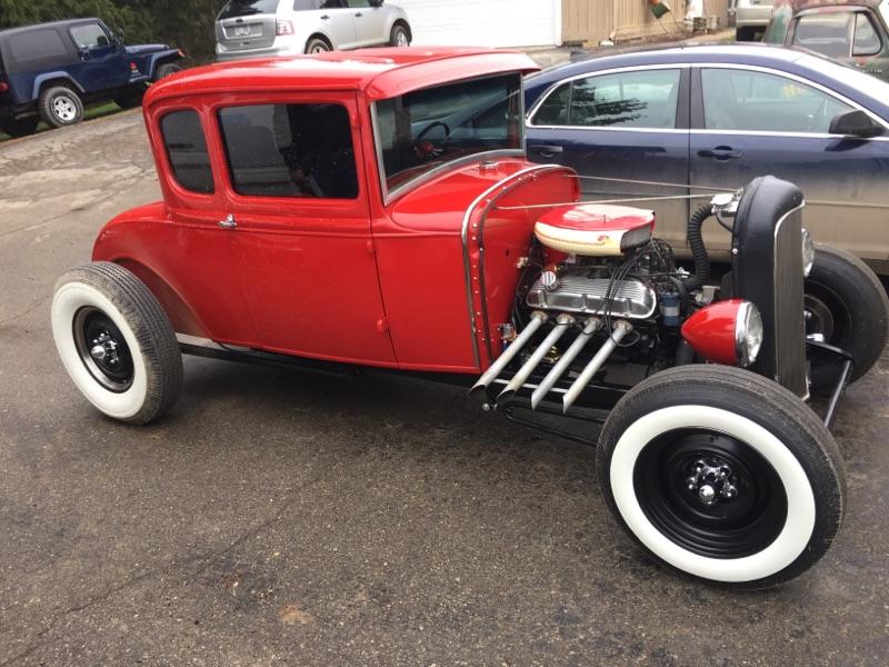

    So here's what the car looked like when we got it It still needs a lot, but it's a good start for us. Went with the Big and Little style. Firestone pie crusts in back, Cokers up front. She needs a new water pump and an oil pan gasket.. but other than that it runs very well with the fresh Ford 289/302 heads, and the C4 trans.

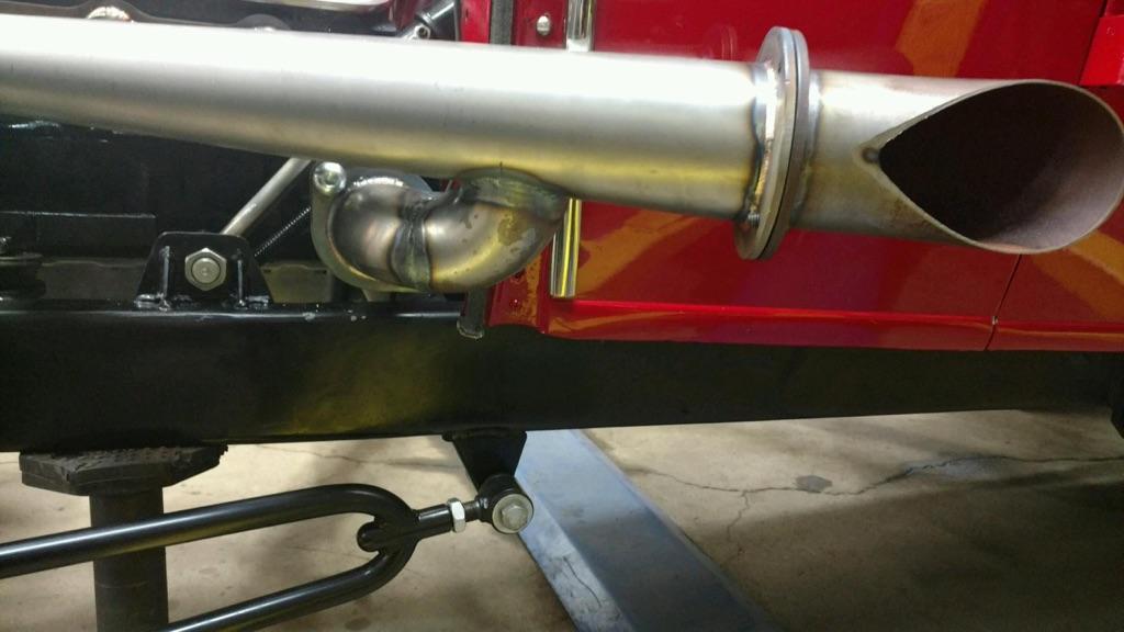

    Now, we only used those headers because it's what came with it. The plan all along was to go with a pair of lake headers. I looked online for some designs, and I drew one up one night and showed my dad. He like what he saw so that's what we went with. This is what I came up with. The metalwork is not mine btw, just the design.
    Nailhead A-V8 likes this.
  20. Jake Sippl
    Joined: Nov 11, 2015
    Posts: 267
    Jake Sippl
    from Detroit MI

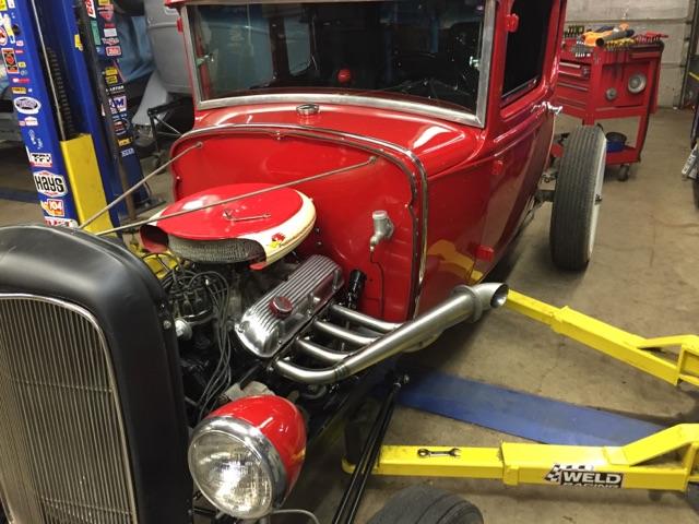

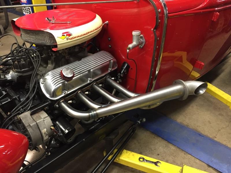

    We went with Smittys glasspacks under the car, with a customized Speedway header kit. Very very happy with this result.
